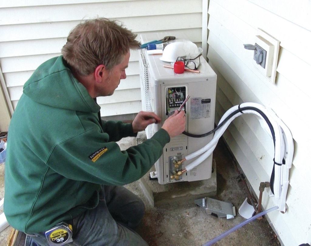

ReVision Energy’s Dave Ragsdale connects the control circuit of the outdoor unit of a 1-ton Fujitsu mini-split on a home near Portland, Maine. In combination with a wood stove, the mini-split will mostly idle the home’s existing oil boiler, except during the coldest part of the year.
