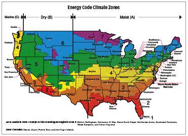

Insulation levels. Required wall insulation R-values have been bumped up in Zones 5 and 6 (see map) from R-19 to R-20 — achievable with a high-density fiberglass batt in a 2×6 wall. But there’s a “13 plus 5” loophole that says you can also meet the requirement with an R-13 high-density batt in a 2×4 wall, plus R-5 continuous insulating sheathing (such as an inch of extruded polystyrene), even though on paper the total R-value of that system would only be R-18 (see charts).
Insulation R-values and window U-factors in the 2009 IECC are based on this climate zone map, which is also used by Energy Star and other model energy codes. On a county-by-county basis, the map divides the country into eight major climate zones based on heating and cooling degree-days, variations in solar radiation, wet-bulb temperature, and other factors that affect local weather conditions. (Zone 8 — not shown — covers much of Alaska.)
Although the 2009 IECC has toughened the R-value requirements for some climate zones (top), it also offers more flexibility than earlier versions. A new U-factor chart (bottom) can be used to calculate total heat loss — or Total UA — through the building envelope (U-factor x area = Total UA), allowing component R-values to be traded off against each other.
