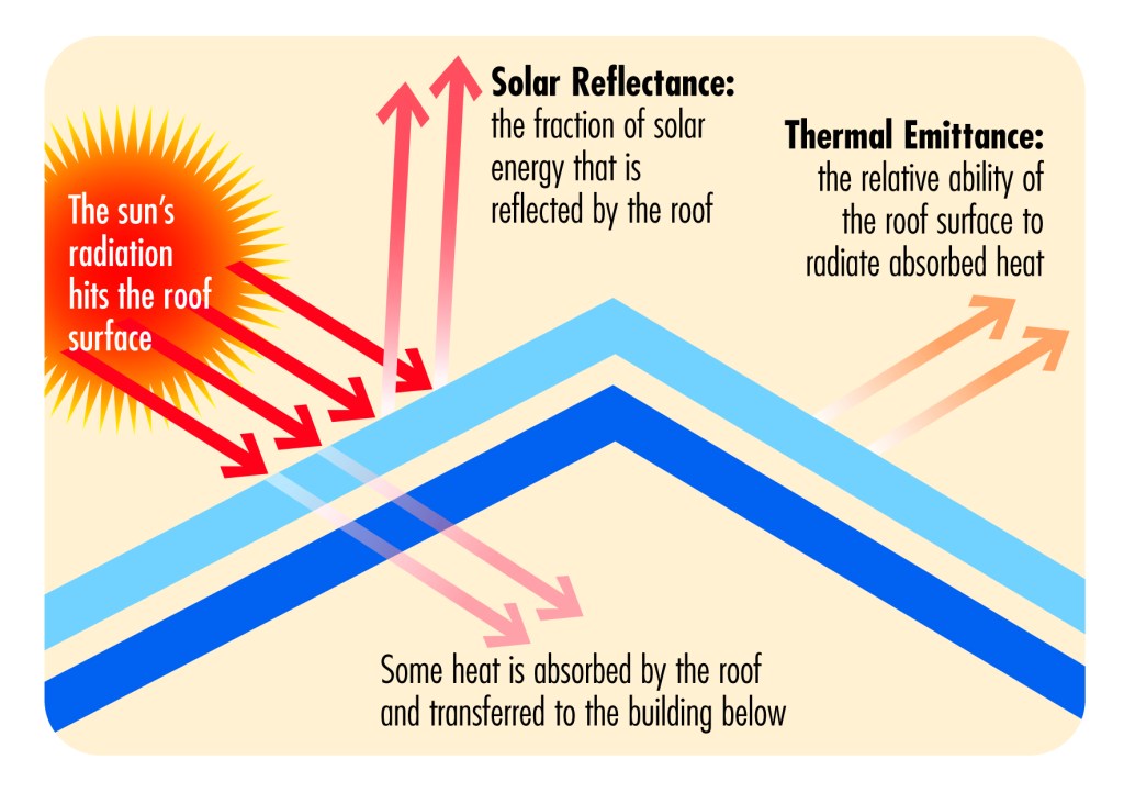

Roof overhangs shade walls and windows. But what about the roof itself? Dark-colored roofing materials absorb solar heat, and that heat is conducted into the roof structure and radiated down through the attic to the ceilings below, adding heat to the house. This problem has been recognized for decades, and in recent years there’s been a move to require reflective roof materials in the sunniest parts of the U.S. There are now a wide range of roofing products on the market that are listed by the Cool Roofs Rating Council based on their Solar Reflectance Index (SRI).
How does the SRI work? Roofing materials are characterized by their reflectance and by their emittance. Solar energy striking a roof is either reflected or absorbed; if it’s absorbed, it may still be re-emitted to the sky as infrared energy. Reflectance is expressed as a number between zero and one (or as a percent between 0% and 100%). Emittance is expressed the same way — either on a scale from zero to one, or on a scale from 0% to 100%.
The balance of absorption, reflectance, and emittance results in a temperature rise for a material that’s exposed to sunlight. That combined process is expressed in the “Solar Reflectance Index.” Lawrence Berkeley National Laboratory explains:
“The Solar Reflectance Index (SRI) is a measure of the roof’s ability to reject solar heat, as shown by a small temperature rise. It is defined so that a standard black (reflectance 0.05, emittance 0.90) is 0 and a standard white (reflectance 0.80, emittance 0.90) is 100. For example, the standard black has a temperature rise of 90°F (50°C) in full sun, and the standard white has a temperature rise of 14.6°F (8.1°C). Once the maximum temperature rise of a given material has been computed, the SRI can be computed by interpolating between the values for white and black. Materials with the highest SRI values are the coolest choices for roofing. Due to the way SRI is defined, particularly hot materials can even take slightly negative values, and particularly cool materials can even exceed 100.”
