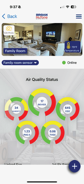

For all these reasons, I was intrigued by the Broan Overture system and installed one in a new house I completed about two years ago, so I’ve had a chance to see how it works. In short, I wouldn’t want to control indoor ventilation any other way. I think builders and homeowners will love it because it automatically makes ventilation decisions based on a home’s real indoor air quality. Once set up, it requires no interaction.

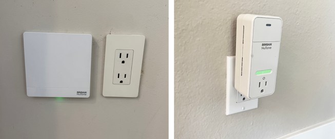

The Broan Overture ventilation control system uses sensors to monitor indoor pollutant levels and ramp up or turn on and off connected ventilation fans to keep pollutant levels at or below threshold levels. The author placed hardwired sensors (left) throughout the living areas and bedrooms. Broan also makes a plugin sensor (right) that can easily be retrofit in existing outlets.
For energy recovery, I selected a Broan AI Series energy recovery ventilator (ERV). On a recent day with 110°F outside temperature, it tempered the incoming fresh air to 81°F, so it recovered most of the energy I spent to cool the home.
Typically when you set up an ERV, you have to spend a lot of time fiddling with it to balance the exhaust and supply airstreams. But this Broan unit is “self-balancing.” It takes airflow measurements two times per second and automatically balances supply and exhaust airflow, making it much easier to set up as well as provide balanced air if conditions change (like a dirty filter).

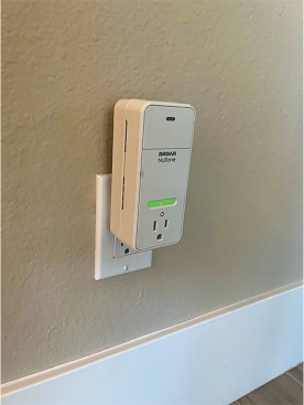

However, the game-changer for me is the variety of control options the Overture system has when paired with my ERV. This system includes a number of room sensors—ones that hardwire into a two-gang electrical box or others that plug in to an existing wall outlet. The plug-in version is what you would use if you were retrofitting an existing home.

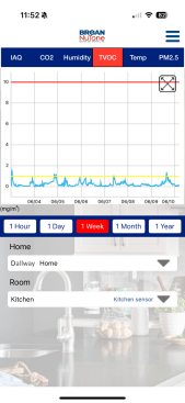

The sensors monitor indoor relative humidity, total volatile organic compounds (TVOCs), carbon dioxide (CO2), indoor temperatures, and particulate matter with a diameter of 2.5 micrometers or less (PM 2.5; a micron is 1 millionth of a meter). These tiny particles are of concern because they can move from the alveoli deep in lung tissue into the bloodstream. The sensors have LED indicators that glow green, yellow, or red to allow homeowners to understand current IAQ levels at a glance. The LED brightness is user-programmable from 100% intensity all the way down to “off.” (When I compared the Overture CO2 levels with my $175 Aranet 4 CO2 sensor, they were within 50 ppm.)

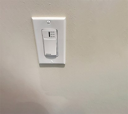

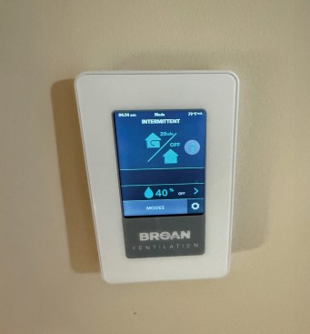

We placed the room sensors throughout the common areas of the home, as well as in bedrooms. We located them on interior walls and not in direct sunlight (the rationale is similar to how you would locate a thermostat). The kitchen range hood can also be wired to come on automatically when someone starts cooking, and there are manual timer controls in the bathrooms for local exhaust fans. The system can be set up to run in different modes: continuously or intermittently at a baseline level to meet code, or in smart mode so it will respond to the actual conditions within the home.
In smart mode, when a room sensor detects a rise in indoor concentrations of pollutants above predetermined thresholds, the system automatically activates the ERV or other connected devices, such as bath fans or the range hood in the vicinity of the activated sensor. I set mine up to run only the ERV. You can also set the system up to run intermittently to the desired minutes per hour or continuously. It even has a turbo mode to boost ventilation levels in the event of an unscheduled cooking calamity.

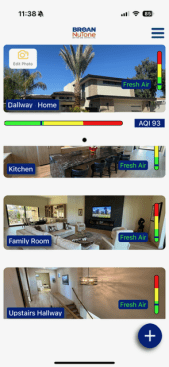

The system can also be managed through a mobile app that allows the occupants to view air-quality data in real time, track historical trends, and adjust system settings as needed. The system takes into account the outdoor air quality using the Air Quality Index (AQI; see airnow.gov) and will temporarily pause the air intake if outdoor conditions are poor, which seems to occur all too frequently during wildfire season these days.
