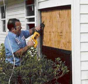

Cut to the chase. If the front of the fireplace is faced with brick, tile, or some other finish that was applied after the unit was originally installed, we prefer to come in from behind so we don't have to tear the fireplace surround apart and rebuild it when we're done. That often means cutting through the outside wall of the chase (Figure 3). If the fireplace is built into an inside wall, it's usually possible to cut away the drywall and framing on the other side of the wall.
Figure 3.Removing a fireplace from the back eliminates the need to dismantle and later rebuild the existing interior finish. An opening in the exterior chase provides the working space necessary to disconnect the flue and remove the fastenings that hold the old fireplace to the framing (top). The unit can then be pushed back into the chase and out the access hole (bottom).
