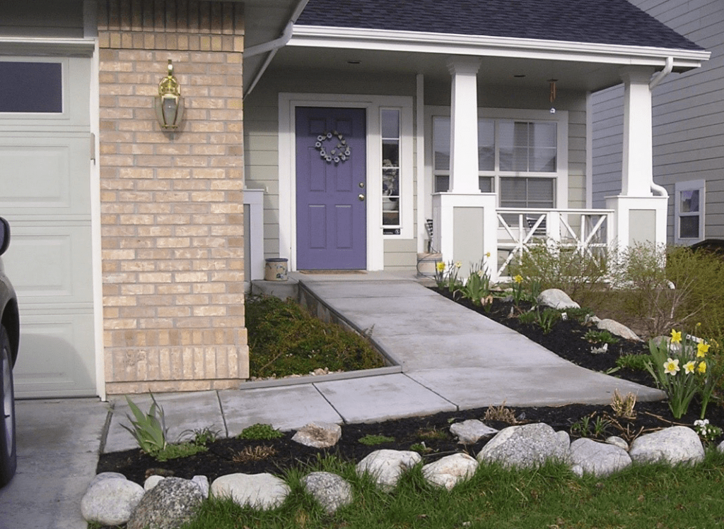

Walkway to the Entry Doors
Walk with a friend side-by-side and measure how much room you need. You will be surprised and wonder why most walkways are between 24 to 36 inches. Be careful to make these surfaces smooth. How smooth? If your grocery store shopping cart will stop when a wheel hits a tiny pebble, imagine what it is like for a wheelchair. Make the walkway smooth and free of bumps. Right-angle corners on a walkway can add a challenge; we suggest curving the corners or widening areas around the corner.
If the walkways are long, suggest creating rest areas off to one side. If the house is in an area with freezing temperatures, we recommend heated walkways or portions of a driveway. Snow and ice-melt systems must be designed and installed by experts who understand your climate. Lighting should be added using automatic motion-sensor switches, timers, or light sensing devices with LED lights.

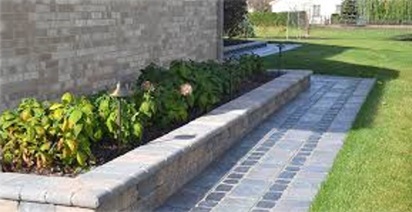

Walkways Around the House
Everyone should be able to walk around their home without falling over. Use the same method we used for walkways to the doors to decide the width of each walkway. The same rules apply that we used above in the driveway, walkways to entry doors and steps.

Gardens
Raised garden and flower beds can be attractive and easier to reach for someone with a stiff back or sitting in a chair while tending to their crops (let along keeping pesky rabbits from munching on prized vegetables or fruit).

Ramps, when installed by professionals, look seamless as good design. If a ramp is installed, recommend no more slope than 1 inch rise for 18 inches of length. An alternative to ramps is sometimes a sloping walkway. For all these, be sure there is proper lighting, rest areas and turn areas about six feet by six feet.
