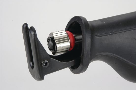

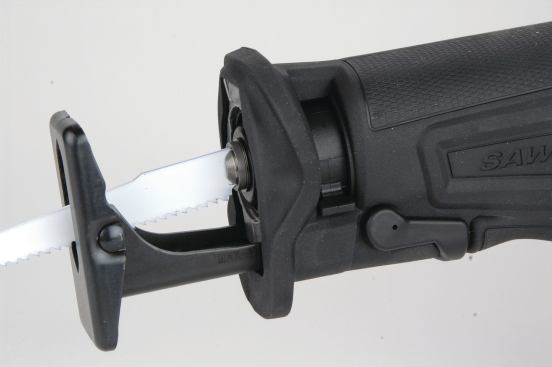

The adjustable shoe of the Metabo locks in place with two set sc…

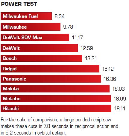

When testing the saws, I rated their performance in two ways (see charts at right). To rate power, I timed how long it took each saw to cut through a doubled 2×6. And to rate runtime, I counted the number of times each saw cut through a doubled 2×6 on a single battery charge. (Before every test, I put a new blade in each saw.)

1. Heavy-duty saws could take as much force as I could apply, without stalling or bogging down dramatically, so pushing harder generally resulted in faster cutting. These tools cut the quickest and were the least temperamental and therefore shaped the category I preferred overall. The dogged performance of the four Milwaukee and DeWalt tools earned them each a place in this category.
2. Medium-duty saws had a limiting pace that they couldn’t be coaxed out of, but at least they acted predictably. Pushing harder didn’t make them cut faster, but it didn’t slow them down much, either. Though they make you wait longer for the results, they get the job done, so one of these saws may be all that’s needed for average tasks. Saws by Bosch, Hitachi, and Panasonic made the cut for this category.
3. Light-duty saws are more trying to use because when you push harder, motor speeds (and already conservative cutting speed) drop dramatically, and they stall frequently. These tools actually perform better if you let up on the pressure, but I find it difficult to use a saw that I have to baby while trying get the job done. The Makita, Metabo, and Ridgid saws fell into this category.
