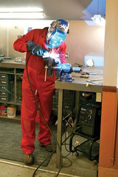

Even though I’m a carpenter who loves working with wood, I’ve found that my welding equipment is as useful as many of my woodworking tools. With the right welder and a few basic metal-working tools, I can quickly make repairs to broken equipment or fabricate useful accessories. I don’t make critical structural welds on building projects, though; for that I call on a certified welder.

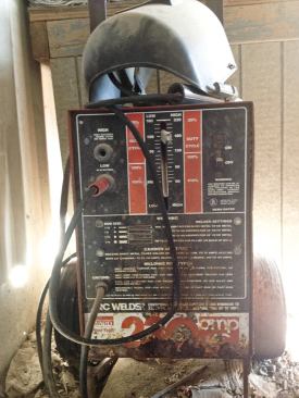

I still have the 230-amp stick welder I purchased from a Montgomery Ward catalog some 30-plus years ago, which I use primarily when working with 3/8-inch or thicker metal. It works fine but isn’t very fast, because I have to constantly replace the electrode. Plus the slag has to be chipped away before the welded area can be painted.

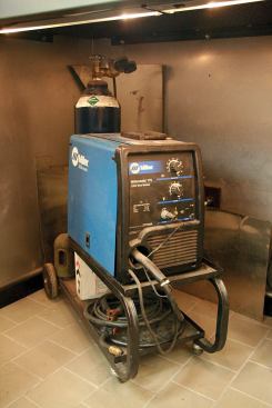

Wire welders. A few years ago I bought a Millermatic 175 220-volt continuous wire-feed MIG welder, paying about $1,000 for the outfit (920/734-9821, millerwelds.com). If I could own just one welder, this would be the one, because with it I can weld metals ranging in thickness from 22 gauge to 1/4 inch (the most common material thicknesses I work with) in a single pass.
Instead of an electrode rod, my MIG welder has a gun that feeds solid steel wire through an electrically charged contact tip. When I pull the trigger, the hot tip melts the wire, creating a weld puddle. The amp setting and wire feed rate are adjustable, and vary according to the thickness of the material being welded. A handy chart printed on the inside of the welder’s access door shows these settings for different thicknesses of metal.
My welder is also equipped with a pressurized tank filled with an inert gas (typically 75 percent argon and 25 percent carbon dioxide – MIG stands for “metal inert gas”). When I pull the trigger to start the wire feed, gas flows out of the gun into the weld area to shield the weld puddle from atmospheric contamination. It costs about $200 to equip the welder with the optional tank, and about $30 to refill the tank.
The 175 has a duty cycle – the amount of time during a 10-minute period that a welder can operate at a given amperage without overheating – of 130A at 30 percent. This means I can weld for three minutes at 130 amps. By comparison, the less-expensive 115-volt Millermatic 135 has a duty cycle of 90A at 20 percent, but it requires only a conventional 110-volt outlet. In the seven years I’ve owned my Millermatic 175, the safety shut-off has engaged due to overheating only once (though this is partly because I seldom weld nonstop for long periods of time).
