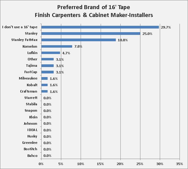

A few months back we ran a survey asking newsletter recipients to tell us about their favorite hands tools—specifically, their brand preference for 16’ tapes, 25-30’ tapes, screwdrivers, adjustable wrenches, lineman’s pliers, and pump pliers. The tables below contain the combined responses of cabinet maker/installers and finish carpenters. I put these trades together to create a larger sample and because there is a fair amount of overlap in the kind of work they perform. Between the two trades we received 65 responses.
Be sure to check out the links to the responses from other trades and the comments pulled from the surveys. Both can be found at the bottom of this page.
About the same proportion (29.7%) of finish carpenters/cabinet maker-installers do not use 16’ tapes as remodelers (30.5%) and GC’s doing new construction (29.4%). It’s surprising that the numbers are so close for these groups; I would have thought cabinet makers would drive the proportion down because the sheet materials used to build cabinets are rarely more than 10 or 12 feet long. People who self-identify as handymen are the most likely to use shorter tapes; only 20.7% say they don’t use 16’ tapes.
I wouldn’t make too much of the lowest numbers in the chart above, because with a sample size of 65 people 1.6% means one person prefers that particular brand.
