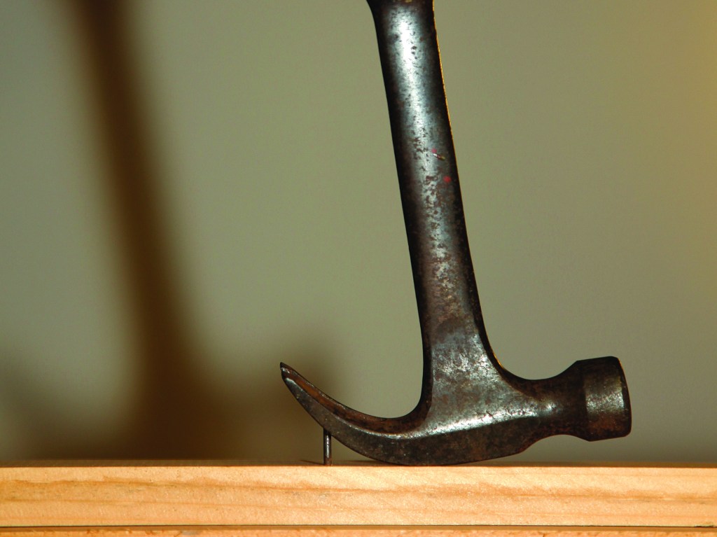

Used mainly for finish work, curved-claw hammers excel at withdrawing nails without marring the surface of the wood.

Curved-claw hammers do have some advantages over straight-claw hammers. For one, curved-claw finish hammers weigh less than straight-claw framing hammers: typically 16 ounces as opposed to 20 ounces or more. Also, a curved claw lets you pull a nail with minimum damage to the board—a plus for finish carpentry (see photo, below). Finally, curved-claw hammers don’t have the “accidental scar” potential that a straight claw has. Think about backing into a cabinet with your tool belt on: Would you rather have a curved surface or the end of a straight claw touch the cab?
