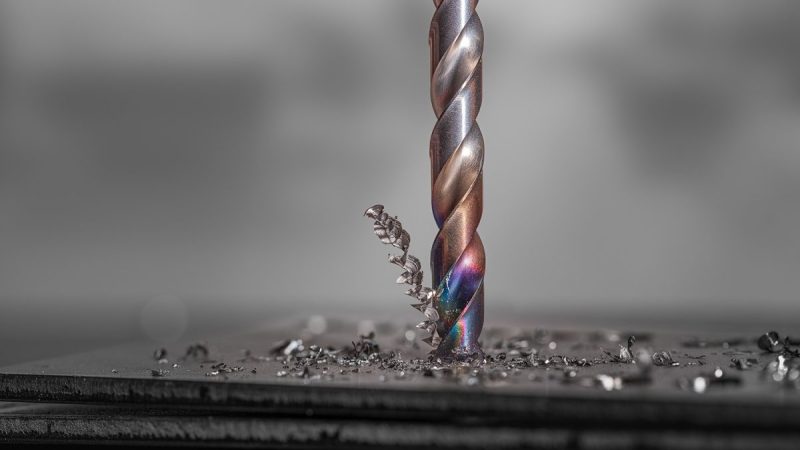

Cutting Instead of Grinding
Traditional metal bits can generate substantial friction as they work through the material. The resulting heat can dull the cutting edges, damage the coating, and quickly drain a cordless drill battery.
Newer cutting geometries remove material more efficiently rather than simply rubbing or grinding against it. Enhanced flute designs evacuate chips from the hole before they accumulate around the cutting edge, helping reduce drilling time and heat buildup.

Chip formation provides a useful visual guide. Fine dust rather than chips may indicate that the bit is grinding instead of cutting. Blue chips can signal excessive heat. Ideally, the bit should produce defined chips that travel up and out through the flutes.
