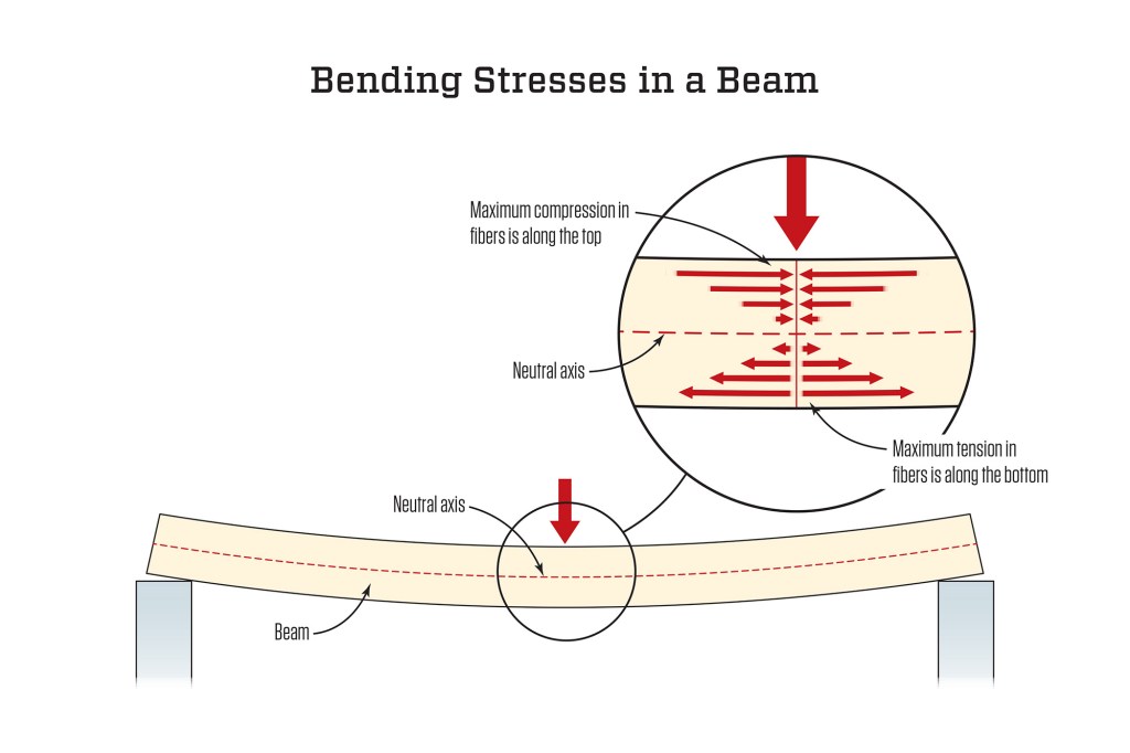

When a beam bends, the fibers along the top edge are squeezed, or compressed, together. At the center of the beam, the direction of stress reverses. Below this, the fibers are stretched, and the distance they are stretched reaches a maximum tension stress along the bottom edge. At the point where the bending stresses reverse direction, the longitudinal stress is zero. This point lies along the neutral axis of the beam, which lies at the center of gravity.

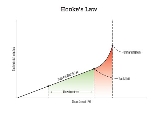

Strain. Beams are not held in perfect static equilibrium. They move. (Remember that tiny, tiny movement that shortens the cathedral tower?) The amount of that movement is strain—the measure of deformation that occurs in a material under stress. For the fibers along a beam, which is subject to a load pushing straight down, the strain is defined mathematically as the change in length (after the beam is squeezed at the top or stretched at the bottom) divided by the original distance (the length of the beam before applying a load).
Hooke’s brilliance was that he related stress and strain, articulating what is known as Hooke’s law: For every stress, there is a proportional strain. Or, put another way, the amount of deformation of an elastic material is proportional to the stress applied to it.
Hooke was thinking in terms of whole structures and his theories didn’t always hold up perfectly to testing. But a couple of hundred years after Hooke, the English physicist Thomas Young took the concept further to arrive at a method of calculating the ratio of stress to strain at a given cross section through any material. (In a wood beam, this cross section is a rectangle.) His formula, Stress/Strain = E, is known as Young’s modulus, or the modulus of elasticity (“modulus” means “ratio”).
If you plot stress to strain on a graph (see below), the values form a straight line in the region where Hooke’s law applies (where they are directly proportional and the material remains elastic). The material remains elastic so long as it returns to its original shape when the stress is removed (strain = 0). This region where Hooke’s law applies is commonly referred to as the allowable stress, since no permanent deformation occurs. For example, the beam supporting a floor might deflect when you walk across it, but it doesn’t remain in a sagging position when your weight is removed.
As stress increases, a material reaches its elastic limit. This is above the allowable stress and overloads the beam. As the stress increases above this limit, the strain increases at a geometrically greater rate relative to the stress. This pushes the fibers in the beam beyond their ability to recover their original shape, and the deformation becomes permanent (for example, the sag remains). If the stress increases even more, the material reaches a point where it reaches ultimate strength—the point where strain increases without limit: The beam breaks.
