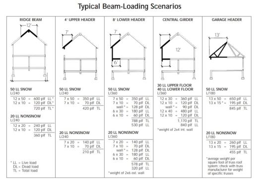

The five applications and spans that I have selected as examples of beams and headers are arbitrary but common ones (see illustration).

First, I worked out the uniform loads for each of the beams, following the procedure outlined in last month’s article. If you don’t follow the calculations, review that column. I’ve included calculations for two loading conditions. One design assumes a 50-pound snow load and the other is in a 20-pound non-snow climate (both loads are treated as live loads). The applications, as noted in the illustration and the chart below, are:
1) a structural ridge beam with a 20-foot span, as you might find in a cathedral-ceilinged master bedroom2) a second-floor header with a 4-foot span, which picks up roof loads only, since there is no ceiling in that room
3) a first-floor header with an 8-foot span, which picks up roof, wall, and second-floor loads
4) a basement girder with a 15-foot span
5) a garage-door header with an 18-foot span, which picks up loads from half the truss roof

Once I knew the loads, I sized and priced the required beams and headers five different ways, to see how the options compared with one another.
