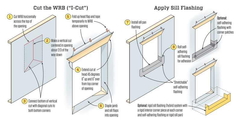

Both installation strategies covered here begin with proper preparation of the framed opening. Follow the steps to cut back the WRB and to flash the sill of the rough opening. Different materials and products are available to ensure a watertight sill.

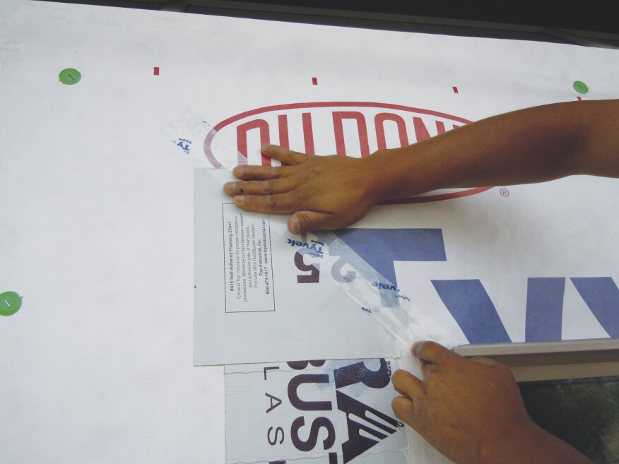

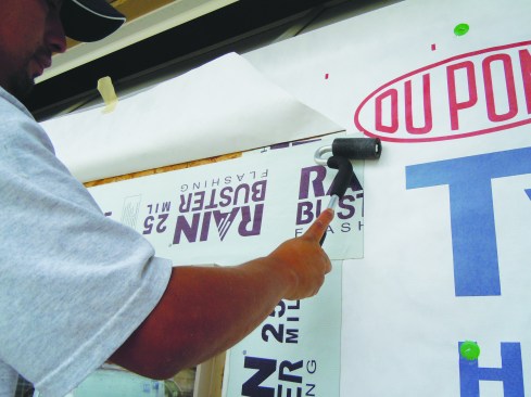

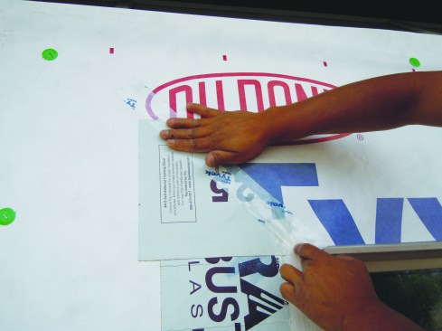

Both installation methods depend on a combination of self-adhered flashing tape (SAF) and sealant. SAF comes in many different configurations from many different manufacturers. Regardless of the type of SAF that is used, the installer should always go over the tape with a J-roller or similar tool to ensure full adhesion.
Rolling SAF is a must. To ensure proper adhesion and to eliminate wrinkles, use a J-roller to apply adequate pressure to the SAF.
