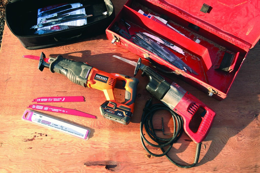

One of the first and most versatile power tools a new carpenter is likely to buy is a reciprocating saw. Milwaukee is reported to have invented the tool, and its brand name, Sawzall, has become a generic term for the tool that is commonly used on jobsites, regardless of brand.
Most professional-grade recip saws today are powerful 5-amp to 8-amp beasts with orbital action, adjustable feet, variable speed, and other helpful features. In recent years, cordless technology has improved to the point that I often leave my corded recip saw in the shop, in favor of a cordless version on the jobsite.

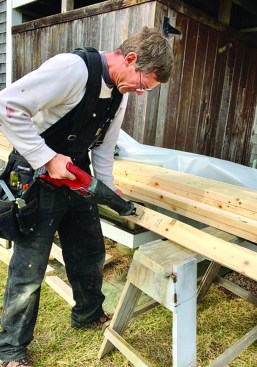

Recip saws from different millennia: The reciprocating saw on the right in the photo is a corded version from the 1980s. Changing the blade requires an Allen wrench. The cordless saw on the left is just a few years old and comes with a quick blade-change mechanism. Recip saw blades come in dozens of sizes and configurations for a wide variety of tasks. These blades are pretty tough, so most carpenters are not quick to throw them out, as evidenced in the assortment of blades that can often be seen in the saw cases.

Most hardware stores stock a wide variety of blades and other attachments for recip saws. I keep a collection of blades in the truck, mostly bi-metal blades in 6-, 9-, and 12-inch lengths. For cutting through framing, I typically choose bi-metal blades made for wood cutting or general-purpose cutting. They can cut right through nails you encounter as you slice through existing framing. These blades will “clip” nails or drywall screws if you want to remove framing without tearing out the drywall or sheathing. I find that some of the thicker, heavier blades specifically designed for demolition are occasionally useful, but they’re also slower. Thinner kerf blades cut much faster, and because recip-saw blades cut on the pull stroke, thinner blades work fine for demolition as long as they don’t bind in the work.
For cutting metal, I also keep a collection of bi-metal metal cutting blades, which are most useful for cutting rebar, pipes, and bolts. Because of their finer teeth, I also use metal-cutting blades when I need to make the occasional clean cut in finish material. Rounding out my collection are scrolling blades that are good for cutting a tight radius and abrasive blades for cutting tile or glass. I even own a scraper attachment and have seen other attachments with anything from files and abrasive pads to a special attachment for removing grout from between tile.

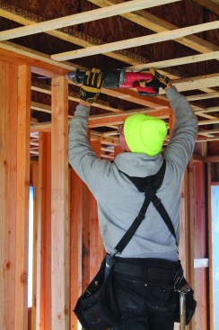

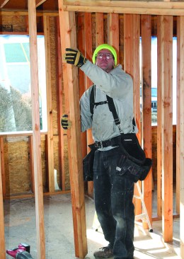

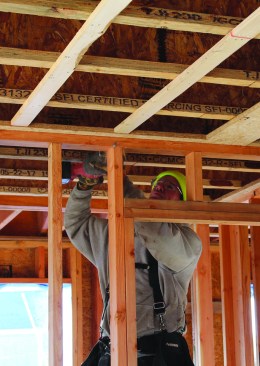

Rework. Similarly, we use our recip saw to make changes to existing work. If I want to add an opening, move or shorten a wall, shorten a soffit, shift a joist, or do any of a thousand other modifications, I usually reach for my recip saw.
Demolition. A recip saw is a great tool for destruction, although I’ve had to show many people that an old circular saw will make most demo cuts much faster and more efficiently if you have access for using it. (There are few things that frustrate me more than seeing someone spend 10 minutes making a cut that I can do in 10 seconds with another tool).

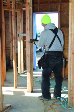

Many framers use a continuous sill when framing interior walls. After the walls are secured in place, a recip saw is the best tool for cutting out the rough sill in the door opening.

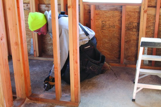

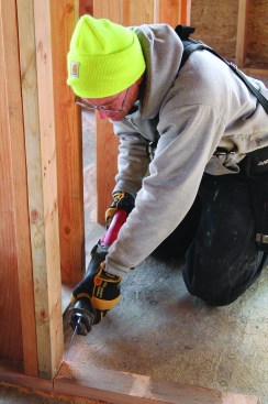

Removing sill plates at framing. Like most framers, I build and stand my interior walls with the bottom plates running through the openings. I always try to make courtesy cuts in the bottoms of the plates before they go up, but either way, the recip saw is the right tool for cutting the plates out of the openings later.

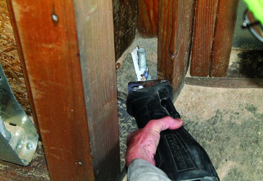

Recip saws can often get into tight spaces that other tools can't reach. With the right metal-cutting blade, the author can access this awkward space to slice off a bolt.

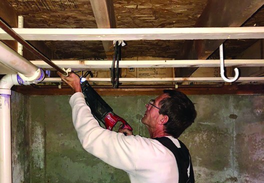

Cutting pipes, wires, cables, bolts, rebar, and other odd material. With the right blade, a recip saw can cut almost anything and often in the most hard-to-reach places, such as a foundation bolt in a narrow bay. I’ve also used a recip saw to slice into existing copper pipe. While a tubing cutter might make a smoother cut, the recip saw can make a quick cut in a pinch. And the cordless version might be appreciated if there is water in the pipe. For some of these jobs, a recip saw might be the only tool that works.

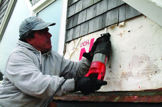

A shingle "thief" is a long flat bar that slips behind the shingle, hooks on the shingle nails, and pulls them out. That task is typically frustrating and arduous. Instead, a long recip saw blade cuts the nails behind the shingles so that the shingles can be removed more easily.
Thieving shingles. In my area, almost every house is sided with cedar shingles, and we often need to make changes or repairs to those shingles. The traditional method for removing shingles from underneath overlying courses is to use a miserable hand tool called a thief. This long, flat tool slips up behind the shingle and hooks the nail; then you drive it down to “steal” the nail. But the electric version of this tool is a recip saw with a long bi-metal blade.

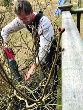

A special pruning blade can turn a recip saw into a landscaping tool in a pinch.
Pruning. A cordless recip saw is perfect for cutting pesky branches out of the way. In fact, with one of the new specialized pruning blades, it could become a mainstay of a landscaper’s arsenal.

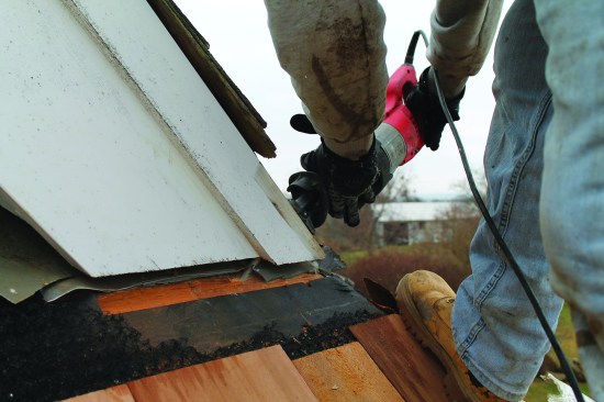

The flashing behind this rake trim needed to be replaced, so a crew member uses a recip saw with a long blade to clip the nails holding the original  flashing in place.
Specialty tasks. As mentioned above, there are many different accessories available to adapt your recip saw to other jobs, such as scraping, scrollwork, grinding, or cutting exotic materials. Usually, there are better tools for these jobs, but carrying a recip saw with these attachments on the truck can bail you out sometimes.
