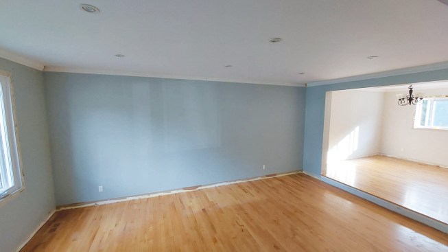

Looking a blank wall with a drawn plan can be intimidating. Looking at that wall with just an inspirational picture is worse. By taking the time in layout to work through all the issues you will achieve the result needed.
Finding center. The first step was to create a plumb and parallel frame in which the lattice would sit. I removed the existing crown molding and with the baseboard already removed for floor refinishing, I began the frame. For the ceiling and floor, I ran 1x8s level and parallel to each other to provide backing for the base and crown while allowing enough material to be exposed. Then I scribed a strip of 1×4 and ran it plumb at each end of the wall. Within that box, I found center both vertically and horizontally and drew lines up and across the wall. The pattern would radiate out from these anchor points. They were also my reference for all the steps that follow (see “Measurements.” illustration)

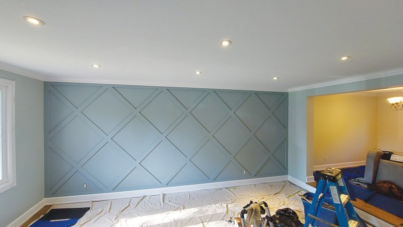

Installing. Once the layout was complete and approved, I cut the parts, glued them to the wall with adhesive caulking, and fastened them with an 18-gauge nailer, hitting studs where I could. With this being an exterior wall, I was not worried about hitting plumbing but still used 1 ½-inch nails. For these jobs, the glue is doing the heavy lifting so I prefer to save the steel and not fill my work with holes. (I’ll get a better finish later.) Because of how the parts fit together, I did not bother using a biscuit joiner. After three years, no cracks have shown at the joints. I did apply PVA glue where the 1×4 grid work connects and applied Bondo over those joints. I could have used Dyna patch or spackle, but I have found Bondo gives a better paint finish and is less prone to cracking.
All the edges were caulked to the wall, joints sanded, and surfaces primed before I applied two coats of finish paint. For the color, we went two shades darker than the surrounding walls from the same paint color swatch.
