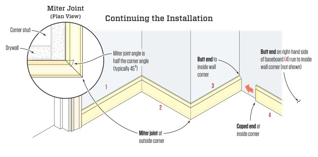

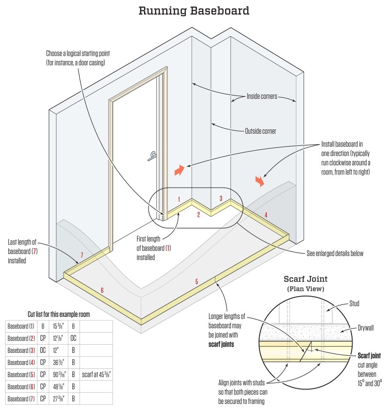

Cut list: A written list of components (in this case, lengths of baseboard) and the length you intend to cut them to. For baseboard, the cut list includes the type of cut that each end will receive.

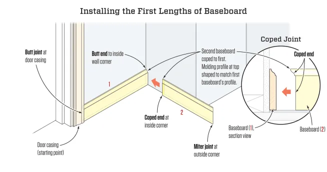

Coping: Cutting the profile on the end of a piece of molding with a coping saw or jigsaw.
Coped joint: An inside-corner joint made by cutting the profile of a molding on one piece so it mates with the profile on another piece.
Butt cut: A cut that is square in both depth and width on the end of a piece of trim.
Butt joint: A joint between two square edges.
Scarf joint: A splice made by overlapping angled cuts on the ends of two pieces of trim. In a run of baseboard, this splice is made with two equal-angled, but oppositely oriented, cuts on the ends of two mating pieces.
Miter joint: A joint that forms a corner with two pieces of wood cut at an evenly divided angle. With baseboard, the angles are typically 45-degree angles that are cut across the depth of intersecting boards.
Miter cut: One of two matching angles cut on a board to form a miter joint.
Back bevel: An angled cut made at a greater-than-required angle. Cutting a back angle relieves the "shoulder" (short point) of intersecting miters to ensure that the long points meet tightly.
