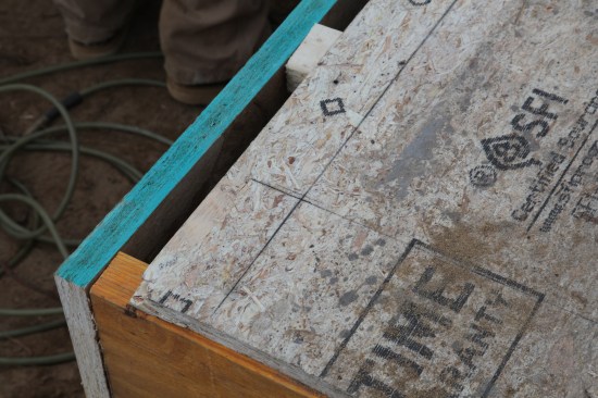

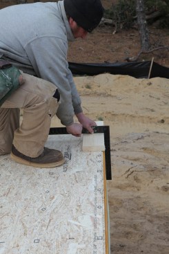

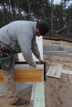

To lay out the wall lines, I first cut a scrap of the plate material (typically 2×4 or 2×6) about a foot long. Rather than relying on a tape measure for this step, I use the block for marking the inside edges of the plates. Starting with the longest wall, I hold the outside edge of the block flush with the outside of the rim joist on both sides of the corner and draw a line along the inner edge of the block.
The first line to establish is the baseline, which is usually the longest wall of the house. Using a gauge block made from 2-by plate stock, square off the rim joist of the floor deck and mark the first corner of the baseline wall.

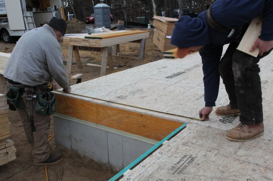

Repeat the process marking the opposite corner of the baseline wall and then snap a chalk line between the corners for the baseline.
I go to the other end of the longest wall and lay out that corner the same way, double-checking the overall length of the wall. With the length of the long wall and the corners established, I snap a chalk line between the marks to establish the control, or baseline, for laying out the rest of the walls.

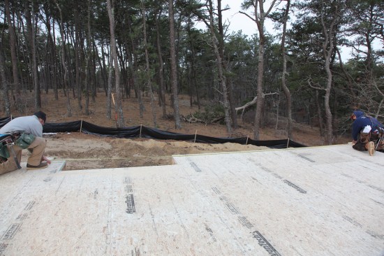

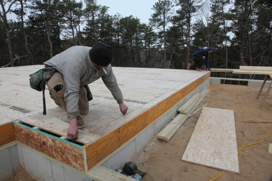

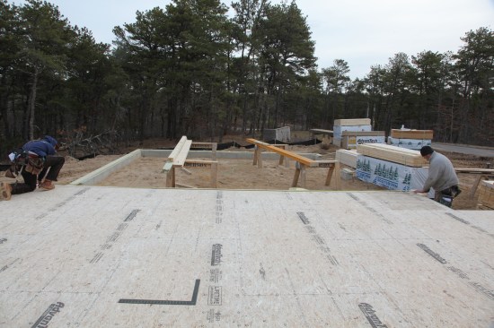

Next, I lay out the wall parallel to the base line. In our example with two rectangles, I measure up the length of the wall and use the gauge block to mark both sides of the first corner.
Using the gauge block, measure and mark the distance from the baseline (on the left) to the parallel wall. Working off the edge of the deck, mark an approximate corner with the gauge block.

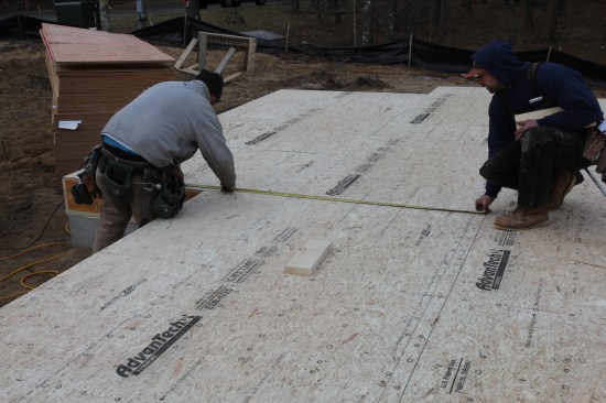

Measure and mark the distance for the other end of the parallel wall. Here, that distance is not at a corner of the building so use the gauge block from the edge of the floor deck to mark the approximate corner.
It’s important to note that this corner mark is only approximate at this point and will be adjusted. On the other side of the building, there is no corner for the large rectangle, so I measure up and mark the length of the wall, and place the gauge block on the edge of the deck to mark the approximate corner on that end.

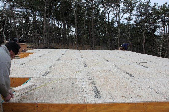

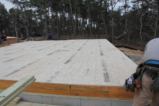

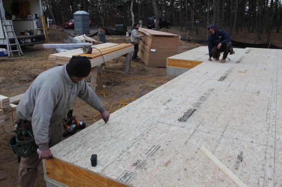

With the approximate corners marked, I use a 100-foot tape and take diagonal measurements between the baseline corners and the approximate corners on the parallel wall.
Measure diagonal distance between the corner on the baseline wall and the approximate corner on the parallel wall.
Measure the diagonal between the opposite corners. Adjust diagonals until the two diagonal measurements match exactly.
This is your chance to get the measurements dead equal. The simplest way to do that is to split the difference between the two measurements and adjust the corners to that figure. When the corners are adjusted to precisely the same measurement, I snap a line between the baseline corner and the adjusted corners.

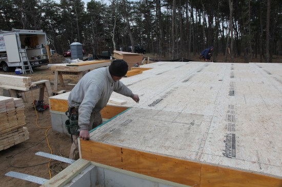

Snap a line from the baseline corner to the adjusted corner. That line for the square wall should be perfectly square to the baseline wall. Repeat the process for the square wall on the other side of the house. Note, the crew in the photos began the wall layout while another crew member was cutting the filler piece of sheathing for the end of the parallel wall. The missing sheathing did not affect the plate layout because the plate line for that wall fell on the installed sheathing.
In this close-up of the intersection between the square wall and the parallel wall, the approximate corner is marked in pencil, and the adjusted corner of the intersection is snapped in permanent black chalk lines. (Note:  The edge of the floor sheathing is missing from this photo. The crew will come back and piece this in before standing the 2x6 walls.)
In this close-up of the intersection between the square wall and the parallel wall, the approximate corner is marked in pencil, and the adjusted corner of the intersection is snapped in permanent black chalk lines. (Note: The edge of the floor sheathing is missing from this photo. The crew will come back and piece this in before standing the 2×6 walls.)
Those lines should be perfectly square to the baseline for placing the perpendicular walls. I also re-snap the parallel wall line in permanent chalk.
Once the corners are confirmed and the square walls are snapped, re-snap the parallel wall in permanent black chalk.
