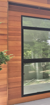

A theme emerged almost immediately. The exterior siding was going to be clear, vertical-grain, red cedar shiplap installed horizontally with a nickel gap reveal. The clients even directed me to a local address where they had first seen the look and encouraged me to view it in person.
When I arrived, the material itself looked great. What stood out, however, were the outside corners. Every mitered corner had opened up. Visually, it was distracting. Functionally, it raised red flags. Trying to hide those openings with corner boards would have defeated the intent of the detail altogether.

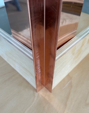

Fabricating the Trim
I have limited experience working with sheet metal, so my first thought regarding the copper profile was relatively simple. I envisioned an L-shaped corner modeled loosely after the Schluter Jolly trim referenced earlier. The idea was straightforward: a clean 90-degree metal edge that would provide a durable termination while remaining visually minimal.
That concept was quickly vetoed only a few minutes into the first in-person meeting with our fabricator.

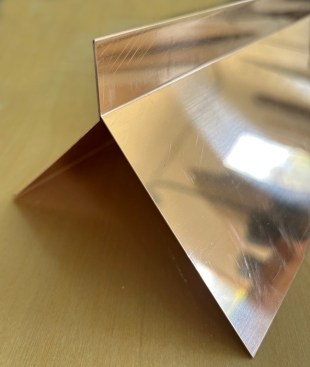

After I explained what I was attempting to accomplish, he stopped me mid-sentence, walked over to the brake, and quickly bent up two mockups. The first was a 45-degree fin. The second was a more substantial 90-degree profile with defined returns and a slight projection. Seeing those pieces in hand immediately shifted the conversation from whether the idea would work to which profile looked best and made the most sense architecturally.
We ultimately selected the 90-degree detail for the horizontal shiplap siding on this particular project. It created a crisp shadow line and a strong termination point without visually overpowering the façade. More importantly, that meeting made it clear that we were not developing a single copper corner. We were developing a family of options.
Once you stop trying to force a wood miter and instead begin thinking of the corner as a formed metal transition, the possibilities open up quickly. Depth, projection, reveal, shadow line, and profile geometry can all be adjusted. The same basic concept can be tuned to feel at home on a stark modern elevation or a much more traditional exterior. The only real limitation is what can be bent on a brake and the creativity of the person operating it.

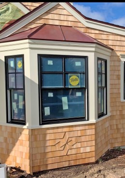

The 45-degree fin, for example, has since been used as a termination detail for cedar shakes. Rather than weaving outside corners, which frequently open, split, or telegraph movement over time, the shakes die cleanly into a single vertical copper fin. It gives the corner a sharp, intentional look while preserving the overall traditional character of the siding.
What began as a solution to a durability problem has evolved into a flexible system. Whether used with horizontal shiplap, vertical siding, or cedar shakes, each variation follows the same basic principle: Give the wood a clean place to stop, allow it to move independently, and let the copper turn a problem area into a visual feature.
Once the profile dimensions were finalized, our fabricator bent each copper section in manageable 10-foot lengths that could be dry-fit and assembled onsite. This proved important because dimensions may work on paper, but field conditions are rarely as exact as the drawings suggest. In areas where the overall run exceeded 10 feet, we also had 2-inch joining inserts fabricated. These were designed to slip inside the profile and create a clean, concealed solder joint after installation.

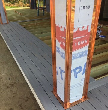

Each copper termination was installed directly over the WRB and corner membrane splines before siding began. Cedar Breather followed completion of the copper installation. In effect, the copper established a permanent control line for every outside corner before the first siding board ever went on.
That sequencing made the siding install far more predictable. Each board was simply cut to length, the end grain treated, and the board run to a consistent 1/8-inch reveal using a temporary shim that was removed after fastening. Instead of trying to maintain a fragile wood miter while simultaneously climbing the wall course by course, every cut terminated against an already established reference point.
At corner transitions, the individual copper pieces were mitered. On long vertical runs, adjoining sections were butted together over the concealed joining inserts. Everything was then soldered after final fit-up.
Instead of the usual decorative trim pieces that are applied aft…
Waiting until the end to solder was intentional. Minor field adjustments are inevitable, and pre-soldered sections would have made those adjustments difficult without damaging seams or distorting profiles. By dry-fitting first and soldering last, we were able to keep all lines straight, all joints tight, and all transitions clean.
Once soldered, the copper ceased to be a collection of separate trim pieces and became one continuous skin wrapping the vulnerable corner conditions.
That distinction is important. These are not decorative copper covers applied after the siding is complete. They are integrated metal terminations installed as part of the siding system itself.
