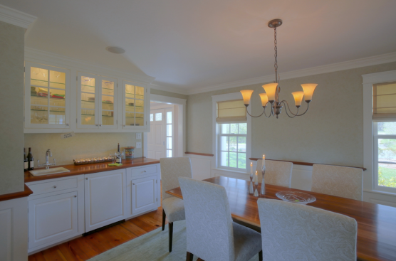

Ambient. Pendants can be used in concert with a flush-mount light.
Roe Osborn
Ambient Light
Ambient light is the general lighting for the entire kitchen space, and it should closely mimic the natural daytime light in the room. When choosing ambient light sources for a kitchen, consider kitchen size and ceiling height. The bigger the kitchen and the higher the ceiling, the more ambient light output is required, which usually means that more fixtures will be needed.
Fixtures for providing ambient light can vary, and different sources can be combined to create a pleasing balance. The important thing is to avoid creating dead zones—areas that are dim, with little or no light. At the same time, be conscious of creating hot spots where light from multiple sources overlaps and creates an overly bright area. Here are some typical sources for ambient lighting.
Recessed downlights are the most common choice for ambient kitchen lighting. They’re the most effective type of lighting, although in small kitchens, they should be used judiciously. Recessed downlights are typically spaced 4 to 5 feet apart, either on a grid or in a line depending on the kitchen layout and ceiling height.
Be aware that recessed downlights often serve double-duty as task lighting. So positioning of these lights above counters and cabinets is critical (more on this later, in the discussion of task lighting). If downlights are the only ambient light sources, 6-inch-diameter fixtures that have a wider spread of light are the best choice.
Ceiling-mount fixtures come in either flush-mount models that attach directly to the ceiling or semi-flush-mount models that drop a short distance below the ceiling. Either type is a good choice for an older, smaller kitchen with a low ceiling. In such a kitchen, a single flush-mount fixture can be placed centrally; or two fixtures can divide a larger kitchen into thirds.
Ceiling fixtures can also work well when supplemented by other light sources, such as pendants over an island or a peninsula. In a home with low ceilings (7 to 7 ½ feet), ceiling-mount fixtures can provide more comfortable light than downlights. These fixtures typically have translucent lenses or glass shades that diffuse the light throughout a room. Downlights, on the other hand, direct a more concentrated cone of light downward and tend to create uneven light in kitchens with low ceilings.
The lower positioning of semi-flush-mount fixtures lets more light reflect from the ceiling, but they work better with slightly higher ceilings because they hang down lower than flush mounts.

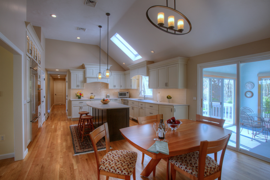

Chandeliers and pendants. For two-story, tray, cathedral, or pitched ceilings that are 10 or more feet high, chandeliers and pendants can provide effective ambient light. These fixtures bring light down to a more human scale in rooms with high ceilings and are often used to supplement other light sources. In addition to providing light, pendants and chandeliers can be a focal point in an otherwise simple design.
For small kitchens, a single fixture may be enough, especially if supplementing downlights. If the kitchen is very large, two or more fixtures work well in areas such as over a large island. When multiple pendants are used for ambient lighting, they should be no less than 6 feet apart and no less than 6 feet from any structure such as a wall or upper cabinet. The bottom of pendants and chandeliers should be at least 7 feet above the floor so they don’t block views, and they should be controlled with a dimmer to be effective for ambient lighting. The output of these lights should be between 100W to 250W equivalent, bright enough to light the kitchen when it’s entered.

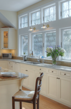

Task. Over-sink lighting is necessary for safety reasons. Sconces work well for this urpose and can add visual interest to a design.
Roe Osborn

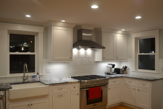

Task. Downlights placed in the ceiling in front of the cabinets work best when used along with under-cabinet LED lighting.
Carolyn Anderson
Fixture spacing should be a function of ceiling height. The higher the ceiling or soffit, the farther apart fixtures can be, but higher output is needed with the light source farther from the work surface. That said, I usually center lights on upper cabinets so the fixtures light the interior when the doors are open. Make sure that the cones of illumination light the work surface evenly.
Under-cabinet lighting. Though recessed downlights can offer adequate task lighting by themselves, they work best in concert with under-
cabinet lighting, which puts a light source below the upper cabinets, where small appliances and cooking implements are often stored and where food is placed as meals are prepared.
The under-cabinet fluorescent fixtures of 20 years ago have been replaced by low-profile dimmable LED strip lights that create pleasing, warm-colored lighting. Whenever possible, I specify upper cabinets with a light rail (a 2-inch addition to the lower face frame), with the light strips directly behind the rail. The fixtures I prefer are 1 inch wide and only ½ inch deep so they aren’t visible to someone sitting in the kitchen. Be sure that they provide a minimum of 60W equivalent light per cabinet. For corner cabinets, I often use a single puck light instead of a strip, also with 60W equivalent.

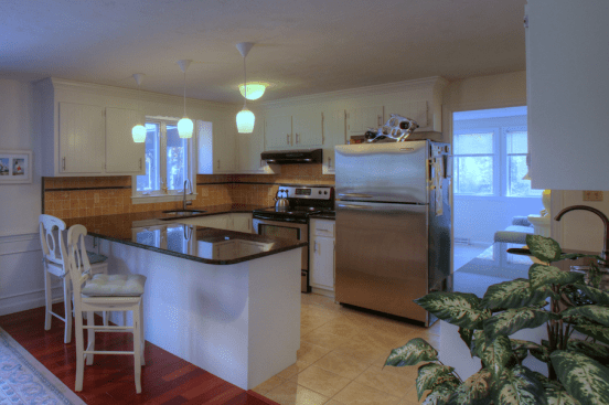

Pendant task lighting. Peninsulas and islands often offer the largest work surfaces in a kitchen, and many islands have prep sinks. Pendant lights in these areas can be a single fixture or multiple ones, or multiple lights suspended from a single bar. Pendants for task lighting should be 30 to 36 inches above the countertop height (66 to 72 inches off the floor) to avoid blocking the view. They should be placed 24 to
30 inches apart, with each light providing a minimum output of 75W equivalent.
Pendants come in a variety of styles and prices. These fixtures are often a distinct design feature, so be careful that they blend with the style of the kitchen. If you’re using chandeliers or pendants for ambient light in the kitchen, avoid replicating this type of lighting over an island or peninsula, to prevent visual competition in your design. If the kitchen opens into the dining area, make sure the fixtures in both rooms relate to each other in shape, finish, or style.
Over-sink lighting. For safety reasons, task lighting over the sink is essential and should never be overlooked or skimped on. A 4-inch downlight, a pendant (12 inches out from the wall), or a sconce over a window can serve this purpose equally well. A 60W equivalent is fine here.
