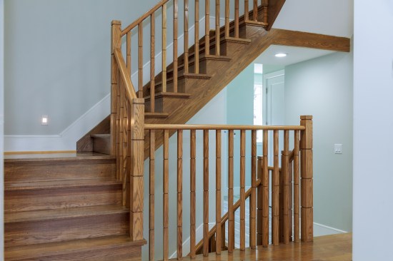

I’m about to embark on an exciting build of a “dancing winder” staircase this summer, which I’ll document in a JLC article to come later this year. Before we get to that complex winding stair, however, I thought I’d begin easing into the topic of winding stairs with a discussion of the simplest design—a basic “quarter-turn,” or L-shaped, stairway with two half-flights of stairs, a lower one leading up to a landing, where it turns the corner and starts the upper half-flight.
A typical quarter-turn stair, such as the one shown in the slideshow above, has a square landing. There’s nothing wrong with this landing shape but it complicates the handrail. To understand why, let’s first focus on the inside corner of the landing as shown in the illustration below: You have a riser from the top tread on the lower half-flight of stairs coming up to the landing, and from the landing you have another riser to the first tread in the upper half-flight of stairs. These two risers meet at the inside corner of the landing where they are essentially stacked on top of each other. This can be seen plainly in a Stretch-out View (see illustration below).

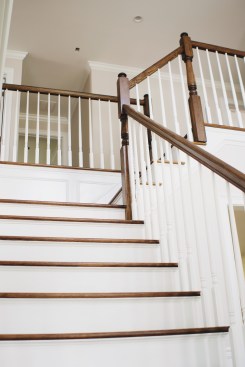

The square landing also creates other problems. Notice the line of the handrail on the stretch-out drawing of the stair with a square landing. If you want to maintain a consistent handrail height, the lower portion has to ease up into a gooseneck that runs vertically at the newel, so it can hit the newel at the same height where the upper handrail jumps off of it. At least three separate handrail pieces are required for this detail.
Alternatively, the upper and lower handrails can die into the landing newel at different heights. This requires either a wide square landing newel or an elongated block high on a turned newel; both are common because it’s easier than assembling
a gooseneck.

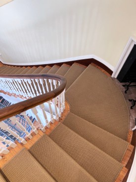

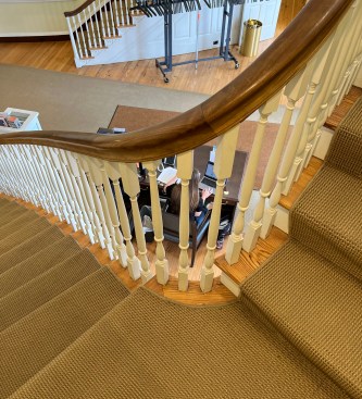

If space is limited, there are ways to build a smaller landing and maintain the simpler handrail. One of my favorite examples of this is the stairs designed by Thomas Jefferson at the Rotunda at the University of Virginia (see photos below).
This stair uses a pie-shaped landing and a few skewed treads above and below the landing. Because of the curve it presents itself like a circular stair, but in essence it’s a quarter-turn stair. Instead of a square landing that comes to a point on the inside of the turn, Jefferson elongated the landing to match the tread depth below the handrail, so it successfully unstacked the risers and achieved that smooth, single-line handrail.
