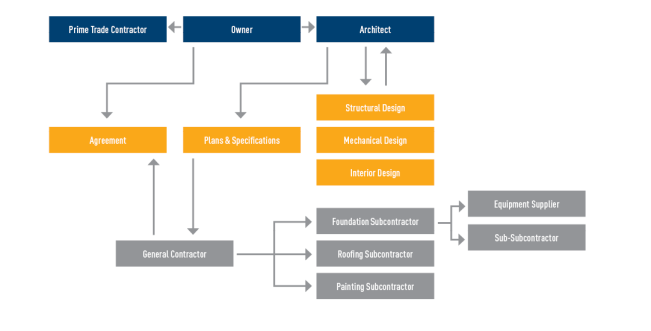

Click to enlarge image below.
Example project organizational chart. When two or more players in a construction project cannot come to terms, they are likely to end up in civil litigation. Litigants will need to be clear on the roles and responsibilities of each player.
Peter D. Fowler, adapted by JLC
Sample project organizational chart. When two or more players in a construction project cannot come to terms, they are likely to end up in civil litigation. Litigants will need to be clear on the roles and responsibilities of each player.
Roles and Responsibilities

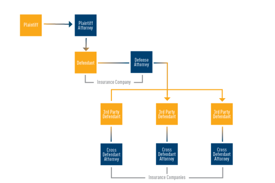

All civil litigation has a plaintiff, plaintiff attorney, defendant, and defense attorney. Building-related claims often have many cross-defendants (commonly trade contractors and suppliers) and their attorneys, as well.
