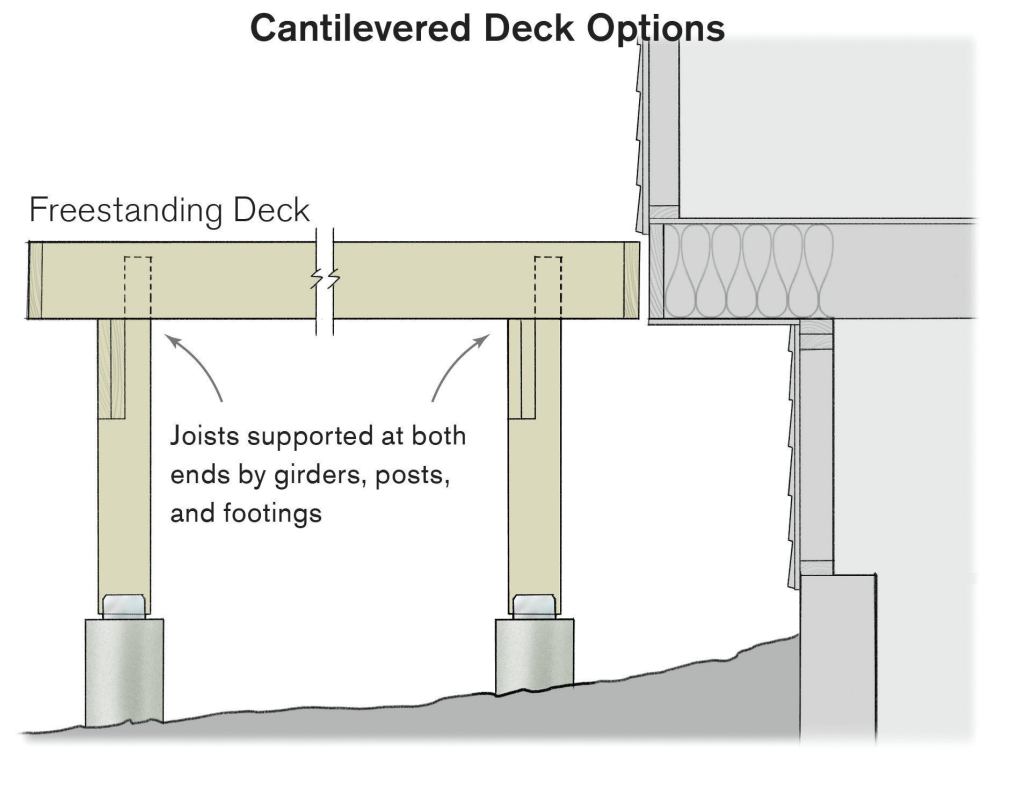

A: Mike Guertin, a custom home builder in East Greenwich, R.I., and a regular presenter at Deck Expo, responds: While the language has changed with each code revision, the last three versions of the IRC haven’t allowed deck ledgers to be connected to the rim joists of cantilevered floors. Here’s what the 2015 IRC (R507.2.2) says: “Band joists attached by a ledger in accordance with Section R507.2 shall be fully supported by a wall or sill plate below.” Sure, it doesn’t specifically say you can’t connect a ledger to a cantilevered rim joist, but that’s what it means, since a cantilevered rim joist by nature is not supported by a wall or sill plate. And this isn’t something that was added to the building code for no reason. Many deck failures have been attributed to a cantilevered floor rim joist pulling away from the house or shearing downward. Rim joists are just nailed to the ends of the floor joists. Without any direct support beneath a rim joist, the nails alone can’t support the load from the deck.
I’ve used two solutions to build a deck when the house has a cantilevered floor. The simplest is to build a freestanding deck, as shown in the top drawing. Install a beam with posts and footings along the house end of the deck, just as you would at the outside of the deck. The beam can be built into the floor system—say a double or triple rim joist—or it can be placed beneath the deck joists.

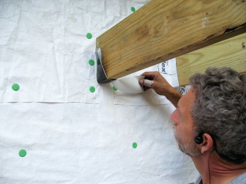

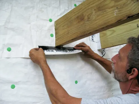

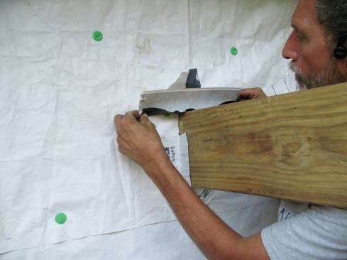

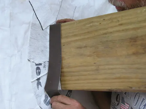

Each joist needs two pieces of flashing tape about 5 inches wide, and long enough to wrap around two-thirds of the perimeter of the joist. For 2×8 joists, for example, I cut 11 1/2-inch-long pieces from leftover lengths of DuPont FlexWrap flashing tape. Its release paper is prescored, so cutting through the flashing tape 1 1/2 inches to the side of the score line lets me bond the 1 1/2-inch portion to the joist while the remaining 3 1/2-inch-wide portion of the tape stays protected by release paper. I remove the release paper from the 1 1/2-inch-wide portion—the joist leg—and bond it to the bottom of the joist and fold it up onto the sides, pressing the tape tight to the joist. The tape should reach more than halfway up the sides of the joists, so that later it can be overlapped by the top piece of flashing tape.

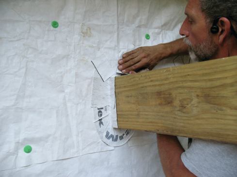

Next, I remove the second half of the release paper and flare the wall leg out so that I can bond it to the housewrap around the bottom half of the joist. I use both hands to stretch the flashing tape evenly and form an arc around the bottom of the joist without too many wrinkles. If tape tries to curl up off the housewrap when it is stretched, I staple the flashing tape to the wall to hold it in place.

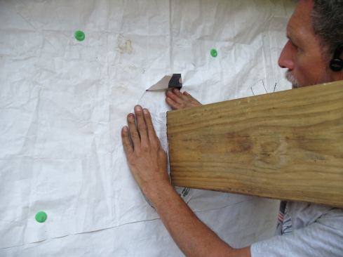

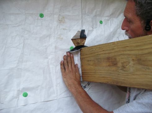

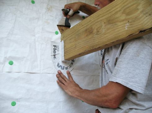

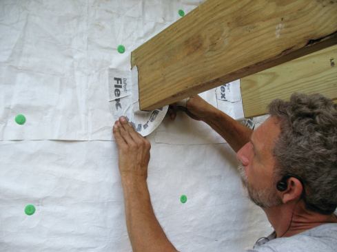

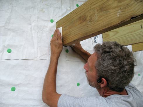

Before installing the upper piece of flashing, I make a pair of 3-inch-long diagonal cuts in the housewrap, starting at the top corners of the joist, to create a head flap. After removing the narrow strip of release paper from the second piece of flashing tape, I center the tape on the joist and bond it around the top half, so that the upper legs overlap the lower legs of the flashing tape. Then I remove the release paper from the wall leg of the flashing tape and flare the tape onto the wall and over the sheathing where the head flap is lifted. Finally, I fold the flap of housewrap back down over the flashing tape, and seal the cuts with scraps of flashing tape.
Most flashing tapes can’t be left exposed to sunlight, so I apply a 1 1/2-inch-wide strip of aluminum coil stock around the joist to protect the tape. The metal strip also looks more finished than the flashing tape and leaves a crisp line for siding and trim to butt against.
