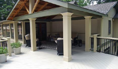

I take a different approach with open-air porches. Because there are usually fewer posts than on a screened porch, I use 6×6 posts for a more substantial structure. The posts should be located where the side wall beams meet the house, at the two outer corners, and mid-span as needed. I often incorporate column and beam wraps to achieve a more custom look (Figure 10). Using fewer posts may require the beam they support to be upsized, depending on roof loads. Tables in the IRC are useful for sizing beams, but when in doubt, have the design engineered.
Figure 10. Open porches have fewer posts than screened porches. To maintain the look of adequate support, the author wraps such posts with trim to increase their width.
