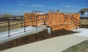

Every place in a building or on a structure outside a building is considered part of the means of egress (Figure 1), including enclosed areas such as decks and exterior exit stairways or ramps, where flames, airborne debris, or collapsing structures can still threaten occupants’ safety and their ability to reach a public way. Travel can’t be inhibited by security fences, gates, trip hazards, or excessively uneven or sloping surfaces.
Figure 1. Even small public decks such as this view platform must have at least one accessible egress path.
