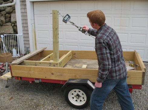

The author informally tested the strength of different guard-post-to-frame connections made with structural screws and blocking using a hand cable winch fitted with a 1,500-lb. digital crane scale.
The code doesn’t specify how to make the connection to prevent joist rotation. But it does prohibit connections that rely only on fasteners (nails and screws) driven into end grain, because it recognizes that they do not hold connections tight and are relatively easy to pull out. This is especially the case for deck frames, where the elements will take their toll over time and weaken connections that may initially feel solid.
So if you fasten posts to the rim joist, you also have to connect the rim joist to the adjacent joists (the deck joists that the rim joist is fastened to) in a manner other than driving screws or nails into the ends of those joists. The same would be the case for perpendicular blocking between the end joist and the next inboard floor joist. Fasteners that are driven through the joists and into the end grain of the blocks are subject to withdrawal; that’s why the code doesn’t allow us to rely solely on those fasteners.
The goal of the testing was to find out how well various screw-and-blocking deck post connection details would fare under the 500-lb. test load requirement of ASTM D7032, the standard that wood-plastic composite (WPC) guardrail systems have to meet to comply with code.

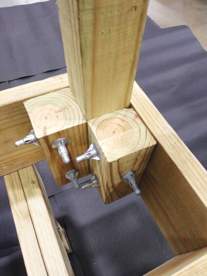

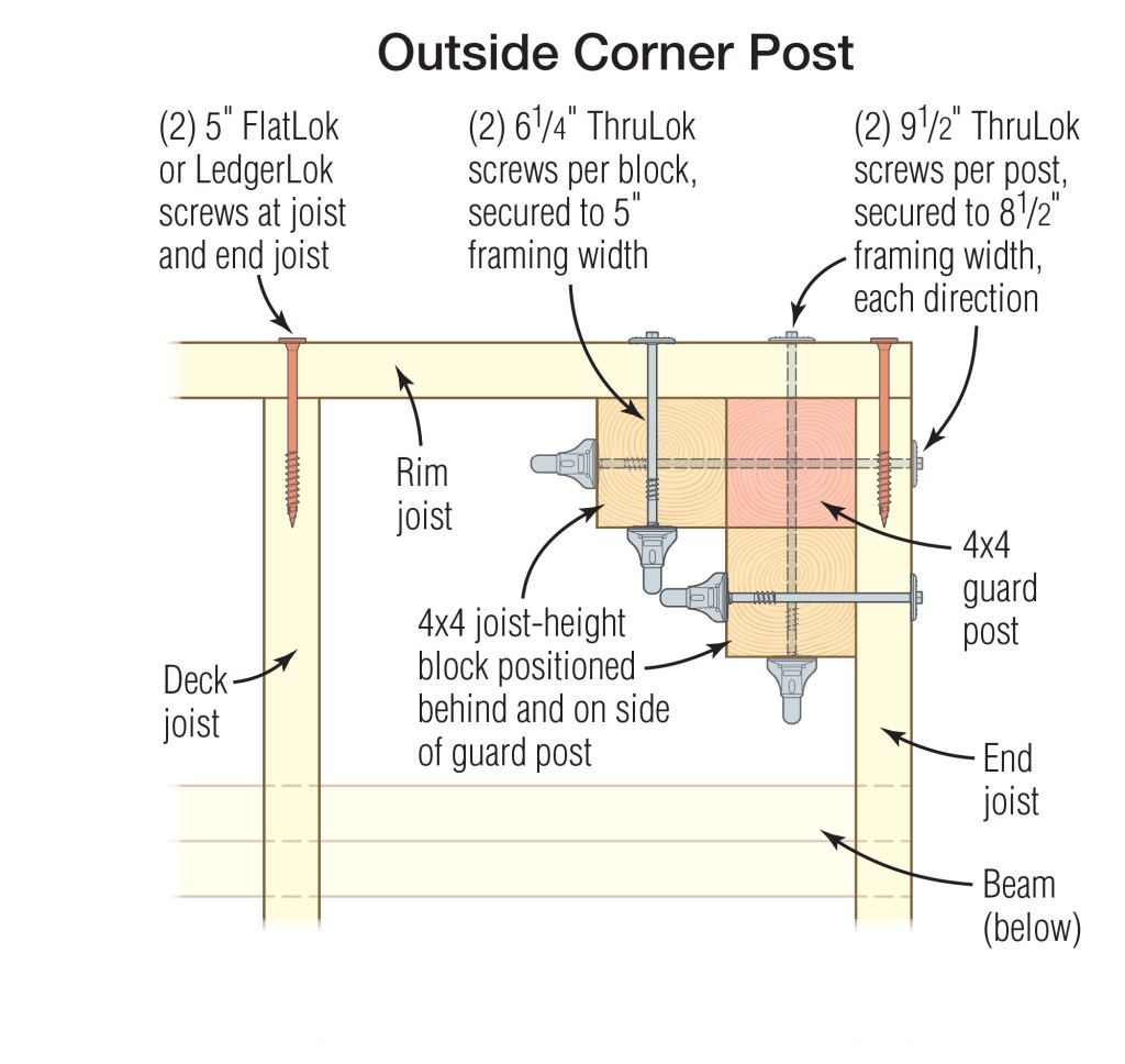

Outside corner post. It would seem that the simplest and strongest connection of a guardrail post to a deck frame would be fastening the post to the inside face of an outside corner. Screws or bolts driven in through the post from the rim joist on one face and the end joist on the other would seem bulletproof. But the Virginia Tech testing showed that because the bolts or screws are so close to the ends of the joists, the wood split.
FastenMaster’s corner post detail is made with ThruLok and either LedgerLok or FlatLok structural screws and a pair of full-height 4×4 blocks. For connection details, see the drawing below.

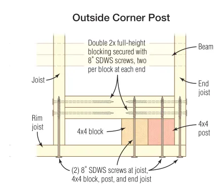

Simpson Strong-Tie’s corner post detail is made with SDWS timber screws, a single 4×4 block, and a pair of full-height 2-by blocks between joists. For connection details, see the second drawing below.
One solution offered by FastenMaster is to screw short 4×4 blocks on each side behind the guardrail post . This moves the screws helping to transfer the load into the joists away from the ends of the joists, so there’s less chance of splitting when a force is applied.
Alternatively, Simpson Strong-Tie’s corner detail uses a combination of double blocks behind the post between the end joist and the first inboard floor joist, and a 4×4 block between the double blocking and the rim joist to achieve the same result—moving the fasteners that resist the load farther back from the ends of the joists.
Pairs of screws driven through the rim and end joist into the joists and blocking are located 1 1/2 inches from the top and bottom edges. The two screws driven into the corner post are located 2 inches from the top and bottom edges of the rim joist.
Where pairs of screws are required, the screws are located 1 3/4 inches from the top and bottom edge of the joists. Note: ThruLok screws are not recommended for saltwater locations; LedgerLok screws require 5/32-inch-diameter pilot holes.

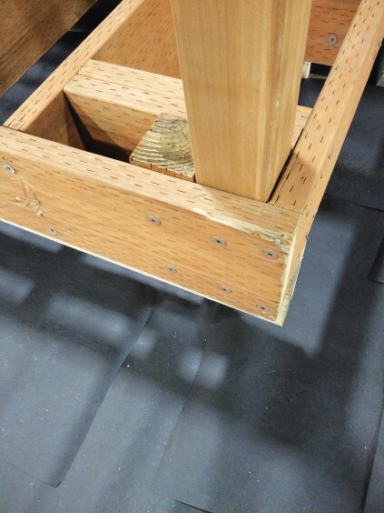

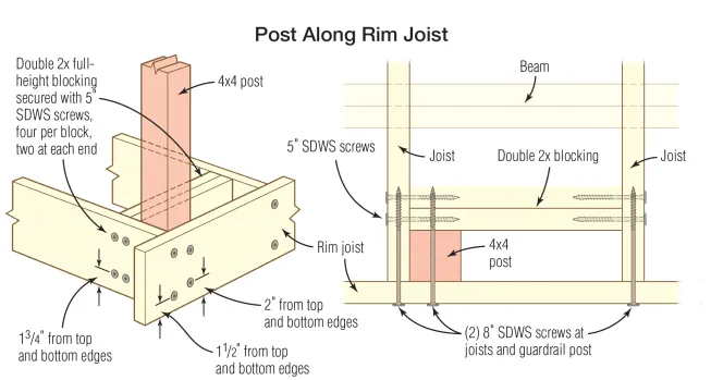

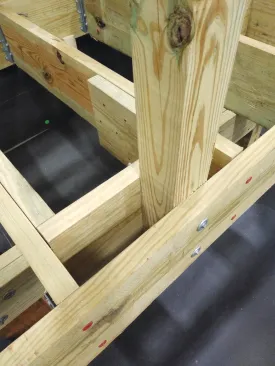

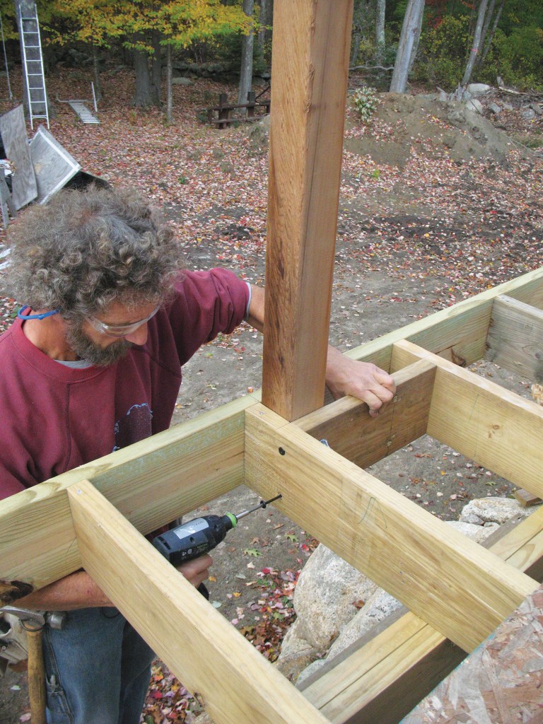

Post along rim joist. Rim joists are commonly fastened to the ends of the deck joists with nails or screws. Because those fasteners are driven into end grain, the 2021 IRC specifically prohibits relying on them solely to prevent the rim joist from rotating and pulling away from the joists. The rim joist needs to be reinforced or the guardrail posts connected to the deck framing in a way that doesn’t rely on the rim joist (or both). Both designs use joist-depth blocking behind the guardrail post and between the joists.

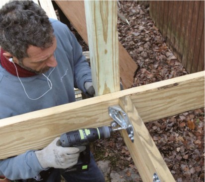

When fastening a post to a rim joist with FastenMaster ThruLoks, reinforce the connection with blocking as shown in the photo and in the drawing below.
When fastening a post to a rim joist with FastenMaster ThruLok screws, the ThruLoks should be located 2 1/4 inches from the top and bottom edges of the rim joist, as shown. Either FlatLok or LedgerLok screws can be used for the framing connections; they should be located 1 3/4 inches from the framing edges.
FastenMaster reinforces a single 2-by block with blocks sistered alongside the joists. The guard post is fastened between the rim joist and the perpendicular block.
Simpson Strong-Tie uses double 2-by blocking behind the guardrail post and between the deck joists. In both details, the rim joist is fastened to the joists on either side of the post with structural screws. The guardrail post can be installed anywhere within the joist bay.
A post fastened to a rim joist with Simpson Strong-Tie SDWS screws can be located anywhere within the joist bay, as long as the connection is reinforced with blocking as shown in the drawings above. This detail requires 10 5-inch SDWS screws and six 8-inch SDWS screws, along with two lengths of full-height blocking between joists.

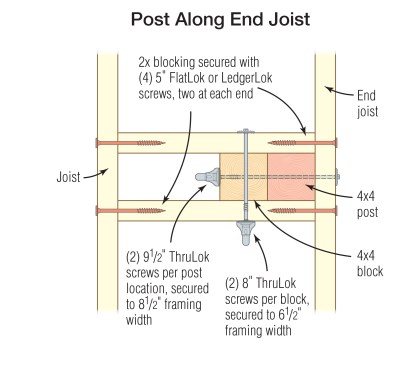

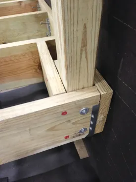

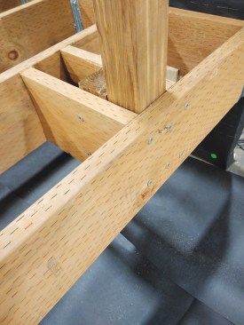

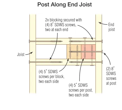

Post along end joist. End joists rotate easily without reinforcement. Both FastenMaster and Simpson use the same blocking arrangement: joist-depth 2-by blocks on either side of the guardrail post and between the end joist and the first inboard floor joist, along with a 4×4 vertical block behind the guardrail post and between the 2-by blocks. Screws fasten through the end joist, through the guardrail post, and into the 4×4 block, which is screwed through the 2-by blocks.

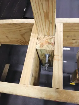

When fastening a post to an end joist with ThruLok screws, reinforce the connection with additional blocking as shown in the photo here, and in the drawing below.
When fastening a post to an end joist with with 8-inch Simpson Strong-Tie SDWS screws, locate the post screws 2 inches from the top and bottom edges of the end joist, as shown in the photo above and in the second drawing below.
FlatLok or LedgerLok screws are used to fasten the blocking to the framing, as shown above. The ThruLoks are located 2 1/4 inches from the top and bottom edges of the end joist, and 1 3/4 inches from the top and bottom edges of the blocking.
8-inch SDWS screws are used to connect the post and the blocking to the end joist, as shown above, with the screws driven through the end joist into the blocking 1 1/2 inches from the top and bottom edges of the joist. Pairs of 5-inch SDWS screws on both sides are also driven through the 2-by blocking into both the post and the 4×4 blocking.

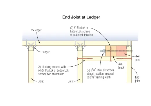

End joist at ledger. Neither FastenMaster nor Simpson Strong-Tie offers a detail for fastening a guardrail post where the end joist meets the ledger. One approach to secure the post is to drive screws through the side of the post and into the framing in the wall. But if there isn’t a stud or blocking in the wall, then you’re out of luck. I made up my own detail, mimicking the detail used farther along the end joist. The ledger takes the place of one of the perpendicular blocks between the end joist and first inboard floor joist. The short 4×4 block is screwed through from the block and into the ledger. While it’s not an independently tested detail, I believe that it meets the intent of the code.
Where a corner post at the ledger can’t be screwed through the sheathing into wall framing, the author reinforces the connection of the end joist to the deck framing with blocking as shown above, and in the drawing below.
The author screws 2x and 4×4 blocking to the deck framing as shown above, then fastens the post to the end joist and 4×4 blocking with a pair of ThruLok screws.
