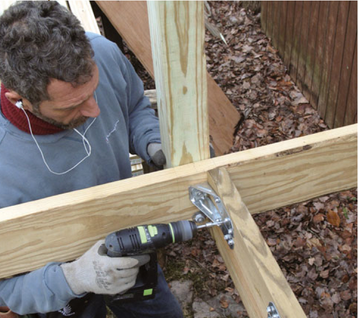

One way to strengthen the connection between a guard post and the deck frame so that it will meet code is with specialized hardware, such as Simpson Strong-Tie's DTT2Z tension tie, but it's not the only way.
Though there has been little change to the guardrail requirements in the International Residential Code (IRC) in the past 10 years, guardrails have nonetheless received increased attention from code officials, and enforcement is changing. This may be largely due to research done at Virginia Tech that highlighted two key points. First, the code actually requires guardrails to be much stronger than most of us thought it did. And second, most traditional methods of mounting posts don’t meet those strength requirements.
In this article, I’ll show a number of post mounting details that do meet code requirements. Many of them are based on supporting materials from industry associations and manufacturers. (Supporting documents generally allay inspectors’ concerns and give me peace of mind that I’m using the best practices available.) But there aren’t supporting documents for every post-to-frame detail. In those cases, I draw on what I know of load paths and hardware and get my designs okayed by a building official before starting construction. Alternatively, I have a registered engineer design the connection.
It’s ultimately up to your building official to decide whether your guardrail complies with the code, and you may not have to go to the measures I’ll explain here. Still, it may be a good idea from both a sound construction and a risk management point of view – a structure’s passing inspection does not entirely relieve you of liability.

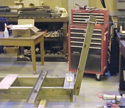

Much of the recent discussion about deck railings originated with the article (“Strong Rail-Post Connections for Wooden Decks“) that detailed testing done at Virginia Tech of several typical post-to-joist connections. To design the test, the researchers first looked to IRC Table R301.5 (Minimum Uniformly Distributed Live Loads) and footnote “d,” which require the guard to support a 200-pound concentrated load at any point along the top. Then they applied a safety factor of 2.5 – required by IBC section 1714 (Preconstruction Load Tests) for any tested assembly – and came up with a 500-pound test load.
In testing done at Virginia Tech, every traditional woodto- wood post-mounting detail failed. It wasn’t the post-to-rim-joist connection that failed, but the connection of the rim to the deck framing.
Since the “Strong Rail-Post Connections” article appeared, I’ve heard a lot of discussion among deck professionals about whether guardrails need to be able to support a load of 200 pounds or 500 pounds. I’ve adopted the higher standard because other code provisions, referenced standards, and International Code Council Evaluation Service (ICC-ES) test criteria for manufactured guardrail systems all seem to support it.

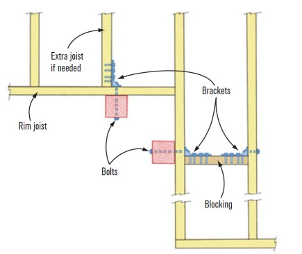

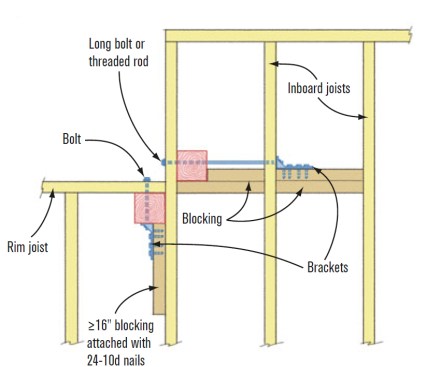

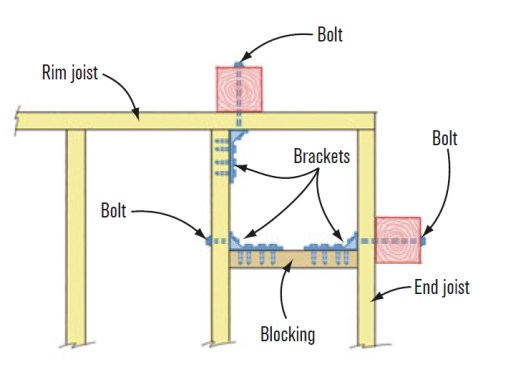

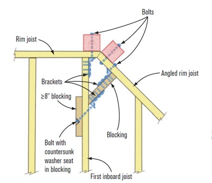

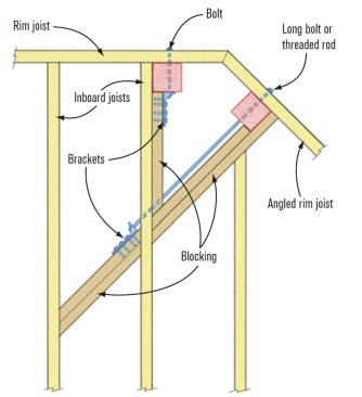

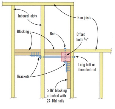

Securing Blocking
Many post-to-frame details require blocking between or alongside joists. The blocks and how well they are fastened are critical to the connections because the hardware is screwed to them. Hardware-manufacturer instructions and good framing practice guide how I nail blocking.
Blocks nailed to the side of joists or rim joists get a minimum of 24 10d (3 inches by .148 diameter) hot-dipped-galvanized or stainless steel nails (left). The nails are arranged in three lines 2 inches down from the top, 2 inches up from bottom, and in the center. A 16-inch-long block will have three rows of eight nails spaced about 2 inches apart. An additional benefit of placing the nails 2 inches from the top is that doing so centers them on the bracket and ensures the nails won’t get in the way of the bracket’s screws.
Blocks between joists are fastened together with 12 10d nails. Four 16d nails driven through the joist or rim into the butt end of each block secure it to the joists.

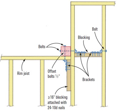

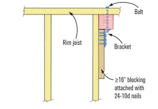

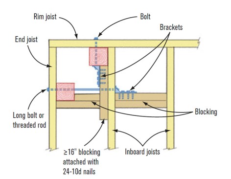

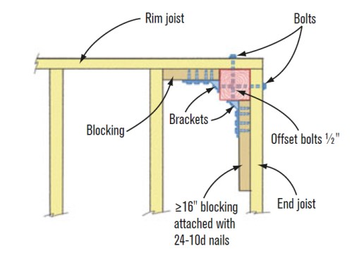

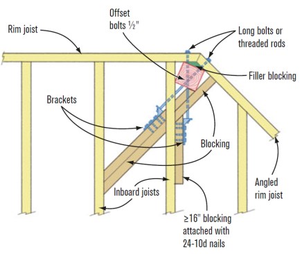

While manufactured deck railing systems have specific instructions about assembling rails, balusters, and post sleeves, most rely on standard 4x4s for posts, and the instructions don’t say much about post installation. Railing manufacturers require or recommend that the posts be “installed according to the building code,” “approved by the building official,” or “designed by a professional engineer,” or that they meet some other qualification. In short, most instructions leave us to install the posts the same ways we do with site-built rails.
Most manufactured railing systems require posts mounted inside the rim. That requires both a bracket to resist the outward force at the top of the rim, and blocking to resist the inward force at the bottom of the post.
One difference is that manufactured deck railing systems usually require guardrail posts to be mounted inside the rim joist so post sleeves and base trim rest flat on the decking. But in most cases posts are easier to install outside of the rim joist. There is a way to use outside-the-rim mounted posts with manufactured railing systems – just add a 2-by skirt board outside the posts. You can either mount such a skirt board using the same bolts that mount the posts to the rim and the metal connectors, or fasten it with structural screws after bolting the posts. I find screwing the skirt on afterwards faster than bolting, even though I have to bore out the back of the board for the bolt heads.
The Hardware

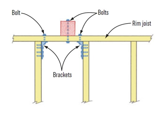

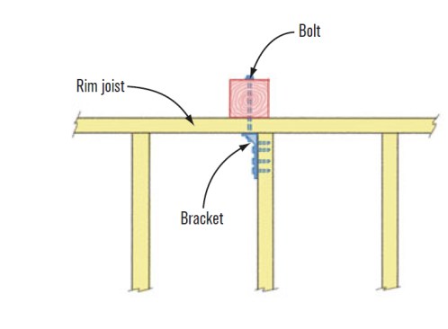

The only configuration that resisted a 500-pound load in the Virginia Tech testing used Simpson Strong-Tie HD2A anchors (800/999-5099, strongtie.com) to connect the post to the joists. The HD2A was originally intended as a heavy-duty hold down for resisting seismic or wind loads on walls. It requires three 5/8-inch-diameter bolts; two through the joist and one through the rim and post. When I used the HD2A hardware, it was often hard to find hot-dip-galvanized 5/8-inch bolts – especially the 2 1/2-inch-long ones used through the joist. Locally, the HD2A and the bolts cost $18.49.
In 2009, Simpson Strong-Tie introduced the DTT2Z and USP the DTB-TZ (800/328-5934, uspconnectors.com). Another connector, the DeckLok Bracket (deck-lok.com), is also claimed to work for mounting guard posts, but it’s been unavailable for about a year. Its inventor, Michael Morse says that it will be back on the market this spring.

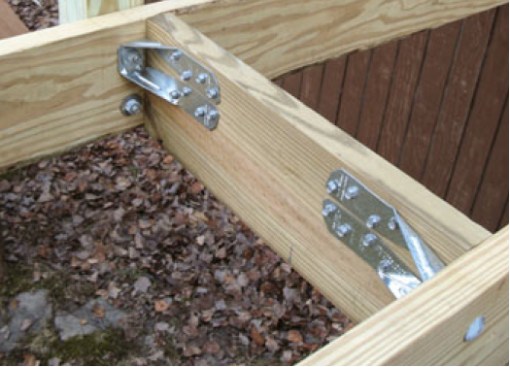

USP’s DTB-TZ (left) and Simpson’s DTT2Z (right) are two connectors that can provide IRC-required strength to a guardrail post. In addition to the structural screws shown, both require a 1⁄ 2-inch hot-dipgalvanized bolt to complete the connection.

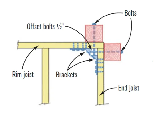

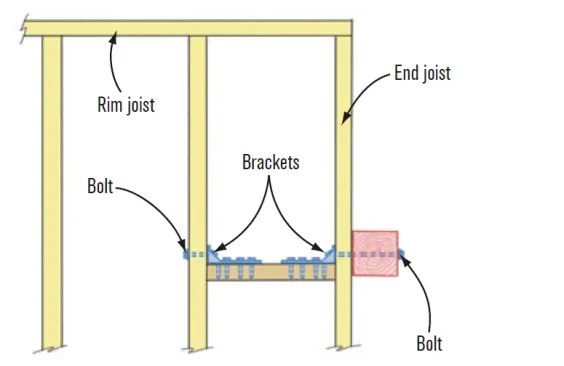

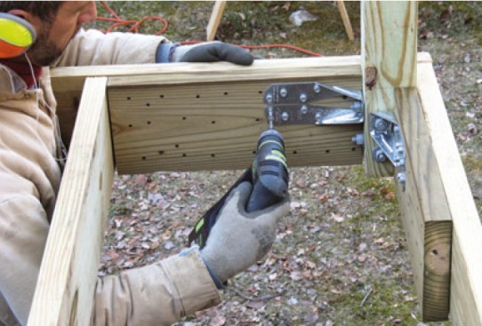

Both the DTT2Z and the DTB-TZ (Figure 4) are designed and tested to create post-to-joist connections that meet the 500-pound load requirement, and both mount to the joist with eight structural screws (included). The only hole you have to bore is the one through the post and rim. I have a hard time finding the USP hardware locally, so I can’t quote a price for it, but the Simpson DTT2Z and a single 6-inch-by-1/2-inch bolt costs me $10.05. Plus, because both Simpson and USP substitute structural screws for the two bolts used to connect an HD2A to its joist, installation labor is much lower. Bolts are still used to connect the hardware to the post and the rim. The length of the bolts will vary with the conditions; in some cases, you may have to use threaded rod. (One source for hot-dip-galvanized threaded rod is Jamestown Distributors; 800/497-0010, jamestowndistributors.com.)
One caveat: Although the IRC calls for the top of guards to resist force in “any direction,” common sense holds that the outward direction is the highest priority, so the metal connector hardware is installed at the top bolt location where it best resists outward force. The bolts are placed 2 inches down from the top of the joist except at corners where two bolts cross one another. In those cases, I locate one bolt 2 inches down and the other 2 1/2 inches down.
None of the hardware mentioned above will provide the required strength if the joists are smaller than 2×8. With shallower joists, the post-lever is too long relative to the distance below the fulcrum (the point where the bolt joins the hardware to the post), and there’s no way that I know of to meet the 500-pound load requirement using 2×6 joists. And if you use a railing much higher than 36 inches, the longer lever arm may also put you out of compliance (See Question & Answer)

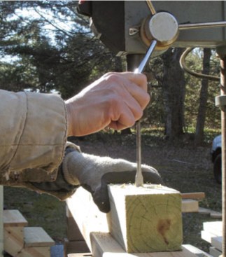

I bore enough holes through the posts on even a medium-sized deck that it’s a time savings to systemize the task. Also, holes bored with a hand-held drill can drift off line, which is fine if you don’t have to hit a target on the other side, but when mounting hardware, you can’t be off much. And when bolts cross over one another inside a post as they do on some corners, there’s no room for error. I address all these conditions by marking the posts with a pattern jig and boring the holes with a small drill press.
A small drill press set up with a plank to support the posts makes for fast, accurate, and nearly effortless boring.

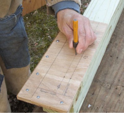

The pattern jig is a piece of 1/4-inch plywood with bottom and side stops made from scraps. The bolt holes in a post should be 2 inches above the bottom of the joist and 2 inches below the top of the joist. In the jig, I drill a 1/8-inch hole 2 inches up from the bottom stop, and then others at 5 1/4 inches for 2x8s, 7 1/4 inches for 2x10s, and 9 1/4 inches for 2x12s. I drill two sets of holes in the jig, one 1 3/4 inches in from the side stop so they center on the post, and the other 2 3/8 inches off-center for bolts in blocked-out brackets. This dimension might differ if you use USP or DeckLok brackets.
I mark the posts through the jig with a nail set and a hammer. It’s faster than a pencil, and a deep dimple is easier to see than a tiny pencil dot. Also, the drill point centers on the hole nicely. When marking posts with cross bolts, I simply tack a 1/2-inch block to the bottom stop and the holes are automatically adjusted. A jig lasts a whole deck building season (or until it gets lost).
The advantages of boring with a drill press more than make up for the effort of hauling it from the truck. The holes are square to and straight through the posts, and later will become the guides for boring through the rim joists. A production boring station takes five minutes to set up and I can drill through post after post in no time. Working at a comfortable level and letting the machine do the work is a whole lot easier than contorting and pushing to bore holes by hand. I set the drill press downstream from the miter saw so a couple of guys can work a production line for efficiency.

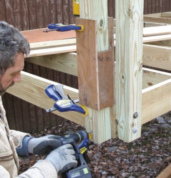

Another set-up makes drilling through the rim joists a breeze too. While you could just clamp a post to the rim joist, it’s faster and easier to have a positive stop that sets the post at the proper height. For that, I make a 3 3/4-inch ID box tube out of wood scraps. Two opposite sides of the tube are about a foot long and the others are 16 inches. The long sides are the squeeze point and the bottom serves as a positive stop.
A sitebuilt jig ensures accurate hole placement. The author marks the hole locations with a nail set.
To use it, I mark a line on all the posts 37 inches down from the top. Then I slide the box tube down the post, align the tube’s bottom with the line, and squeeze the long sides tight to the post with a clamp. When I first set the post on the rim, its weight is borne by the box tube. This allows me to loosen and tighten the clamps I use to hold the post to the rim without losing the height position. Another clamp holds a level to the post so the whole operation becomes a fast, one-person job.
