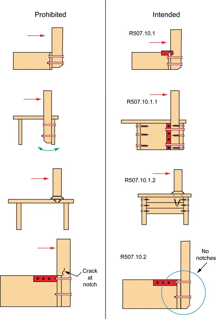

The most notable and obvious guard provisions in the 2021 IRC are in the new section R507.10, Exterior guards, which contains four subsections covering support, posts, plastic composites, and other guards. R507.10.3 simply points back to R507.2.2, where the general requirements for testing and installation of composites are detailed. R507.10.4, Other guards, is specifically meant as a reminder that all types of guards and guard materials are permitted, provided they are installed per the manufacturer’s instructions and in accordance with engineering principles. It is still the authority of the building official to request validation of either of these.
No notched posts. R507.10.2 is one compromise in the code that will make a big difference in reducing the number of dangerously built guards, but without dictating a specific design. Here, 4×4 guard posts are prohibited from being notched at the connection point when the posts support loads at the top. Though this is a common construction method in many parts of the country, time and research has proven that in most applications, a notched post cannot support the minimum design loads. It’s important to note that this prohibition was specifically written to address only the connection location. A turned 4×4 or one notched within its length is not universally prohibited.
Continuous load path. The most significant new provisions are in Section R507.10.1, Support of guards. A clear expectation is made in this section that “guard loads shall be transferred to the deck framing with a continuous load path to the deck joists.” This requirement is general enough to allow for a variety of connection methods, yet descriptive enough to address the most problematic issue in guard construction: a connection only to the outer member of a deck frame.

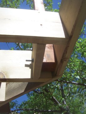

Two more subsections further address posts connected to the side of a deck frame and those connected to the top. When connected to the side, the post can be on the interior or exterior of the frame, but it must be connected to the adjacent joists in a manner that prohibits rotation of the joist or beam it is directly attached to. This can be achieved with a variety of metal hardware or by using blocking and standard fasteners. The IRC doesn’t require a specific load to be resisted at this connection, as determining such a load would depend on many variables in the overall guard design that are not easily verified with engineering or product testing. When blocking and fasteners are used, the new provisions do make it clear that fasteners in end grain cannot be relied on for withdrawal resistance.
The goal of the new guard-post provisions in the 2021 IRC is to avoid relying on fasteners loaded in end-grain withdrawal as part of the critical guard-post load path. Here, where blocking for the bolted guard-post connection is fastened to the joists, the end-grain connection should be reinforced with additional nails, structural screws, hardware, or some combination of all three.
For connections to the top of the frame, the expectations are similar. Posts can be connected over the top of the decking, but the connection cannot be to the decking alone. Instead, it must be made to the frame or to blocking in accordance with the manufacturer’s instructions. This connection method is intended only for designs using a manufactured and tested product for which there are installation instructions and that has been evaluated for load resistance.
