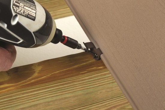

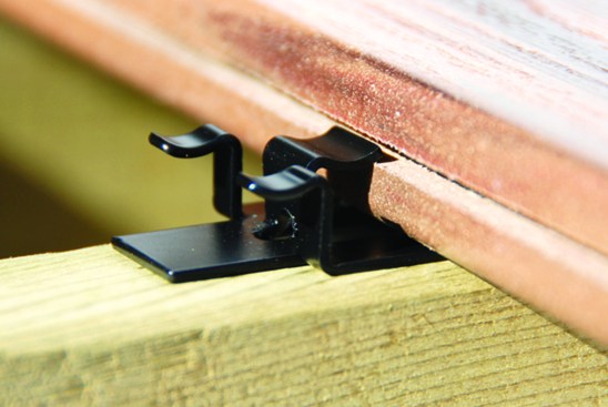

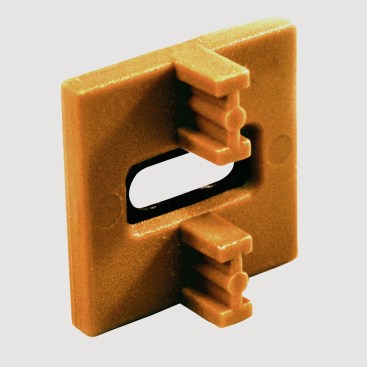

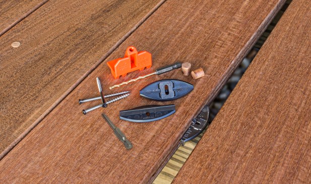

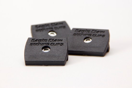

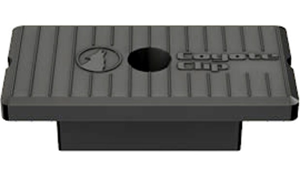

Some Clips Fit Into Grooves
The EB-TY clip, invented by New Jersey builder Harry Eberle III in the 1990s and now offered by Simpson Strong-Tie, is representative of a common type of clip that fits into a slot in the edge of the decking. These slots can be molded into the decking when it’s manufactured, or cut on site with a router bit or biscuit joiner. A screw fits into a hole in the clip and is driven at a 45-degree angle into the joist (with some clips, the screw is driven straight down into the joist). The clip automatically sets the distance between boards.
To accommodate clips, most brands of composite, capped composite, and PVC decking are now available in slotted as well as square-edged versions, and manufacturers are increasingly likely to offer a clip designed to go with their decking. Trex, Fiberon, NewTechWood, and TimberTech all offer their own clips.
Some clip manufacturers offer several versions of a particular clip, all engineered for different materials or gap spacing. DeckWise, for example, offers four styles of its Ipe Clip, with board spacing ranging from 3⁄32 inch to 1⁄4 inch. Clips are made in both plastic and metal versions. Some brands combine both materials. The Ipe Clip, for example, is mostly plastic but has stainless steel inserts designed to strengthen the deck-to-framing connection and eliminate the risk of driving the screw all the way through the clip. Simpson Strong-Tie has added that feature to some of its EB-TY lineup.
This hardware also can be used on square-edged boards after you slot the edge yourself with a biscuit joiner or router and slot cutter.
In use, these basic clips are simple to install, but not lightning fast. Let’s say you’re installing hardwood decking that doesn’t come with a slot in the edge. There are five steps: Slot the edge of the board, drill a pilot hole, insert the clip in the slot, put a screw in the hole of the clip, and drive the screw. Make it six if you add a bead of construction adhesive to the top of the joist first, as one manufacturer recommends.
Another consideration is size of the gap between deck boards. Clips whose screws are installed at a 45-degree angle allow tighter spacing between deck boards; when screws go straight down, the gap between boards must be big enough to accommodate the screw head.

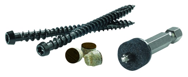

Screw and Plug
If your clients want concealed fasteners yet don’t like the look of edge clips, decking can be screwed directly to the framing, without extra hardware. The fasteners will be hidden when you drill a counter-bore and add a plug to cover the screw head.
If you’ve got time to burn, the cheapest way of accomplishing this in wood decking is to make the plugs yourself with a plug cutter and a drill press. Cut the plugs from the same material as the decking, then glue the plugs in with a waterproof glue (like Titebond III) and use a block plane, belt sander, or chisel to trim the top of the plug flush with the deck.
A much faster and simpler approach for composites, capped composites, and PVC decking is to use the Cortex system. It consists of plugs manufactured from the same decking material you’re using, a setting tool that sets the screw and creates a hole for the plug in a single step, and a screw. The plugs are hard to spot after they’ve been set.
Cortex fasteners are commonly used on perimeter boards and stairs where clips are awkward, if not impossible, to install. Jason Davoll, building products senior manager at Azek, said predrilling is a good idea for top-down screws on very dense wood and TimberTech capped composites; on a less-dense board such as Azek, a cellular PVC, no pilot hole is needed for Cortex fasteners.
“Everyone gets it,” Davoll said of the Cortex system. “Some builders have a resistance to using a clip-style system—Cortex gets past that because it’s still a straightforward, top-down installation and covers up the screw with the same material as the deck.”
Cortex screws and plugs are less expensive than many clips (Amazon sells a kit for an Azek gray decking that works out to 77 cents per square foot of decking), and according to Davoll, damaged decking installed with Cortex screws is relatively simple to remove and replace. Plugs can be pulled out, and the screws backed out, allowing removal of a single board without disturbing its neighbors.

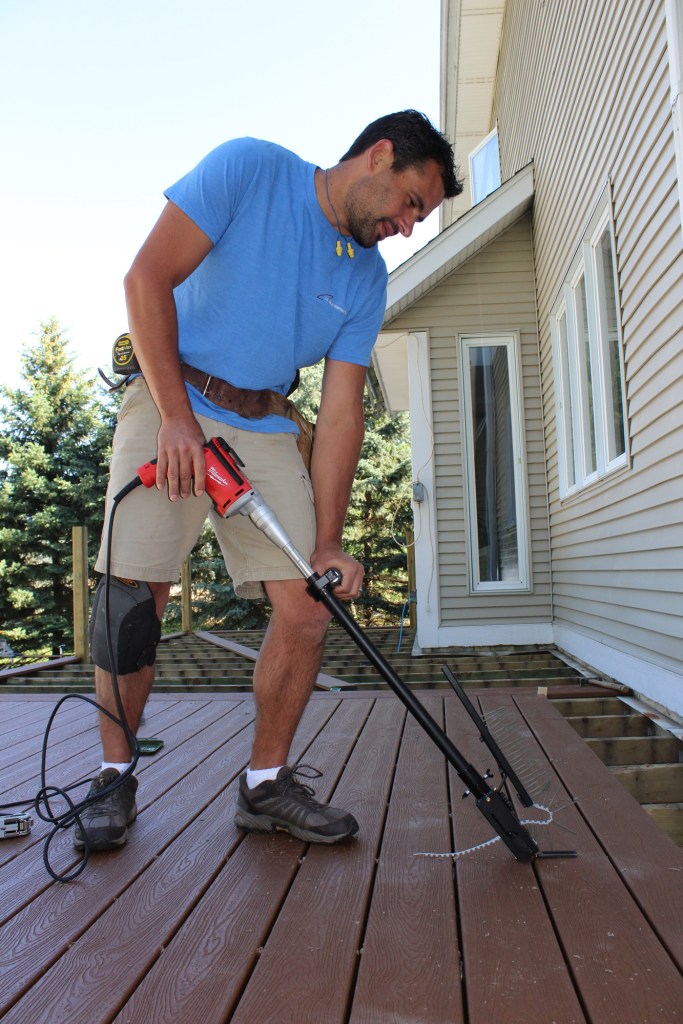

The Camo Option

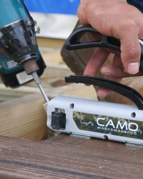

National Nail’s Camo Edge Deck Fastening System consists of a tool that clamps over a deck board and has a recess to hold one or more screws at the correct angle for installation (the company makes several versions of the tool, including the Edge Pro, which is used from a standing position). The installer loads the screws and uses a drill/driver to drive the fastener into the edge of the board. The company said the tool and fasteners can be used on treated lumber, hardwood, composites, cedar, and PVC decking with grooved or solid edges.
Camo Edge Pro Collated System
Camo Marksman Edge Pro Dual Screw Guide
Once you buy the tool, fasteners are the only continuing cost. Robert Lascelle, the owner and president of My Deck LLC, in Flemington, N.J., said that amounts to about 20 cents per square foot of decking. Screw heads disappear beneath the surface of the decking, but the holes can still be seen.“If you’re looking for it, you can see it,” Lascelle said, “but in the same sense, you can see a big black clip in the middle of the board, which you don’t see here. There’s not a perfect system out there.”
No other system offers the same price advantage, Lascelle said, and the Camo also makes it relatively simple to replace a single deck board in the middle of the field. “It’s very easy to change it,” he said. “You can actually back the screws out. There’s no other fastening system out there like that—it can be done, but it’s much more of a headache.”

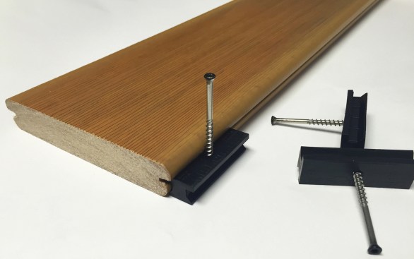

Most deck-clip options let builders work from the surface of the deck, but there are a few that require screws be installed from below. Suredrive’s Shadoe Track and the Deckmaster Bracket from Grabber Construction Products are two examples. In both cases, the track is fastened to a joist, and the deck boards are attached from below with screws driven through holes punched in the track.
Shadoe Track Under-Deck System
Invisi-Fast Polycarbonate Fastener
Unless you have access to the deck from below, using either of these means getting down on hands and knees and awkwardly running screws upward. But as Bobby Parks pointed out, a bigger potential problem with this hardware is the higher risk of screw pull-out when used with wood that has a tendency to cup. The design limits the length of the screw to something less than the thickness of the deck board—a fraction of what’s possible with a top-down fastening approach—and the head of the screw isn’t seated on the deck board, but on the hardware.

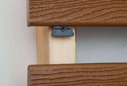

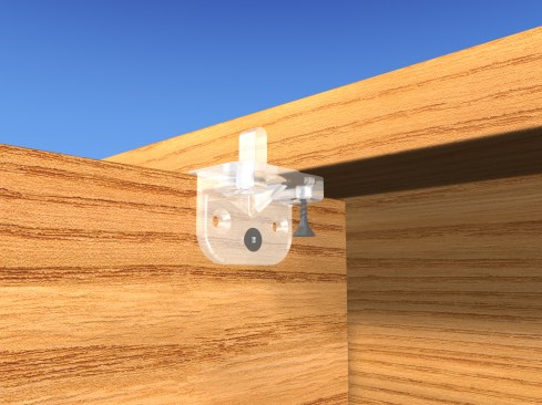

Another option on decks with access from below is the Invisi-Fast. One version of this plastic clip, the Original, is screwed to the side of a joist. The installer attaches a deck board by running a screw upward through a hole in the clip into the bottom of the board. (The company also makes a clip, designed for grooved boards, that’s installed from above, as well as a Plus fastener that does not require under-deck access.)
Invisi-Fast said the plastic used to manufacture the clips won’t corrode, and the clips are cheaper than many alternatives on the market (the Original is available for about 72 cents per square foot of decking; $1.09 with stainless steel screws). Invisi-Fast also permits the replacement of a single damaged deck board without removal of boards on either side.

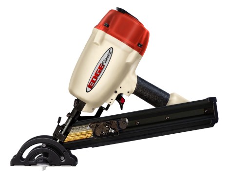

The Pneumatic Approach

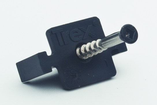

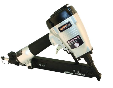

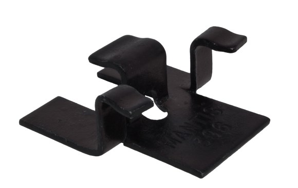

When the speed of installation is a top priority, builders have several pneumatic tools to choose from. FastenMaster’s Tiger Claw system for grooved decking includes a gun that holds a clip in its nosepiece so it can be attached to the joist with a “scrail,” a fastener that’s driven like a nail but can be backed out like a screw. According to the manufacturer, an installer using the tool can put down 400 square feet of decking an hour. Concealoc hidden fasteners from Timbertech are installed with the same gun.
Mantis Trx Clip
Mantis Trx Clip
The Tiger Claw gun holds 33 scrails and a single clip. Jason Davoll said Azek has a second pneumatic installation system, called Fusionloc, that holds 200 scrails and five deck clips in a single collated strip. But the gun is in its “infancy of launch,” he added, and not yet generally available. Another option is the Mantis clip, designed for installation with the RCS Eliminator gun; the gun holds a single clip in an extended nosepiece and a strip of fasteners.
Edgefast Pneumatic Nailer
Tiger Claw Pneumatic Nailer

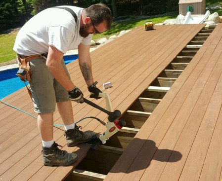

Finally, there are HidFast and Edge-Fast guns. The original HidFast gun, which looks and operates like a flooring nailer, shoots a fastener at an angle into the edge of a deck board. The next deck board is driven with a sledge onto a small leg on the head of the fastener. Glenn Tebo, who developed both tools, said the short leg on the fastener wasn’t long enough to hold pressure-treated pine reliably, so the company developed a second tool, the EdgeFast. It’s equipped with a pivoting base, so the installer shoots the edge of one deck board with a nail, then swings the gun on the base to attach the edge of the adjacent board.
Pneumatic tools are fast, but have a higher up-front cost. The HidFast and EdgeFast are $485 and $385 respectively. The Tiger Claw gun is about $300; the Eliminator about $450. The Fusionloc gun is listed at one online store for $800. Tools like this, however, will be tempting to pros who see high installation speed as essential.
