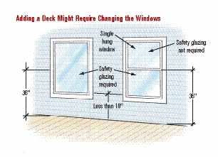

The 2006 IRC requires safety glazing when all four of these criteria are met:1. Exposed area of an individual pane larger than 9 square feet. 2. Bottom edge less than 18 inches above the floor. 3. Top edge more than 36 inches above the floor. 4. One or more walking surfaces within 36 inches horizontally of the glazing. Each pane is considered individually, so it's possible that the bottom pane of a single- or double-hung window would need to be safety glazed, while the top would not.

The completed deck is beautiful and your client loves it. It just needs to pass inspection, then you can move on to the next job. No worries — it’s a simple deck and there shouldn’t be any problems. But when the inspector does the final inspection, he tells you it looks great — except you must “safety glaze” a window on the house.
What? You didn’t do anything to that window, so how are you responsible? I can tell you that you’re not the only deck builder to be surprised by this code requirement. As an inspector, I often see designs that don’t account for the locations of the existing windows.

A glazing location may be considered hazardous by the IRC if it is within 36 inches, measured horizontally, of a walking surface . A deck is exactly that — a walking surface — and if it adjoins the house, it’s likely to be within 36 inches of a window or glazing. When that glazing meets all the criteria in the illustration below, it must be safety glazed.
There are a couple of exceptions that allow regular glazing. The first is for “decorative glass,” defined by the 2006 IRC as: “A carved, leaded or Dalle glass or glazing material whose purpose is decorative or artistic, not functional; whose coloring, texture or other design qualities or components cannot be removed without destroying the glazing material; and whose surface, or assembly into which it is incorporated, is divided into segments.” In short, “stained glass.”
The other exception applies if a protective bar, a minimum of 1 1/2 inches thick, is installed on the accessible side of the glazing. The bar must be at a height between 34 inches and 38 inches above the walking surface and cannot contact the glass when a 50-pound per linear-foot horizontal load is applied.
Before relying on any code exception, always consult the governing building department, as exceptions can be subjectively interpreted.

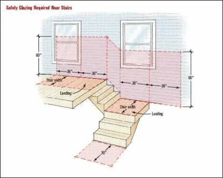

The 2006 IRC calls for safety glazing when glazing is "adjacent to stairways, landings and ramps within 36 inches horizontally of a walking surface when the exposed surface of the glass is less than 60 inches above the plane of the adjacent walking surface." While we think of landings as being in the middle of a run of stairs, the IRC requires a landing at the top and bottom of each stair, even if it's a portion of the deck or the lawn. Such landings must extend at least 36 inches beyond the stair. The code further requires that glazing be safety glazing if it is within 36 inches of the landing, measured horizontally, and within 60 inches measured vertically. Effectively, that means windows within 6 feet (36 inches + 36 inches) of the top of a stair might need safety glazing.
Stairways
Stairs are inherently dangerous; people slip and fall on them. Because of this, safety glazing must be used when the glazing is adjacent to a stairway.
The 2006 IRC calls for safety glazing when glazing is "adjacent to stairways within 60 inches horizontally of the bottom tread of a stairway in any direction when the exposed surface of the glass is less than 60 inches above the nose of the tread." There are two important aspects of this section to pay attention to. First, it clearly states "any direction." The literal words of the code are the requirements and could be enforced as such. Despite how irrational, even glazing within 60 inches horizontally behind and below the stair would fall into this area. Second, the 60-inch height is measured above the nose of the tread, so you must include the height of the first rise when measuring off the floor or landing at the base of the stairway. For example, consider steps with 7-inch rises: If you measure horizontally 60 inches from the nose of the last step, as specified by the code, you actually need to measure 67 inches vertically from the landing below to determine the need for safety glazing.
The IRC defines stairways as any elevation change of one or more risers, and includes landings in its definition. All stairways, even those consisting of a single step, require top and bottom landings that are the width of the stairs and extend at least 36 inches in the direction of travel.
The landing does not have to be a separate component; it may be a portion of a larger walking surface. If the stairs ascend directly to the main area of the deck, the portion of the deck that is the width of the stairs and runs 36 inches beyond the top nosing, measured in the direction of travel, is considered the “landing” (see illustration, above).
Another hazardous location with regard to glazing near stairs is the area within 60 inches of the bottom of the stairway (see illustration).
There are exceptions to these rules, also. As in areas adjacent to walkways, protective bars can be used to protect glazing within 36 inches of stairs and landings, unless the glazing is within 60 inches, measured horizontally, of the bottom tread.
Additionally, another exception implies that safety glazing is not required if the glazing is more than 18 inches beyond a guard (a wall or railing at least 36 inches high, with balusters or infill spaced at most 4 inches apart, all of which must resist a 200-pound load from any direction). This exception can be applied to both hazardous stairway locations, but it isn’t clearly presented, and I recommend you check the local building department’s interpretation of it before using it in your design.
Glazing used in all guardrails — both level and on stairs — must also be safety glazing.
