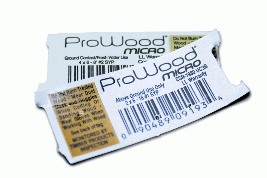

Preservative retention values for Ground Contact standardized uses are typically found in 4x4s, 6x6s, and larger structural posts, so they can withstand a higher decay potential and termite attacks when placed into the ground. Both types of treated lumber products are labeled with identification end tags indicating which retention value they have and which use they are suited for.
The American Wood Protection Association (AWPA) standards are the only standards for treated wood directly listed in the IRC and IBC, so the first thing to do is look for “AWPA” and the applicable standard, usually “U1” on the end tag. [Editor’s note: Other industry standards may be acceptable, but that’s up to the building official’s discretion.] You should also look for the appropriate AWPA Use Category for the application, such as UC3B or UC4A. Note that in most cases, Ground Contact treated posts can be used in an Above Ground Use application.

•UC3B Above Ground Exposed — Treated wood materials used in exterior construction that do not come into contact with the ground. Materials do not require an additional exterior coating; however, these materials may be finished to achieve a desired aesthetic appearance. UC3B materials are used for a variety of applications in either horizontal or vertical positions such as decking, sills, walkways, railings, and fence pickets.
•UC4A Ground Contact General Use — Treated wood used in contact with the ground, fresh water, or other situations favorable to deterioration. Examples are fence posts, deck posts, guardrail posts, structural lumber, and timbers.
• UC4B Gound Contact Heavy Duty — Wood and wood-based material used in contact with the ground in severe environments and in climates with a high potential for deterioration, including permanent wood foundations and wood used in salt-water splash zones.
