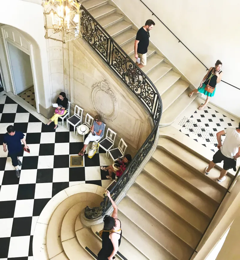

This stairway at the Rodin Museum in Paris features what the author describes as a “French landing.” The landing, as well as the treads above and below the landing, curve towards the guardrail. This allows for a smooth handrail and a landing depth equal to the tread depth along the walkline.

My first encounter with what I’m calling a French landing was at the Rodin Museum in Paris (photo above). Notice that the two treads below the landing, the landing itself, and the two treads above the landing have curved ends, creating extensions of the treads and landing reaching towards the guardrail.
In the stretch-out view of these stairs (above), the handrail, which follows the line tangent to the tread nosings, does ease up and then eases back down in a subtle S-curve, but it’s very gradual. There’s no need for a landing newel and certainly no need for drastic measures like a gooseneck.
The curved landing and treads also allow a perfectly even stride for a person following the walkline.

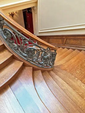

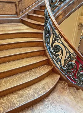

A stairway at The Breakers–a Gilded Age mansion in Newport, R.I., that is now a museum–has landing depths along the walkline equal to the tread depth.
Brian Campbell
The two landings occur at different elevations that function as two quarter-turn stairs to complete a full half-turn.
A similar set of stairs exists at The Breakers—a Gilded Age home built in Newport, R.I., by Richard Morris Hunt for one of the Vanderbilts. This is one of two stairs with French landings I’ve been on that Morris designed. He was the first American to be admitted to the architecture program at the École des Beaux-Arts in Paris and he went on to become one of the founders of the American Institute of Architects (AIA). He was a prolific designer of monuments, churches, and public buildings throughout the U.S. during the late 19th-century, but he is especially known for the elaborate mansions that he built for the Vanderbilts, the Astors, and other scions of wealth and power. These homes set the bar for what was considered “high-design” for residential buildings until Modernism started to take hold at the turn of the last century (when Morris’s style fell out of fashion). He used the French landing in many of these buildings.
At The Breakers, the stair completes a half-turn, but it is essentially composed of two quarter-turn stairs with two separate landings at different elevations, each making a quarter turn. Here, too, the handrail has a very subtle S-curve in elevation that allows the user to keep a hand on the rail without repositioning it at any point. And the treads and landings maintain consistent depth along the walkline so the user can maintain a consistent stride.
