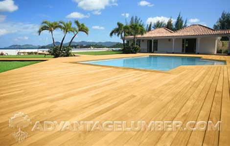

Ipe has earned its status as the beautiful bulldog of the decking world, withstanding serious wear and tear on the Atlantic City Boardwalk and on Treasure Island in Las Vegas. A dense hardwood, it is naturally resistant to rot and decay. In fact, it’s so dense many deck builders might characterize it as resistant to nails and screws too, but many customers seem to be willing to pay the upcharge for both the material and the labor. There are hardwoods other than ipe as well. Advantage Trim & Lumber Co. offers Tigerwood, for example, long familiar to woodworkers as goncalo alves (Figure 1). Others include garapa (see photo, above) and cumaru.
Figure 1. Tigerwood decking is Advantage Trim & Lumber Company's less expensive alternative to ipe. Tigerwood has a 25-year (or longer) life span, is Class A flame retardant, and is resistant to scratching, splintering, and cracking, says the company. (877/232-3915, www.advantagelumber.com)
