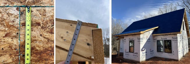

Roof. Fortified Roof, as the name says, focuses on keeping the home’s roof intact during a storm event. It requires nailing off the roof deck every 4 inches along panel edges and 6 inches in the field with 8d ring-shank nails, as well as “locking down” roof edges by nailing down a minimum 26-gauge drip edge over the underlayment. This must be paired with a fully adhered starter strip or 8-inch-wide bed of mastic on eaves and rakes. The roof deck must be sealed with tape or with a continuous peel-and-stick underlayment. (For details on achieving Fortified Roof, see “Toughening Up the Roof,” 2/19).
Fortified Gold requires first meeting Fortified Roof specifications, including a tight nailing schedule for roof sheathing (left), using a minimum ⁷/16-inch sheathing panel (center), and a sealed deck, which the author accomplished with continuous peel-and-stick membrane (right).

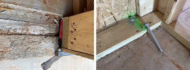

Foundation to wall. A good example of this integration occurred early on. When we designed the slab foundation, we planned on using our typical perimeter insulation detail: We use an 8-inch concrete block (CMU) for the stem wall with a 4-inch CMU for the top course, set to the outside to create a step that supports the slab ledge. Our subslab insulation comes across the bottom of this step and turns up on the inside of the 4-inch CMU. When we build our 2×6 walls, we set them back 11/2 inches from the outside of the stem wall so the wall ends flush to the outside of the foundation after they are sheathed and continuous wall insulation is installed on the walls. That puts our bottom wall plate over the insulation that turns up the 4-inch CMU along the perimeter.
Typically, we use 1-inch XPS foam for our subslab insulation, but because we were aiming at a higher level of thermal performance on this job I switched to 2 inches of perimeter insulation. But that reduced the concrete area we had to anchor into. For a bit I thought we might not be able to anchor the plates properly to the foundation. Fortunately, we were able to use two screw-in Titan anchors, one on the CMU wall and one into the slab, to get a solid uplift connection.
Visible in the center of a door opening (left), the 2-in. perimeter slab insulation left just a sliver of the slab under the wall plates for securing the plates with two Titan anchors (right).
We were able to use Titan anchors for anchoring the plates around the entire house. This was nothing new. We have been using Titans for a while. They are so much easier to place than anchor straps because we’re able to install them as we attach our sill plates, rather than before the foundation pour.

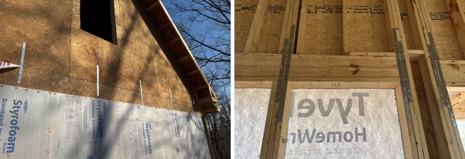

The difference with the anchors for meeting Gold is that we had to get these and all the other uplift connections and nailing schedules inspected before we started installing the continuous insulation and the housewrap that served as our primary air barrier. We did schedule the inspections with the evaluator, but then our start date got pushed back due to supply chain issues and pricing uncertainty last summer. This set up a chain reaction of delays. In the future we will know to build in extra time to accommodate such uncertainties.
Gable-end trusses were tied to the gable-end walls with metal straps. To meet Fortified Gold, the size, frequency, and nailing needed to be specified by an engineer.

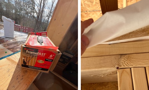

Wall to roof. For the top plate to truss connection we relied on FastenMaster’s FrameFAST screws instead of metal hurricane clips. In most parts of the house, we were able to screw these up through the wall plates from below. Where we had LVL headers we needed to come in from above, but, overall, these screws are much easier and faster to install than metal hurricane ties. The material cost is higher for the screws than for ties, but the labor savings is considerable.
Top plate to plate connections were made with FrameFAST screws.
Also, for our primary air barrier we ran the Tyvek over the top plate, leaving a flap on the inside that we attached to the ceiling drywall with wide-spray foam sealant. This detail would have been nearly impossible with hurricane ties. In theory, you can install ties over the housewrap, but the number of penetrations would seriously compromise the air barrier.

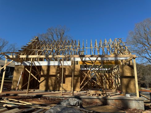

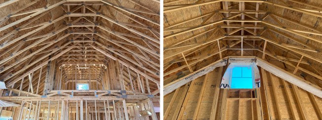

Trusses. The main living room and kitchen area of the house has a vaulted ceiling so we used raised heel scissors trusses. The raised heel gave us the vertical space we need to get full insulation thickness over the exterior wall plates. Without that space, insulation can get compressed at the eaves and lose its effectiveness, something we were absolutely trying to avoid, especially since this project is aligned with net-zero performance goals.
The truss system over the unvaulted portion of the house included a built-in floor system—what I refer to as a “bonus truss.” In this section, the bottom of the trusses is formed with parallel chords that create a floor structure integrated into the attic truss above it. This floor structure provides more room to run our mechanicals—ductwork, plumbing, electrical—without having to cut any holes or drill into structural members, which, of course, is especially problematic with trusses.
Using a bonus truss for the upstairs living area provided one simplification in meeting Gold: The structure acts like a one-story home. If we had stick-framed a more typical story-and-half to gain the upstairs living area, we would have had to install a lot more mid-floor connections (metal straps) to tie the two stories together.
Scissors trusses over the great room (to the right) bear on 10-foot walls. The bonus trusses (on the left) sit on 9-foot walls.
The "bonus" trusses have a parallel-chord floor structure where mechanicals will run (left). Horizontal bracing ties the gable-end truss to the next two scissors trusses (right).

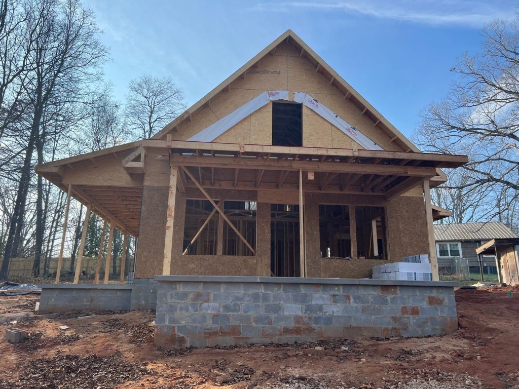

Attached structures. On this project we have two porches facing south and east that provide critical shading to reduce summer cooling loads. To meet Gold, the connections of the porch posts to the porch slab were included in the engineering design. These were easily done with metal post anchors. The trickier details involved the porch trusses, which tied back to the main house truss system.
In the vaulted ceiling area, the walls are 10 feet tall, and in the area we have the bonus trusses the walls are 9 feet tall. The porch spans both wall heights but the porch roof ceiling remains level across this distance. To get all these areas to align, the porch trusses that bear on the 10-foot wall had to drop down one foot on the exterior side to maintain the level porch ceiling. This drop-down portion of the truss also had to bump out an inch and a half so that we could slide our wall sheathing and continuous insulation up onto that 10-foot wall behind that drop down of the truss. It was a bit of a booger of a detail that required close communication with the framers.

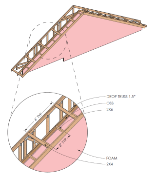

The author relies on isometric drawings, such as this one of the rake overhang detail, to better communicate plan details to installers.

In addition, we have begun to build a library of isometric details that better show complex or unusual details that are a departure from how the framers normally do things. An example is the isometric (see facing page) of the rake overhang detail. Since we’re not in a hurricane zone we don’t need engineering on the reinforced soffits. But we have devised a rugged detail that involves more than just toenailing 2×6 blocks to the gable end to support the rake overhang. Our detail relies on a gable-end truss that’s held down 1½ inches so we can slide a flat 2-by member over the truss and tie back to the first full truss. We print the isometrics on waterproof paper and collect them in a binder that we can hand to subcontractors. The isometric drawings help explain details much better than a page or two of section views buried in the plans.

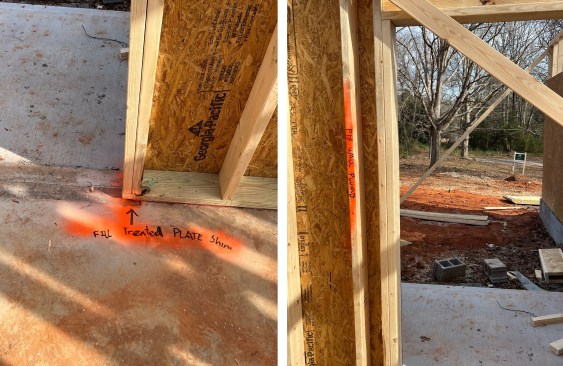

An additional communication step and quality control process we have devised involves “tagging” and marking out critical framing connections with fluorescent orange spray paint and a Sharpie (see photo below). We tag anything that needs special attention by the framers and write on it what needs to be addressed. We also mark out the rough opening sizes at doors and windows. We start tagging and marking up the frame before the framers are done, and we tell them not to freak out about all the orange. It’s not meant to be anything punitive; we’re just being clear and asking them to address each issue when they’re working in that area. Once an item is addressed, we paint it white. This strategy proved especially important on this project to ensure we had all the engineered connections properly resolved before inspection.
