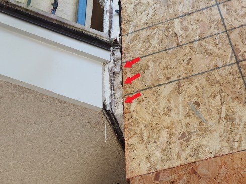

Vertical grooves. Several of the systems use foam base sheets with vertical channels cut into the foam facing the wood wall. Water can drop down in the channels and drain out the bottom of the system.
Someone should have explained that to the crew that installed the foam board on a house we stripped and re-stuccoed when the EIFS failed in several areas. They ran the channels up and down on the main parts of the walls, but for unknown reasons, they ran the channels horizontally at the rim-joist level all the way around the house, totally blocking the drainage at every level.

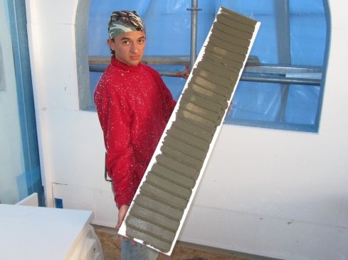

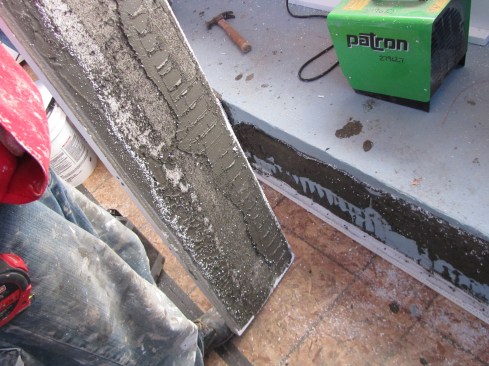

Vertical adhesive. Another style of drainable EIFS uses ordinary, flat foam boards, but they’re adhered to the wall with a thick adhesive applied with a notched trowel. The idea is to make vertical drain channels between the beads of adhesive.
On our first install with this system, I watched a very skilled troweler carefully float out a dip in the wall, then scratch the channels in the last layer of mud. However, we had apparently failed to communicate that the channels had to be vertical because he elected to run them horizontally in this area, probably more to do with how he had to stand while working on it. We took advantage of this learning moment to reiterate to the entire crew that the vertical channels were a key part of the install, and they were happy to do it correctly.
I think we got that job done right, but I still don’t love this system. Even if the installers are on board with the concept, it’s too easy to squeeze the adhesive beads flat so they cover nearly the entire area, leaving only tiny drain spaces—or worse, to inadvertently fail to line up the gaps between boards, which again will completely block the vertical channels.

Drainage channels (arrows) were installed horizontally at the band-joist area on this house, blocking the vertical channels above. (We had already replaced the sheathing visible here, since the trapped water had rotted out the original OSB.)

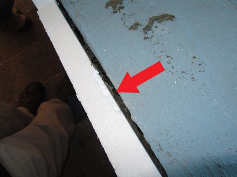

In this view from above of what should be an open drainage space (arrow) between the white EPS board and the blue substrate, it’s apparent that adhesive has filled the whole space.
Click to enlarge
We had the crew remove the board, revealing that the vertical channels were blocked by the additional adhesive used to flatten a dip in the wall.

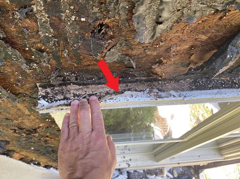

Drain exits. Another issue we’ve seen is where vertical channels are all run properly, but the exit path is blocked off. On one house, metal head flashing was installed above every window and door, which should have directed draining water out. But, someone had very carefully caulked above the flashing, completely sealing any draining water into the wall. (This may have been a different crew or even a later caulking replacement job, but either way, it blocked the drainage.)
We had been working on the house because of a persistent leak at a bad roofing connection. Water in the drain spaces was blocked at the window below and could only soak into the header and seep around the sides of the window, where it caused further damage.
Click to enlarge
The heavy bead of sealant on top of this window head flashing blocked the drain path from the vertical channels above the window (arrow).

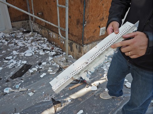

Another house had a plastic track installed at the bottom of the EIFS. The weeps in the track were the outlet for the drain channels on the walls, but the small weep holes were blocked by caulking installed between the track and additional EIFS installed on the foundation wall below. Water soaked into the sheathing in the area of the track.
It should be noted that as with other types of draining systems, long-term, repeated water entry will eventually cause damage even with properly installed WRBs and drainage gaps. I’ve seen this on a few houses. Good wall practices handle small amounts of incidental water, but a consistent source that keeps the drain space wet will result in failure.
Click to enlarge
Heavy caulking blocked the weep holes in this plastic track installed at the bottom of the drained EIFS on the wood walls. The trapped water caused water staining all along the bottom of the wall, visible in the background.
