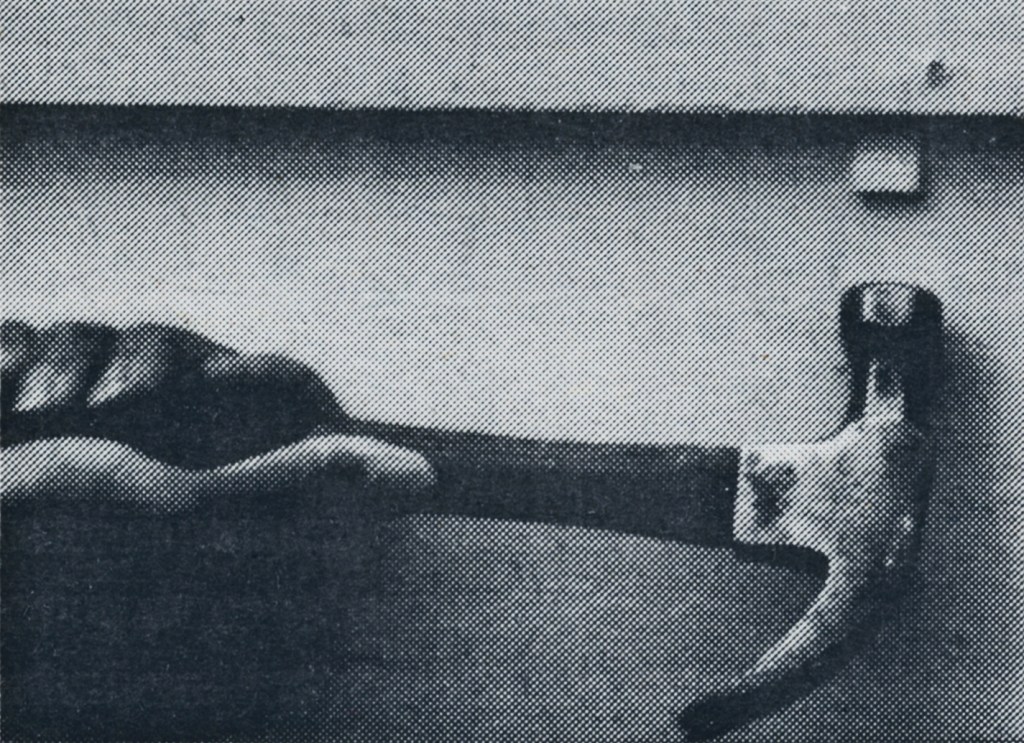

Writing in 1987 in New England Builder (the Journal of Light Construction before it launched as a national publication), Joe Lstiburek contributed what continues to be a highly relevant and important article, "How Insulation Can Peel Your Paint." Here he addressed the specific problem of capillary rise between the overlaps in horizontal siding. For all those who advocate rain screen siding, this is a must-read article, as it's one of the first to identify the problems of increased moisture content in siding applied directly over walls with a low drying potential (a.k.a. insulated walls). Back in the late 1980's when this article came out, a lot of walls were being dense-packed with cellulose insulation and a lot of people were discouraged by how this accelerated the deterioration of their painted siding. It still happens all the time, maybe more now with new homes insulated to current code standards when the siding has no rainscreen or effective drainable house wrap behind it.
Per usual, Lstiburek summed up the issue and the solution succinctly: "The major problem caused by retrofit insulation and insulating sheathing is a reduced drying potential. It turns out not to matter whether the moisture source is interior or exterior. The treatment is the same: Increase the drying potential of the siding by increased drainage, air circulation, and capillary breaks in the siding."
This treatment is now common; we call it a "drainable assembly" or "rainscreen" or "drainable houswrap" - terms, methods and products that have Lstiburek's indelible fingerprints all over them.
