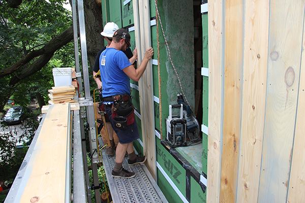

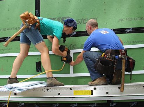

Coastal Connection visited a PlaceTailor jobsite in the Fort Hill section of the Boston neighborhood of Roxbury last week to see the team at work. The project, a two-family spec project backed by an outside developer, is framed and sheathed, and we found the team working on siding. By chance, another PlaceTailor job in the neighborhood was delayed because of weather, so we had the rare opportunity to see all four Project Managers swinging a hammer on the same job. For this project, it's Evan Smith's turn to "run the job." But Smith said, "We have a flat structure. Everybody shares the work and the responsibility. We're a team. It works great for us — we can't understand why anybody would want to do it any other way." But Declan Keefe admits, "It's not for everybody. It does make it hard to hire. You need the right kind of person."

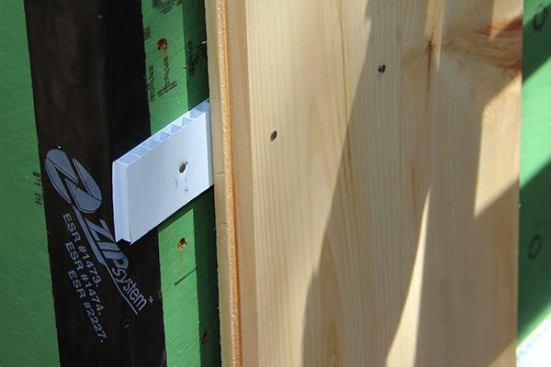

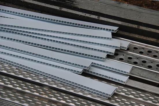

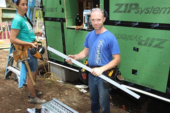

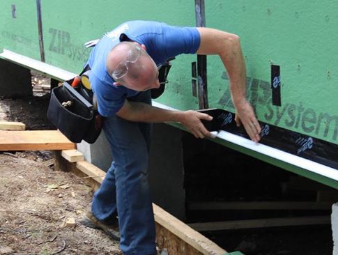

One small example: the rainscreen siding system we saw on the job. It's the brainchild of project manager Travis Anderson: using corrugated plastic "sign board" to make the strapping for the vertical ship-lap board siding. Vertical shiplap is one of the simplest and most economical claddings to apply to a building, but it's a little tricky as part of a rainscreen detail. That's because the strapping required to hold the vertical boards off the wall tends to interfere with the airflow and drainage in the space it creates. Anderson's solution is to get cheap 4x8-foot sheets of plastic board, rip them into strips crosswise to the corrugations, and make hollow-channel strapping. View the slideshow to see the crew install the detail.
