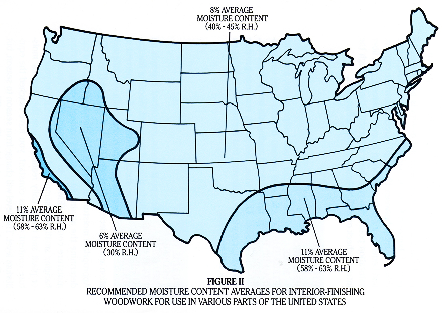

The map above shows the recommended moisture content carpenters should be looking for in finish wood products, especially wood flooring and T&G paneling, in which the incremental change in dimension of one board adds up across a large area, creating an overall change across the entire floor, wall or ceiling.

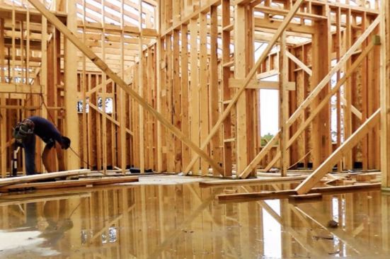

Barring careless handling, the normal building cycle often works to a builder’s advantage: After the building is dried in (roof sheathing and windows installed), the time it takes to rough-in wiring and plumbing holds off the installation of wall and ceiling finishes. If this time is about 30 days in warm, dry weather, conventional wisdom says that wet framing lumber should lose enough moisture so that any additional drying in place will be adequate to prevent callbacks … except that doesn’t always happen. Often the schedule is pushed to much shorter cycle times. That’s OK if you are using KD lumber, but it gets iffy if you are not. In cool, damp weather, or if the framing has been soaked on site, the conditioning period should be extended.
Fast construction schedules contribute to callback problems because the house framing barely has any time to dry on its own before the next stage of construction begins. Such "short cycle" houses are notorious for having lots of drywall cracks and other cosmetic defects after a year of occupancy.
The only sure way to know if you will avoid a lot of nail pops, drywall cracks, and open trim miters is to check the moisture content of door and window headers and floor and ceiling joists with a moisture meter (see “Drying Wet Framing” by Matt Risinger, Jun/13). The Forest Products Lab recommends checking about 10% of the framing as good practice. So, for example, if you have 50 joists, test at least five of them in various locations to get a good sense of the average moisture content.

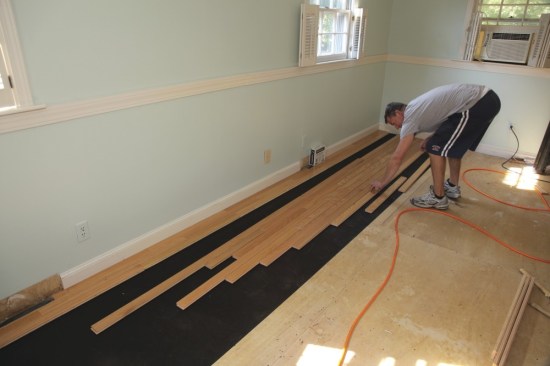

Pay particular attention to the moisture content of wood flooring and wall or ceiling paneling. Small incremental changes in each board add up to big changes over the entire floor, wall or ceiling .
In theory, the small dimensional change across the width of one flooring board can add up to a large change across the entire floor. For this reason, it is recommended that unfinished hardwood strip flooring have a gap of 1/2 to 3/4 inch at the edges. In practice, thick hardwood flooring tends not to move a whole lot if it is nailed off adequately (every 4 to 6 inches is not too much for strip flooring), and if it is installed near equilibrium moisture content and indoor climate conditions are maintained.
Here is the procedure recommended by the Forest Products Lab for acclimating wood flooring and T&G panel products:
  • Break open bundles and expose all sides of the material to the atmosphere inside the structure.
  • Close up the house and increase the temperature about 15°F greater than the outdoor temperature for about three days before laying the floor.
  • If the house is not occupied immediately after the floor is laid, keep the house closed at night or during damp weather and supply some heat if necessary.

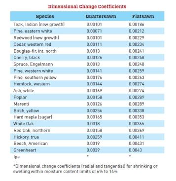

The table below provides some guidelines for selecting woods for stability. There are many factors that go into wood selection, and these are just a few of the characteristics that might affect a carpenter’s decision to use a particular species.
a. Dimensional change coefficients (radial and tangential) for shrinking or swelling with changes in moisture content. (Only applies to moisture changes from 6% to 14%)b. Shrinkage in board width (expressed as a % of the green dimension) as the board is dried from green to oven-dry moisture content.c. The density of wood varies by moisture content. This shows the specific gravity when wood is green.d. Decay resistance may be less for members placed in contact with the ground and/or used in warm, humid climates. Use caution when using naturally durable woods in structurally critical or ground-contact applications. e. Old-growth Teak is known to be Very Resistant; old-growth redwood is Resistant; old-growth eastern white pine and southern yellow pine are Moderately Resistant; only the dark red species of Marenti is Moderately Resistant
a. Dimensional change coefficients (radial and tangential) for shrinking or swelling with changes in moisture content (only applies to moisture changes from 6% to 14%). b. Shrinkage in board width (expressed as a % of the green dimension) as the board is dried from green to oven-dry moisture content. c. The density of wood varies by moisture content. This shows the specific gravity when wood is green. d. Decay resistance may be less for members placed in contact with the ground and/or used in warm, humid climates. Use caution when using naturally durable woods in structurally critical or ground-contact applications. e. Old-growth teak is known to be Very Resistant; old-growth redwood is Resistant; old-growth eastern white pine and southern yellow pine are Moderately Resistant; only the dark red species of Marenti is Moderately Resistant
The species have been ordered from small to large Dimensional Change Coefficients for flatsawn boards, which are more commonly available than quartersawn material. (For a complete list of coefficients for other species of wood, see the table in chapter 13 of the Wood Handbook.)
In general, flatsawn (or “slash-grain”) boards tend to be less stable than quartersawn lumber. Specifically, quartersawn (or “vertical-grain”) lumber shrinks and swells less in width (while flatsawn boards shrink and swell less in depth). Quartersawn wood also tends to be naturally more resistant to water penetrating or passing through it, and it tends to hold paint better than flatsawn lumber.
Dimensional Change Coefficients allow for a quick estimation of how a board of a particular width will move with expected changes in moisture content using the formula:
Width of board x MC change x Dimensional Change Coefficient
For MC change, three is a good default. (This reflects a change from 9% to 6% , or from 11% to 8%, as examples. It’s a good estimate of the fluctuation of wood content in most conditioned homes over the course of a year, assuming they are both heated and air-conditioned with well-sized equipment. If you measure the moisture content of the wood products in a home over a year, you can get a more precise measure of the expected change in width.)
The formula is only approximate, but it can be used for comparing species. For example, let’s examine how 5-inch-wide T&G ceiling paneling in ash and in hickory might perform in service.
Ash: 5″ x 3 x 0.00274 = 0.0411″ (just under 3/64″ per board)
Hickory: 5″ x 3 x 0.00411 = 0.0611″ (just under 1/16″ per board)
Given that we are using a change of 3% in MC, typical for wood in most conditioned homes, hickory would not be an especially good choice for wide boards in an application where each board is butted. For narrower window casing or strip flooring, however, hickory can be a good choice, but you would want to be careful to condition it well (and be precise about it by measuring the moisture content), and to not skimp on fasteners, particularly for flooring.

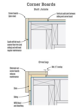

Butt joints are perhaps the simplest way to join two pieces of wood, but for exterior trim, simple is often the best. Alignment is less of an issue with exterior trim; the important thing is to avoid joints opening up and allowing water to penetrate.
Corner boards shimmed out to overlap the ends of siding will last longer than a vertical caulk joint between  the siding and the trim.
For example, with corner boards, fasten the butt joint well (ring-shank nails recommended), and then just place occasional nails in the middle of each face. The goal is to keep the corner closed and allow the swelling and shrinking to show up at the edges near the siding. It’s best if you can pack out the corner boards, as shown at left, rather than relying on a caulk joint between the siding and trim. Caulk will fail much sooner than the trim or siding and need regular maintenance.

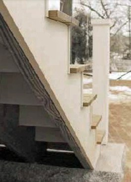

Beware especially wide boards for exterior use, as these will experience the most dimensional change. Fasten in the middle only and design the joints at the edges to move.

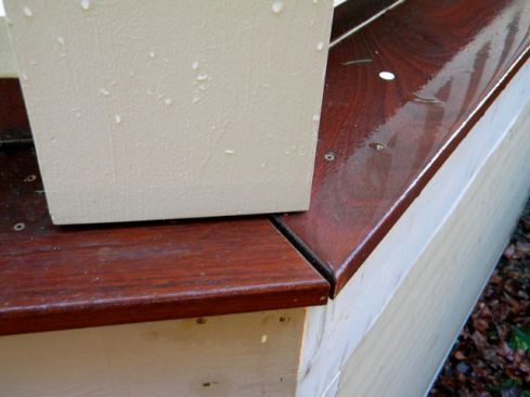

The builder of these decks stairs embraced the fact that the wood would move.
The builder of these deck stairs embraced the fact that the wood would move.
With exterior butt joints, it often works to leave them intentionally long rather than aiming for alignment at corners. The deck stair at right offers a good example. With the treads and risers running past the finish stringer, dimensional change in the wood will be less noticeable.

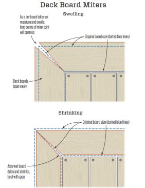

Miters are an attractive way to join wood, but in most exterior applications, they stay tight only when the air temperature and humidity match the day they were installed. When the weather changes, miters tend to open up and allow water to get in and cause rot. Indoors, if you are using unstable woods (those with a high dimensional change coefficient, as shown in the Table above), or using especially wide boards, miters may not be the best choice.
As mentioned previously, when moisture content changes, wood expands or shrinks across the width of the board. This causes the miter to open at the toe (the long points of the cut) or the heel (the short points of the cut). Which part of the miter will open is directly related to the moisture content of the boards when they are installed (see illustration, below). A dry board will expand as it takes on moisture, causing the long points to open up. A wet board will dry out, causing the heel to open up.
The dotted lines on the illustrations show the original board sizes. As a dry board takes on moisture and swells, the long points of the miter joint will open up (top); as a wet board dries and shrinks, the heel will open (bottom).
Exterior conditions that constantly force wood to its minimum and maximum dimensions are especially rough on miters. You can try to control these natural forces using biscuits, screws, or glue. They will work for a time, but chances are they’ll eventually fail. Glues break, material splits, fasteners work loose. The biggest problem is when the two boards twist in opposite directions. This will make even a good miter look bad, with one tip of the miter lifting up and the other drooping down. As the boards deteriorate from weather and water works its way in, the joint will eventually fail.

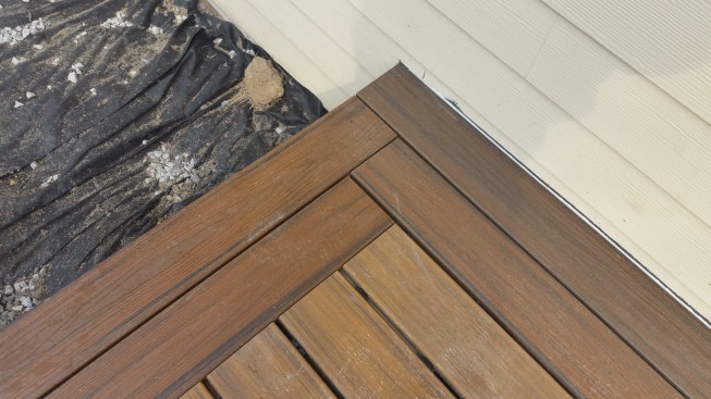

Deck boards are particularly vulnerable to dimensional changes because of the extreme conditions – maximum UV light and rainwater that lays on the boards and soaks in. Because miters in deck boards are usually difficult to keep tight, some builders steer clear of miters altogether, opting for an “anti-miter” approach, as shown in the photo above (see “No-Miter Method for Trimming Corners” by James Baldwin).
A "pillowed" miter by Lavrans Mathiesen.
Lavrans Mathiesen of Portland, Ore., embraces the movement of miters and purposefully gaps them. Any widening of the gap is unlikely to be noticed. He rounds the edges to create a pleasing "pillowed" effect.
Another approach is to intentionally gap the miter with the same-width gap that is used between deck boards. Deck builder Lavrans Mathiesen, of Portland, Ore., further “pillows” the edges of each miter-cut board, rounding over the corners to give the joint a kind of Greene-and-Greene look. It’s a full embrace of the fact that the joint is going to move; the gap conceals the change.
