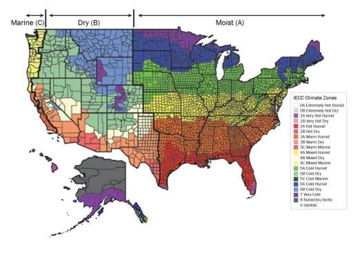

Over a 35-plus-year career of building, renovating, and inspecting houses, I have developed a process to identify moisture sources, assess damage, and develop solutions. It’s largely informed by my location in climate zone 2. While I started out in California, I came to New Orleans (NOLA) in 2008 to observe the destruction of Hurricane Katrina and stayed on to help the rebuilding effort, which continues some 15 years later. In this hot, humid climate zone, any building project must address overwhelming moisture loads—ones much greater than in most parts of the country. Average annual rainfall here is about 60 inches. The relative humidity is often over 80%, the alluvial soil is full of moisture, and let’s not forget hurricanes, which are an ongoing threat.
About 10% of U.S. counties have shifted to a new climate zone, most to a warmer zone. For more about this, see "Understanding the IECC’s New Climate Zone Map" by J.R. Babineau, a building scientist with Johns Manville’s corporate research and development arm.
2021 IECC – International Energy Conservation Code
About 10% of U.S. counties have shifted to a new climate zone, most to a warmer zone. For more about this, see "Understanding the IECC’s New Climate Zone Map," by J.R. Babineau, a building scientist with Johns Manville’s corporate research and development arm.

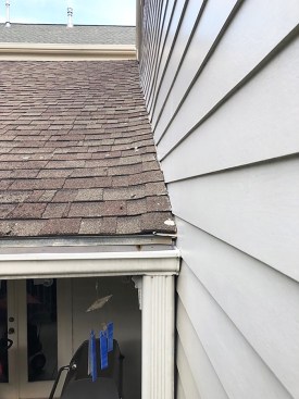

No kickout. This roof-wall intersection should have a kickout flashing to direct runoff into the gutter.

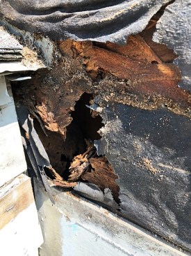

This is what the wall looked like when the gutter and the siding near the roof were removed.

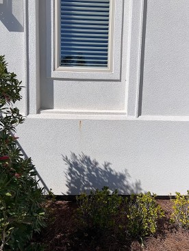

Moisture typically enters a building envelope through transitions and penetrations. Transitions are places like roof-wall intersections, inside and outside corners, and changes in materials, such as a transition from manufactured stone to any type of horizontal siding or stucco. Penetrations include doors, windows, and mechanical service entry points. Think Larry the Cable Guy or anyone drilling a hole through the envelope. But also think about the tiny penetrations, such as cracks and gaps between materials and the minute openings in porous materials, such as stucco or brick. There are obviously other ways moisture can get into a building; however, I like to start out simple.

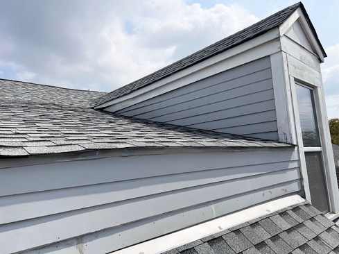

No cut back or step flashing. Siding running down to the roof shingles is wicking water and is at risk of failing. Worse, this roof also lacks step flashing. The combined errors are causing water leaks inside the dormer.

The first—importance of drying—overturns what used to be an accepted building performance rule: “Buildings need to breathe.” We (hopefully) no longer think this way. Now we need to think “buildings need to dry.” That is, building materials can get wet, even soaked, as long as they can dry. Wood, for example, won’t rot as long as it is dry more than it is wet. In my climate zone, wood that remains wet will rot fairly quickly because the temperatures are frequently around 70°F to 90°F—the temperature range that decay fungus thrives in. In other parts of the country, wood rot remains inactive for long periods of cold weather. Frequent wetting and drying might delay rot and mold growth, but it can still be destructive, as the swelling and shrinking with changes in moisture content can open up joints over time and invite more water in where it can seep down into cavities that take longer to dry.

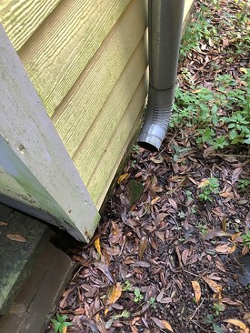

Liquid. We tend to over-focus on rain as the primary source of bulk water, ignoring groundwater and runoff, which can add significant volumes of water to a building.

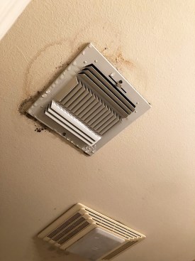

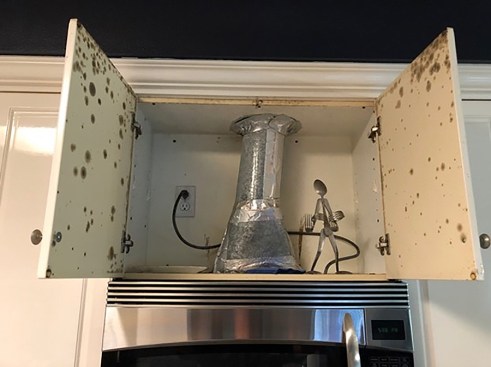

Vapor. Water in vapor form is damaging when it condenses on a cool surface. Condensation “leaks” are a lot less obvious to many in the trades, and many an air leak goes unnoticed because a contractor is looking for a water leak.

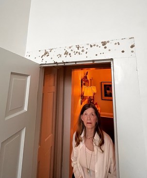

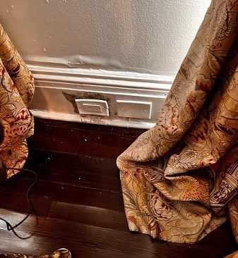

In my climate zone, for example, the outdoor humidity is typically much higher than the air-conditioned interior’s, and so moisture tends to move from outdoors to indoors and condense on surfaces toward the interior (such as the back of a drywall or plaster finish). In heating climates, the opposite is true: The indoor relative humidity in winter is typically much higher than it is in the cold outdoors, so moisture will move from indoors and tend to condense on surfaces near the outside of the wall (such as the back of the exterior sheathing).

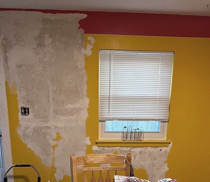

It is helpful to know how long a problem has existed in an occupied home and if there was a triggering event—an equipment change, a renovation or installation of new furniture that altered air pathways, a storm or flood—leading to the problem. To sniff these answers out, it’s often helpful to interview the occupants.

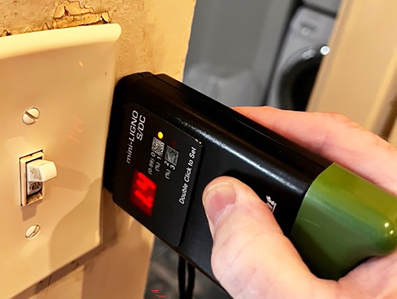

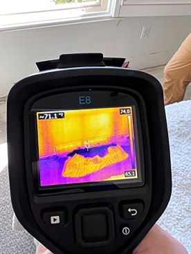

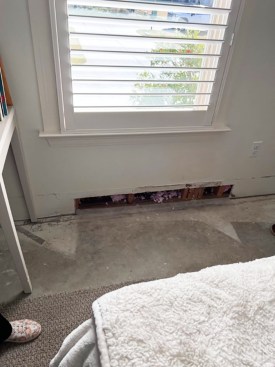

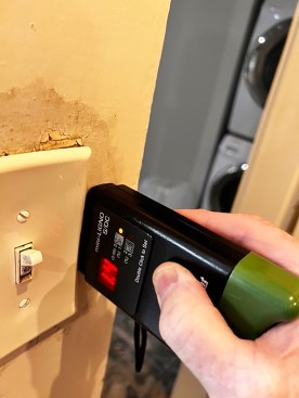

Once I do an initial walk-around, I use a thermal camera to identify leaks and a moisture meter to confirm the moisture levels.

When I first entered the moisture-evaluation world, I was overly confident that my knowledge of construction made me qualified to solve all problems. As I burrowed deeper into the consulting world, I came to realize that recordable data was necessary not only to convince clients of my abilities but also to communicate my conclusions to program and finance partners, town officials, and other contractors working on the property. And often by getting a broader picture of the conditions, I am able to work out solutions for problems that aren’t immediately obvious and have compound causes.
