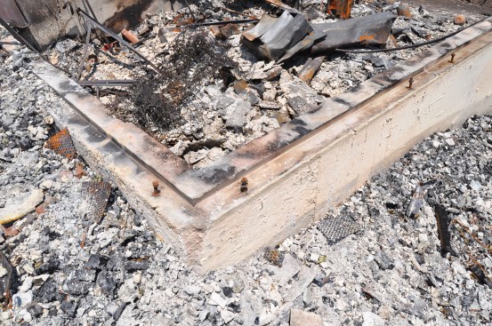

Visual assessment. I look for patterns of scorch marks, heat exposure, cracks, changes in color, and surface spalls. I also look for leaning or tilting of the walls, which may not be due to heat damage but to the loss of diaphragm support after a structure has been consumed by a fire.
Typically, normal concrete is not significantly altered or damaged below a temperature of 500°F; however, rapid heating of the concrete can cause pore water to boil rapidly, which can cause surface spalls. These can also result from sudden cooling and contraction after being sprayed by a firefighter’s hose. Spalled areas should be carefully examined to determine whether they are a sign of widespread heat damage or an isolated occurrence that could be addressed with a targeted repair patch.

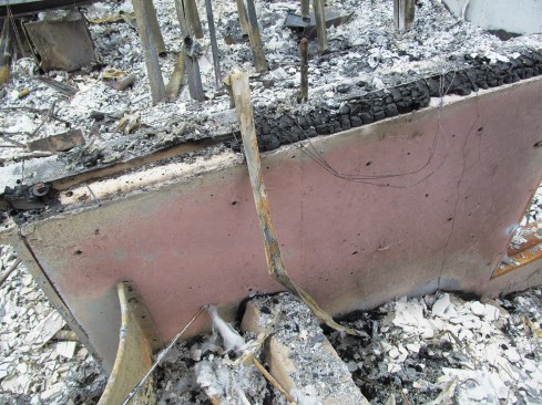

The color of the concrete paste should also be reviewed since a color change may indicate exposure to temperatures greater than 550°F. Concrete exposed to temperatures greater than approximately 570°F often turns a shade of pink, associated with chemical changes of the iron-containing compounds in the aggregates and paste matrix. At much higher temperatures—which are not commonly encountered during typical structure fires—the concrete can turn back to a light gray and then eventually to a yellowish-brown color. Concrete that has turned pink is damaged and should be replaced. Smoke stains and scorch marks can point to areas that were exposed to high heat when compared with areas exposed to less heat, indicating the need for further evaluation.
Concrete exposed to intense heat often has a pink hue, a strong indicator that it is severely damaged and shouldn’t be reused for reconstruction.

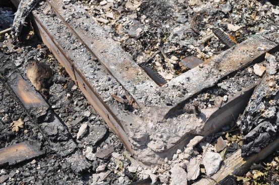

A quick way to convince a homeowner who may want to reuse their heat-damaged foundation to choose otherwise is to show them a photograph or two illustrating how easily a few hits with a hammer can dislodge concrete and expose rebar.
A few strikes with a framing hammer on the corner of this heat-damaged foundation…
…were enough to fracture the concrete and expose rebar.
