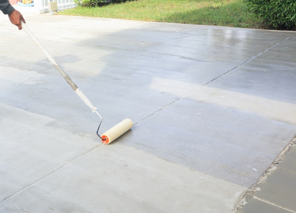

If you do decide to seal the cracks, the best solution for the narrow ones you describe is to seal the entire slab. Make sure the surface is very clean, then apply a good solvent-based acrylic sealer with a pump sprayer. Don’t put it on too thickly, though — it’s best to apply it in two thinner coats — and don’t apply it if the temperature is less than 50°F or greater than 90°F.
For a broom-finish surface texture, work the sealer into the surface with a roller. (Sealers come in both glossy and matte finishes.) Add some grit — a product such as H&C’s SharkGrip (www.hcconcrete.com) should work — to the mix if the surface seems too slippery.
