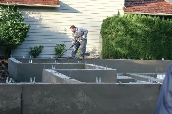

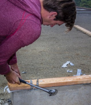

For a number of years, we used Simpson Strong-Tie MASAP mudsill anchors, which qualify as an approved substitution for anchor bolts with 3-inch-square plate washers. These seemed like a good alternative to having to adjust the layout for joists that landed on bolts. They attached easily to panelized concrete forms, and we didn’t have to worry about the joist layout. The MASAP is located at the edge of the foundation wall and wraps over the edge of the mudsill. This placement has the advantage that we could set the mudsill right on our snapped layout lines—a welcome change from aligning anchor bolts, which takes time to do accurately. Allowable holes for the anchor bolts in mudsill can’t be oversized more than 1/16 inch, and so we often would end up having to move the mudsill slightly to accommodate the anchor bolts, and the mudsill would end up off the line.
With MASAP straps, we used a Hilti powder-actuated tool to secure the mudsill to the concrete on our chalk lines. This held it in place until we nailed off the straps. We used MASAP straps for nearly 10 years, nailing them off either with a positive placement gun or by hand-nailing. Frankly, this was tedious, and we needed to pin the plates in place with the Hilti to keep them from moving around when we nailed off the anchors. Another disadvantage is that the MASAPs created a gap between the mudsill and the rim joist that bears on top of it. All things considered, we ultimately went back to the anchor bolts, feeling they were cleaner and simpler to use.

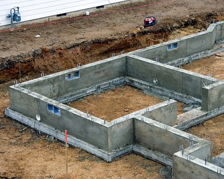

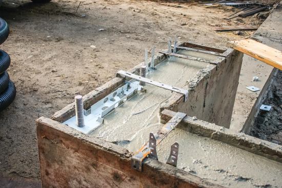

We sometimes sub out our foundation work, but typically we form and pour foundations ourselves. I lay out the location of the bolts prior to placing concrete, and my focus is to eliminate any framing landing on bolts or plate washers. Much of our framing is 24 inches on-center, so the bolt placement is 48 inches on-center and lands between joists or studs. I use Simpson Strong-Tie’s AnchorMates to hold the bolts in place. These bolt holders are made of nylon plastic and hold up well over time so they more than pay for themselves. (We have been using the same set for the last two years.) Though not required, the bright blue holders also give the inspector something to see, and overall they make for one less thing for us to deal with during the pour.

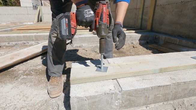

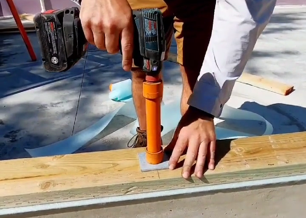

Working in a D2 seismic zone, the author is required to use 3-inch-square plate washers on anchor bolts. To save time, he tightens the nuts with an impact ratchet, being careful not to overdrive the nuts, as that can crack the concrete around the bolt. The rule is to seat the nut, then tighten it one half-turn.

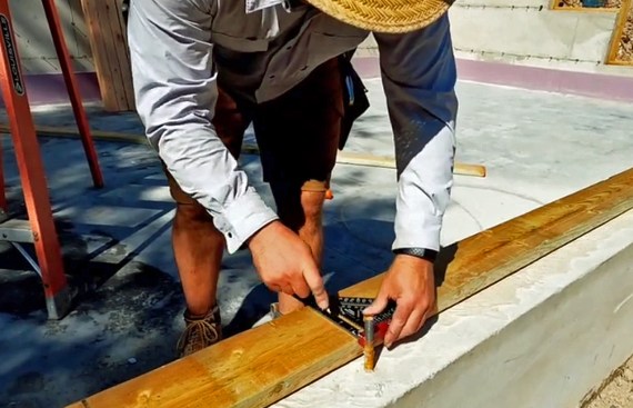

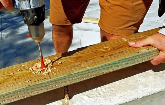

To align the mudsill with our chalk lines, we place the sill board next to the anchor bolts, center a square with the bolt, and mark a line across the board. The bolts are not always perfectly vertical, so you have to eyeball the base of the bolt. When the locations are marked, we slide the board back to the chalk line and measure the distance from the base of the bolt to the edge of the board. We then mark this distance on the board and drill our holes. The largest hole we can drill for a 5/8-inch-diameter bolt is 11/16 inch.

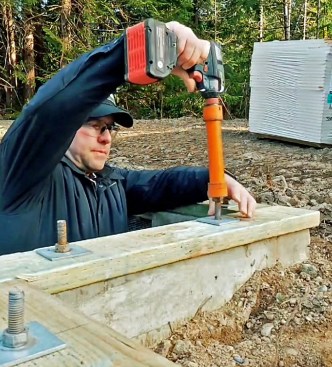

A few of us framers on Instagram have been talking about ditching anchor bolts completely and drilling them in after the concrete is poured. There are a few options available that work for this in our seismic zone: Simpson’s Strong-Bolt 2 wedge anchors (or similar from other manufacturers) and Titen HD screw anchors are two that we’ve used. Both are allowed as alternatives to cast-in-place anchor bolts, but there are some caveats.
The idea of drilling after the fact might seem on its face a slower method, but there some definite advantages:
  • Drilling after the fact means we never have to move a framing member or notch it. Many foundation subs don’t think about the framing; they just set bolts to the spacing called out on the plans. This means that when we sub out our foundation, we sometimes end up cutting anchor bolts off and drilling for Titens anyway.
Kyle Davis of Pioneer Builders tightens down a Titen HD screw anchor.
  • We don’t have to even think about laying out bolt locations while forming the foundation.
  • Mudsill can be set perfectly on the line and no holes will be oversized since the size of the hole for the anchor is exactly the same size as the anchor.

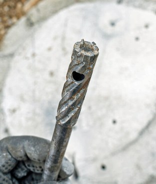

Drill-in anchors depend on your being able to predrill through concrete and rebar. One option is a small core drill. Going this route, you have to start out with a regular carbide bit for concrete, and as soon as you hit rebar, switch to a core bit like the one pictured here ... and then switch back to the concrete bit as soon as you are are clear of the rebar. It's slow going, to state the obvious.

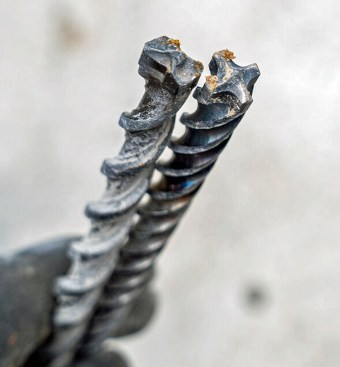

Left: A standard 2-point carbide rotary-hammer bit for drilling concrete only. Right: A 4-point carbide Diablo Rebar Demon, which drills through both the concrete and the rebar. What typically kills a standard bit when up against rebar is the heat generated from hammering on the steel. The Diablo got plenty hot during use; you can see that the shank of this Diablo has turned blue. But it could take it and continued to cut through concrete and steel.
