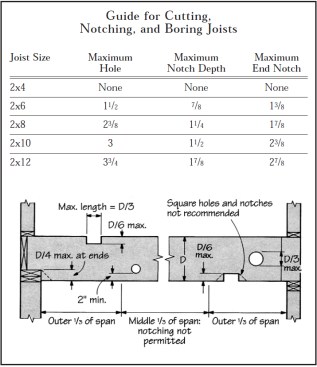

In dimensional lumber joists, never cut holes closer than 2 inches to joist edges, nor make them  larger than 1/3 the depth of the joist. Also, don’t make notches in the middle third of a  span where the bending forces are greatest. They should also not be deeper than 1/6 the  depth of the joist, or 1/4 the depth if the notch is at the end of the joist. Limit the length  of notches to 1/3 of the joist’s depth. Use actual, not nominal, dimensions.Note: Since this article was first published, engineered wood I-joists have largely taken over as the predominate floor framing material. The notching requirements vary greatly for wood I-joists. Consult the manufacture literature for the specific engineered wood system you are using, as the requirements vary even by manufacturer.
Holes and Notches
Whenever you cut a hole or notch in a joist, that joist is weakened. You (and your subs) should avoid this whenever possible. And when you absolutely have to cut or notch, you should know the rules for doing it in the least destructive manner.
The above table shows proper guidelines for cutting holes and notches. Straying from these guidelines weakens the joists and risks a red tag from the building official. Trying to fix such problems can be very costly, since it usually involves redoing the plumbing and electrical work along with replacing or doubling the joists.
Ripping long notches in floor joists, such as to make room for grouted entry  floors, weakens the joists unacceptably and violates all codes. Instead, you need to use  smaller dimension milled lumber of a higher grade or set closer together. If necessary,  you can fur at the ends to bring non-grouted areas up to level.
When Notch Becomes Rip
Occasionally, what might be thought of as a notch turns into a rip, such as when floor joists at the entry of a home are ripped down to allow underlayment for a tile floor. Unfortunately, ripping wide dimension lumber lowers the grade of the material, and is unacceptable under all building codes. You should frame these areas with narrow joists of a higher grade or stronger species, making sure they can carry the load.

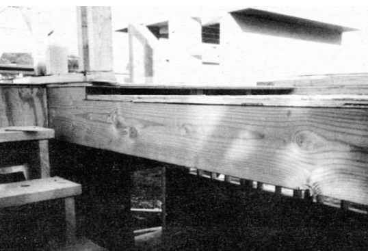

Bearing Walls on Cantilevers
How far can a conventionally framed cantilever extend and still support a bearing wall?
Most of the confusion about how far a cantilever can extend beyond its support stems from an old rule of thumb used by builders and code officials alike: the rule of “one-tothree.” This states that a joist should extend back inside the building at least three times the length of the cantilevered section — if the cantilevered section hangs 2 feet out, the joists should extend at least 6 feet in.
This rule works fine for nonbearing situations. But it does not apply to a cantilever that supports a bearing wall. In this situation, the maximum distance that joists can be cantilevered without engineering them is a distance equal to the depth of the joists. So if you are using 2×10 floor joists, the maximum cantilever for those joists supporting a bearing wall is 91/4 inches. Beyond this distance, shear becomes a serious factor, as does the bending moment at the support. This combination could eventually cause splitting of the cantilevered joists. The only way to work around this problem is to have it engineered.

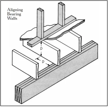

Misaligned bearing walls. In other instances, loads carried by bearing walls or posts must be transferred through floor systems. If the bearing wall or post above doesn’t line up closely enough with a bearing wall, post, or beam below, the floor joists in between can be overstressed, causing severe deflection. This can eventually split the joists, as well as cause finish cracking problems.
How closely must they align? Bearing walls supported by floor joists must be within the depth of the joist from their bearing support below (just as with cantilevers).
This code requirement applies only to solid sawn wood joists. Engineered products such as wood Ibeams are required to have the loads line up directly over each other, and special blocking is required. Special engineering of either dimensional or engineered lumber may allow placing loads at other locations, but you shouldn’t try it without consulting an engineer first.

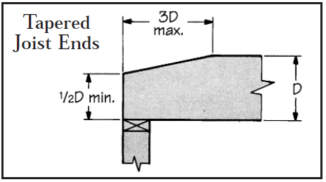

Tapering Beams and Joists
It’s sometimes necessary (or at least convenient) to taper the ends of ceiling joists or beams to keep them under the plane of the roof. But by reducing the depth of the joist or beam, you reduce its load-carrying capacity.
If you must taper-cut the ends of ceiling joists, make sure the length of the taper cut does not exceed three times the depth of the member, and that the end of the joist or beam is at least one-half the member’s original depth.
With taper-cut beams, you should also check the shear rating. If you can’t meet this criteria, you’ll probably have to lower the beam into a pocket so that enough cross-section can be left, after taper-cutting, to carry the applied load.

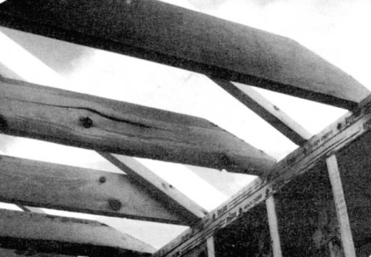

Rafter Cuts
Another area that inspires excessive cutting is the level cut of the seat of a rafter. Many times, especially on low slope rafters, this level cut becomes a long taper cut on the tension (lower) side of the rafter. If the bearing point on the rafter is at the heel (interior side) of the cut, there is no problem. But usually these long cuts put the bearing point near the toe. This reduces the effective size of the rafter, producing stresses that can create splits at the bearing point, and eventually a sagging rafter.
To prevent this, cut your rafters so that the heel rests on the plate. This will mean using a slightly longer rafter. It will also give you a few extra inches between the top of the exterior wall and the roof sheathing. This translates into more room for attic insulation to extend over your outside wall, reducing those cold spots that can cause condensation or ice-dam problems at the eaves.

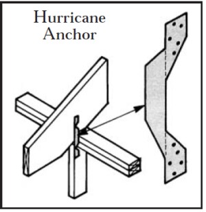

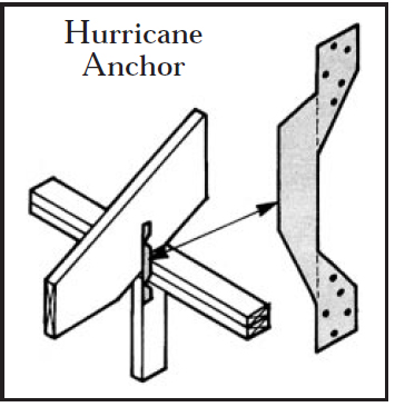

Connecting Rafter to Wall
Conventional construction leaves too little connection between rafters and walls. Nails connect rafter to plate and plate to stud, but do nothing to connect the rafters to the wall itself. Such structures are subject to damage from the high, near-hurricane force winds that sooner or later blow across virtually every roof.
As a result, the building codes are beginning to get more restrictive about how rafters and trusses are tied to the rest of the building. For example, the 1991 Uniform Building Code has added Appendix Chapter 25, which applies to high wind areas. Under its requirements, rafters or trusses must be tied not just to the top plate, but to the studs below at 4- foot intervals. This means using some kind of metal connector to provide a positive tie to the studs.
The answer is the hurricane anchor (see Figure 10). You don’t need to face a hurricane to need it — winds of roof-damaging gale force blow in most parts of the country. If you build in an area subject to high winds (or seismic conditions), you should consider using these or other holddowns
