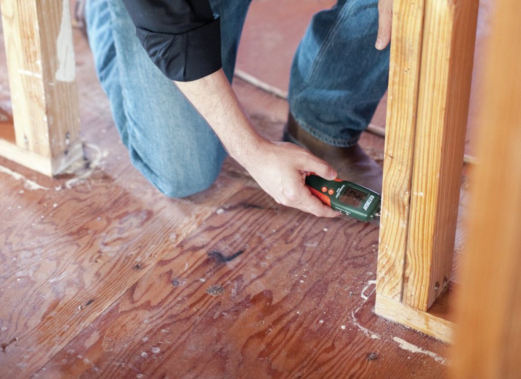

Shrinkage
Kiln-dried lumber is stamped K-D (kiln-dried) or S-Dry (surface dry), and is shipped with a moisture content of about 19%. Anything larger than a 6x6 is generally not available K-D.
In a completed building, framing eventually dries to an average of 6% to 11% moisture content, depending on climate. This drying causes the lumber to shrink across the grain; shrinkage along the grain is negligible. The table below shows the degree of shrinkage in flat-sawn framing lumber.

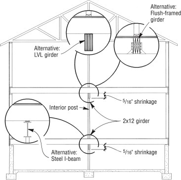

Shrinkage in large carrying beams can cause one part of a house to settle more than others, causing drywall cracks and other problems (below).
Figure: Avoiding Cumulative Shrinkage
The two 2x12 girders in this building will shrink enough to cause a 1/2-in. drop in the second-floor level — enough to cause nail pops and cracks in the finishes. Use steel, engineered lumber, or flush framing to eliminate the problem.
However, using flush beams with hangers, or engineered lumber or steel, can reduce the potential for shrinkage problems. If dimensional lumber is hung flush from a beam made of steel or engineered lumber, the result can be a bulge at the beam (below).

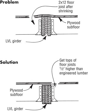

Flush-Framed Floor Joists
When installing dimensional-lumber floor joists flush with the top of engineered or steel beams, install the joists 1/2 in. higher than the girder to accommodate shrinkage.

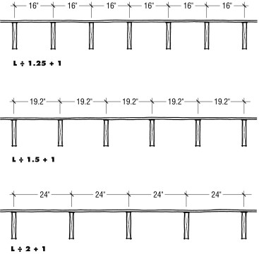

Estimating Floor and Ceiling Framing
To calculate the number of joists, use the formulas shown in the figure below for the appropriate on-center spacing.
Figure: Estimating Joists and Rafters
To calculate the number of joists needed: 1) Measure the width of the room (ft.);2) divide by the appropriate o.c. spacing (ft.); &nbsp;3) add one to start.
