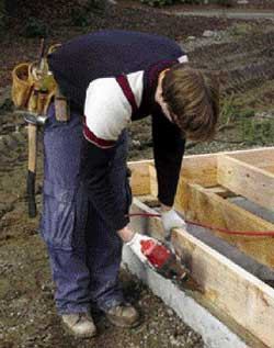

Recently, JLC asked me to try out Max’s new PowerLite framing system. The timing was excellent because our company’s four-man crew was scheduled to frame 15 to 20 custom homes this year. That’s twice what we normally build, so we were looking for ways to increase production.
The system we tested included a PowerLite framer HN90 coil gun, a 100-foot PowerLite hose, and an AKHL 1050E PowerLite compressor. Most framing guns operate at 100 psi and run off compressors that produce 120 to 150 psi. The HN90 operates between 170 and 330 psi and is connected to a 400-psi compressor.
The added pressure allowed Max (Max USA Corp., Mineola, N.Y.; 800/223-4293, www.maxusacorp.com) to decrease the size and weight of the gun without decreasing nailing power. High-pressure systems are new to the U.S. market, but, according to the manufacturer, they have been used in Japan for a decade.

When we got this gun, we dropped in a coil of 10d nails and started using it to frame walls. The first thing I noticed was that there was almost no recoil. It felt like using a finish gun. The HN90 has more power than any nailer I’ve ever used. We used it to nail LVLs together, and it always drove the nails home. The first time I used it to nail off subfloor, it blasted the 8d ring nails right through the sheathing. I backed off the depth of drive, but it still set the nails a little too deep. We played around with the pressure setting and the depth of drive and decided that 275 psi was a good compromise for framing and shear nailing. If it was really cold outside and the lumber was frozen, we’d crank it up another 10 psi.
