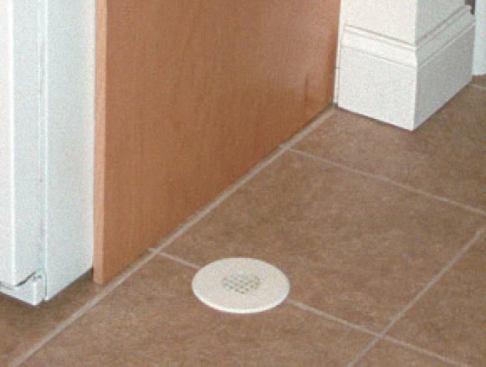

The most obvious difference between a high-velocity system and a conventional forced-air system concerns their basic operating cycles. In a conventional system, the air handler and boiler or condenser cycles on and off as the thermostat signals for heating or cooling, depending on the season. In a high-velocity system, on the other hand, the heating and cooling equipment cycles on and off as needed, but the air handler runs continuously to maintain pressure within the ductwork. This pressurized air is delivered through inconspicuous room outlets at speeds high enough to create a slipstream effect that keeps the room air thoroughly mixed. This eliminates the stratification, or hot and cold spots, that can develop between operating cycles in a conventional forced-air system. The air temperature maintained by high-velocity conditioning varies by only about 1°F between the floor and ceiling of the average home. The constantly running blower is said to use about the same amount of energy as a 100-watt light bulb.

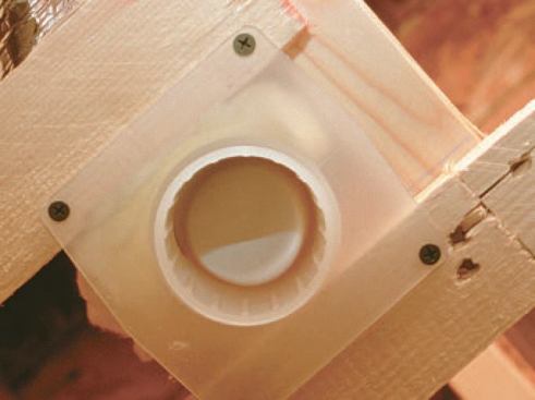

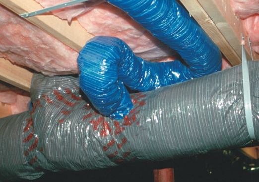

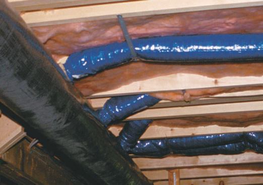

Simple installation. High-velocity systems are also remarkably easy to install. Most of that ease comes from the simple ductwork; insulated, flexible ducts branch off a uniformly sized plenum, or main trunk. The branch ducts are small enough to fit within conventional framing tolerances, eliminating the need for most framing modifications. The plenum may be installed in the basement, crawlspace, or attic and usually consists of a single-diameter run. Because velocity is developed at the outlets, bends and elbows in the ductwork have relatively little effect on the airflow — a key difference from conventional forced-air systems, in which every elbow must be factored in and deducted from the total allowable run.
