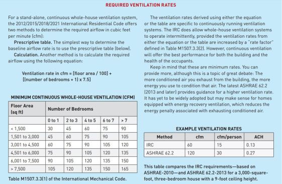

Ventilation rate. Currently, the IRC requires at least 1 cfm of fresh air for each 100 square feet of conditioned floor area, plus 7.5 cfm per person (see “Required Ventilation Rates,” opposite page). For a 3,000-square-foot house with three bedrooms and a 9-foot ceiling height, this would be 0.13 ACH50. This is good general guidance but isn’t always effective for all the various conditions found in specific buildings. Without accurate measurements in any given building, this can be both wasteful and insufficient. This is why I recommend including an air-quality measurement device in any HVAC system design.
The simplest way to remove contaminants such as CO₂, VOCs, and particulates from a home is to remove the bad air and replace it with better air. However, there is no practical way to completely remove and replace the conditioned air within a building all at once. Bringing in fresh outdoor air introduces measured amounts of air and mixes it with existing stale air. To what degree we want to dilute the indoor air is based upon how many cubic feet per minute of new air we can bring in and our ability to remove that same volume from the building. The farther the input air opening is from the removal opening, the better the dilution.

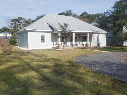

Shown here is an example of a house that I built in 2020 that addresses these issues using some of the techniques and technologies that I have found effective in my hot, humid climate. Located in Southport, N.C., it is a single-story home built with Superior Walls concrete panels, with 2,260 square feet of habitable space, and rated for winds up to a low Category 5 hurricane. In a blower door test, it measured less than 1 ACH50, which included the conditioned attic space along with the habitable space.
Built with concrete panels, this wind-resistant North Carolina house measured less than 1 air change per hour in blower door testing.

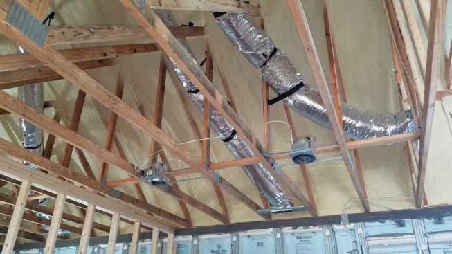

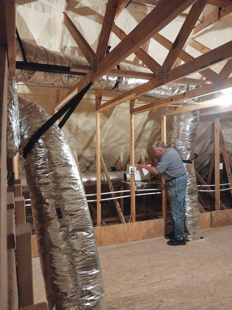

Before the ductwork was installed or any other trades went in, the spray-foam subs started with a completely empty building shell. All that stood were the exterior walls and the roof system, which resulted in a uniform foam application with no overspray on the ductwork. Along the top of the walls, we used a gray mastic to seal the double top plates to the concrete panels. The foam insulation, concrete walls, and mastic are the keys to achieving blower door test results that are less than 1 ACH50.
To bring the attic and HVAC system within the home’s conditioned space, the author specced closed-cell foam insulation to be sprayed on the underside of the roof system.

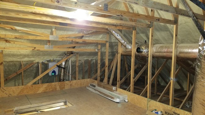

We always include the crawlspace and attic within the air-sealed building envelope. This allows us to locate various components such as HVAC equipment and ducting in these conditioned spaces for better efficiency. Also, when makeup air is introduced into the building, these spaces can be helpful in blending and conditioning outside air prior to it being introduced into the living spaces. Conditioned air is also ducted into these spaces, as shown in these photos.
An additional benefit is that the owner gains a great deal of safe storage space. You may notice the OSB curbing around the perimeter of the walkable areas to prevent stored objects from falling onto the ceiling below.

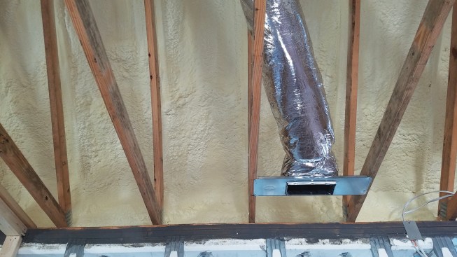

Here the ductwork has been installed, and the electrical has been roughed in.
The supply duct in the attic allows new air to be mixed with conditioned attic air before being drawn into the living space. The OSB around the perimeter of the walkable attic area prevents stored items from falling onto the ceiling below.

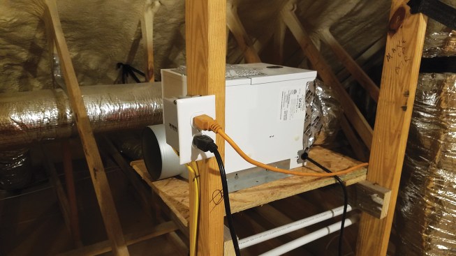

To provide a metered supply of fresh outside air for overall air quality in the house, I installed a QFAMD makeup air unit, made by Air King, which brings outside air directly into the attic buffer space through a 6-inch-diameter flex line from a grille in the front porch ceiling. The unit has a replaceable filter, but it seldom gets dirty. The new air is mixed with attic-space air so it can be conditioned before entering the living space. Power usage is only 26 watts.
This unit allows me to select how many cfm I want, up to 130 cfm. It also allows me to select temperature range and humidity range. We want to avoid bringing in 95°F, heavily saturated air.
This new air is mixed with the already conditioned air before being brought into the living spaces. Reducing the cfm to 60 to 100 puts it well within a range that a 1 ACH50 house can handle using moderate exfiltration. Also if possible, I prefer to have the house slightly positive to reduce air infiltration from other sources. At this low level of air being brought in, I feel that an ERV is unnecessary for this environment.

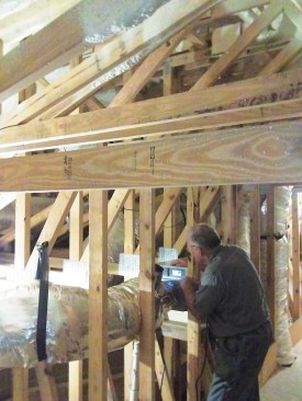

The Air King QFAMD makeup air unit brings outside air directly into the attic buffer space via a 6-inch-diameter flex line from a grille in the front porch ceiling. There is a replaceable filter in the unit, but it seldom gets dirty. Power usage is only 26 watts.

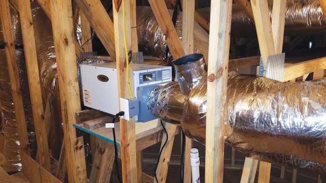

The Aprilaire 70-pint dedicated dehumidifier that we installed can handle homes of up to 2,800 square feet. It has its own filter, but with the return duct being placed high in a 14-foot wall in the common area space, it can go a long time before cleaning. The panel on the front is for setting the desired relative humidity. I always select 45%, as that is supposed to be best for limiting viruses. The unit has a condensation line that goes into the plumbing waste pipe using its own trap. The open duct pipe shown in front of the unit is for drawing in attic air to be dehumidified along with the return air from the living space below.
Also installed in the attic is an Aprilaire E070 dehumidifier, shown here with an open duct that draws in attic air for dehumidification. The unit’s condensation line is connected to the home’s DWV plumbing. At right, the author is shown adjusting the relative humidity setting to his preferred setting of 45%.
Note that the makeup air introduced by the QFAMD unit is part of the air being dehumidified. The Aprilaire and the QFAMD are spaced as far apart as reasonable to provide air volume for the makeup air to be mixed in with the air from the living space. Like the QFAMD, this unit uses only 26 watts maximum, which is the equivalent of two LED light bulbs.

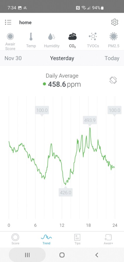

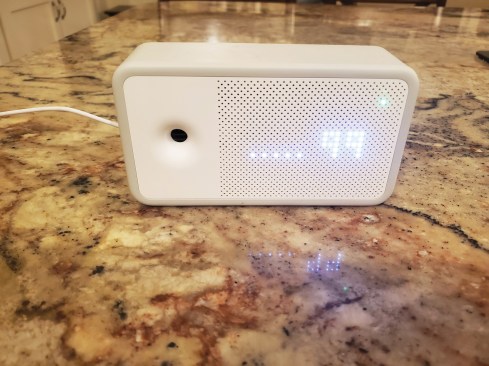

There are many recommendations as to how much fresh air should be brought into a house to provide a healthy environment. Rather than picking makeup air numbers from various sources, I combine mechanical makeup air with a measurement device that monitors the IAQ. The Awair Element air quality monitor maintains a continuous readout that is displayed on the monitor, as well as a Wi-Fi connection to an app on a cellphone. The app gives you a total quality score and specific numbers for each category, along with graphs, historical data, and export capability. Using these scores, we can “tune” the house as needed by raising the cfm setting on the QFAMD makeup air unit. We can also make changes to the dehumidifier setting to maintain the RH percentage. As a builder who is using closed-cell spray foam under all roof decks, I am sensitive to owners’ concerns regarding chemical off-gassing. As such, I include an Awair unit in every home.
To fine-tune the operation of the home’s ventilation system, the author uses an Awair Element indoor air quality monitor, which displays sensor data on the device and can share it wirelessly through the free Awair app.
The Awair app allows the user to track indoor air quality metrics over time.
The unit can track temperature, humidity, CO2 levels, total VOCs, and particulates.
The ability to collect and track this data and manually adjust the volume of air being brought in by the QFAMD allows the home to be fine-tuned to fit the air quality needs of its occupants. One or two people living in the home may not need a lot of makeup air, so the cfm setting could be quite low for daily living. If visiting family members increase the number of occupants, the cfm setting can be increased to accommodate them.
