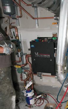

Modulating Boiler

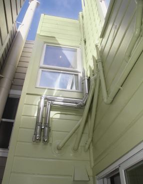

Our designer used ACCA Manual J to calculate the size of the boiler. We selected an 80,000-Btu Munchkin boiler (Heat Transfer Products, 800/323-9651, htproducts.com) with a rated efficiency of 95 percent. The Munchkin is a modulating condensing gas boiler. A condensing boiler is designed so that the water vapor in the combustion gas condenses and releases its latent heat before it reaches the flue. A modulating boiler varies its firing rate based on the temperature of the return water, a highly efficient mode of operation well-suited to zoned systems. When there is only a small demand for heat — if, say, only one zone is calling — the boiler fires at a lower rate. The model we selected can operate at full efficiency between 19,000 and 80,000 Btu.

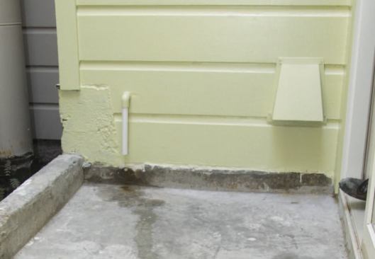

Like other condensing gas appliances, the Munchkin has sealed combustion and uses PVC plumbing pipe for the air intake and flue. Combustion produces an acidic condensate that must be neutralized before discharge, which is done by running it through a cartridge filled with chips of marble.

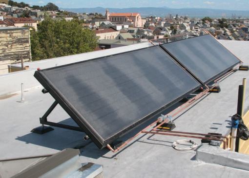

Solar Thermal System
The solar thermal portion of the system is expected to produce 40 percent of the combined heat and hot water demand over the year — approximately 70 percent in the summer and 15 percent in the winter. When the collectors are not producing the required heat — when the sun isn’t out or there’s a high demand for hot water — then the condensing boiler becomes the backup heat source.
The system heats water indirectly by circulating a freeze-resistant fluid, food-grade propylene glycol, through a pair of roof-mounted solar collectors and a heat exchanger coil in the bottom of the storage tank. A set-point control (Tekmar Control Systems, 250/545-7749, tekmarcontrols.com) monitors sensors in both locations. When the collectors are 15°F hotter than the tank, a circulator is activated, circulating the glycol until the temperatures in the collector and tank equalize.
The solar thermal array can heat the water to as high as 180°F in the summer and to almost as high on sunny winter days. To protect sensitive components like valves, gaskets, and air vents, the pump shuts down when the fluid in the collectors is below 55°F or above 180°F.

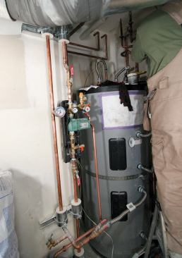

Stored Heat
The storage tank holds 119 gallons of water and contains two heat exchanger coils, which are located to allow for thermal stratification. The coil for the boiler is placed so that it heats the upper half of the tank, or about 60 gallons — enough to supply the combined demand of domestic hot water and space heating. The coil from the solar thermal collectors is at the bottom, so that it can heat the entire tank, giving the solar collectors priority over the boiler. Since solar heat is more or less free, it makes sense to collect and store as much of it as possible when the sun is out.
The boiler fires when the water in the upper half of the tank falls below 120°F and cuts off when the temperature reaches 130°F. To prevent scalding, the domestic hot-water supply passes through a tempering valve that reduces the temperature to 120°F.

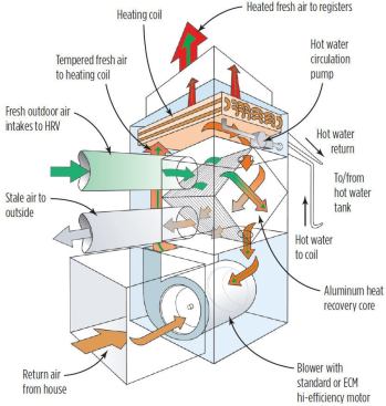

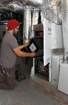

Air Handler

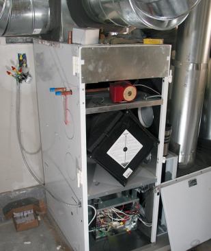

To avoid having to integrate separate ventilation and air handler components — and to save space — we used a Lifebreath Clean Air Furnace (Aria Brands, 937/439-6676, lifebreath.com), a hydronic air handler with a built-in heat recovery ventilator, or HRV. To further improve indoor air quality, we installed an Aprilaire whole-house media cleaner (800/334-6011, aprilaire.com) between the return air plenum and air handler.

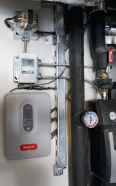

The air handler is an updraft model; it has a pump and heat exchanger at the top, an HRV in the middle, and a blower and control wiring below. When a thermostat calls for heat, it sends a signal to a zone controller, which opens the appropriate zone dampers and activates the pump and blower. The blower is powered by an efficient electronically commutated motor (ECM) that operates at high speed when the heat is on and at low speed when only the HRV is running. At low speed, the ECM uses 80 watts.
The HRV draws in fresh outside air while exhausting stale interior air. The two streams pass through opposite sides of an aluminum heat-exchanger core, which captures about 70 percent of the heat contained in the exhaust and transfers it to the incoming air. In heating mode, the HRV runs in tandem with the air handler and continuously adds outdoor air to the supply mix. Fresh air can also be introduced when the heat is off; when set to ventilation-only mode, the HRV runs for 20 minutes each hour. Ventilation can be controlled separately by a programmed seasonal setting or manually by the homeowner.
Bypass damper. The air handler is designed to produce a constant flow of air in heating mode. Closing off one or two of the zones increases the static pressure in the ductwork and causes the ECM blower motor to work less efficiently. To solve this problem, we installed an automatic bypass damper, which relieves excess pressure by allowing some of the air in the supply plenum to bleed back into the return.
