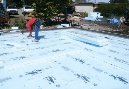

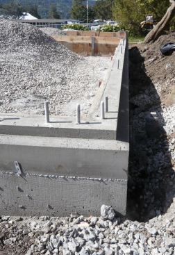

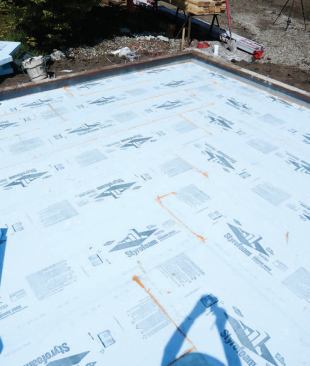

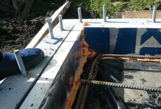

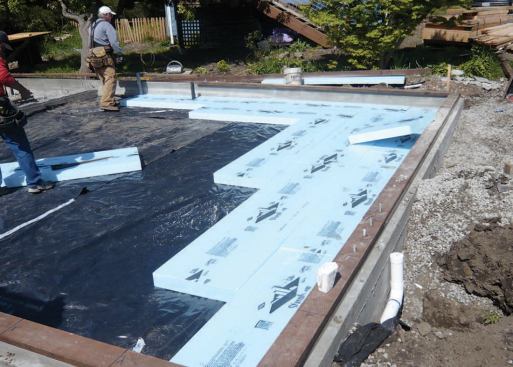

The foundation we used was basically a carefully detailed, better-insulated version of the stem-wall foundations common in our area. After pouring the concrete and stripping the forms, we leveled out and tamped the interior crushed-rock bed and covered it with a layer of 6-mil poly. On top of the poly we laid a bed of 4-inch XPS, leaving a narrow gap between adjacent sheets, which we sealed with a Pageris foam gun and Touch ‘n Seal 32-ounce canisters. We added a layer of 3-inch foam over the first layer, again sealing the joints, to bring the subslab insulation to R-35. We then covered the foam with another layer of 6-mil poly.

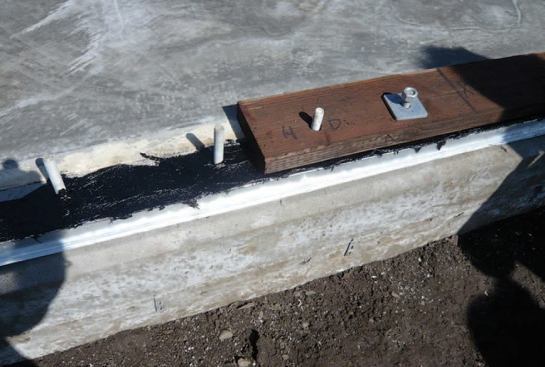

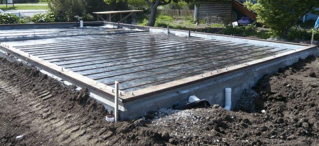

Insulated edges. To prevent a major thermal bypass at the edges of the slab, we cut strips of 2-inch foil-faced polyiso board and applied them to the exposed portion of the stem wall, finishing flush with the top. After placing the rebar grid and pouring and finishing the slab, we bedded the mudsills in a thick layer of asphalt roofing cement. The resulting reinforced slab (which would later be stained and serve as the finish floor) was completely enclosed in foam on all five sides and air-sealed to the framing that followed.
