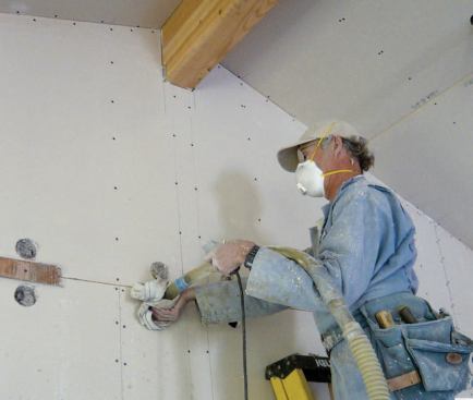

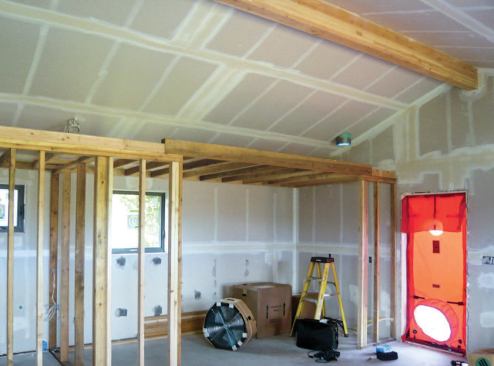

We didn’t frame any of the interior partitions until the exterior walls were fully drywalled, taped and mudded, and insulated. This approach complicated the schedule somewhat but offered two benefits: First, it eliminated difficult-to-seal inside corners where the drywall on the exterior walls was interrupted at a partition. And second, partition walls can now be moved without introducing air leaks. That’s not important in the short term, but when the interior is remodeled somewhere down the road, our method makes it much more likely that the air-sealed interior will maintain its integrity.

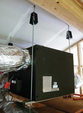

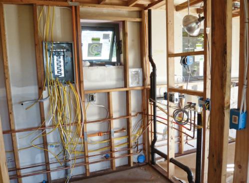

Mechanicals and final blower-door test. We built a drop ceiling over the kitchen and mechanical-room area to provide a space for the ERV and associated ductwork, and furred a 3-inch wall along most of the north side to accommodate the plumbing and electrical for the kitchen, mechanical room, laundry, and bath, and piping for the code-required sprinkler system. All this was completely within the air-sealed shell, making further sealing unnecessary. Our final blower-door test gave us a figure of 0.36 ACH – comfortably within the 0.6 ACH required by the Passive House standard.

When the thermostat calls for added space heating, a small inline pump circulates water from the solar storage tank through an inline heat exchanger mounted in the supply duct of the RecoupAerator ERV (800/535-3448, ultimateair.com). If the storage tanks have been drained of heat by a prolonged cloudy period, an inline resistance heating coil picks up the slack.
Fresh air. To provide consistently high air quality, the ERV runs continuously, recovering up to 80 percent of the heat from the exhaust stream and transferring it to the incoming makeup air. Three ducts pull stale air from the utility room, kitchen, and bath. The normal rate is 12 cfm from the utility room, 56 cfm from the kitchen, and 24 cfm from the bath, but both the kitchen and the bathroom have manually controlled booster switches to bump up ventilation when needed.
